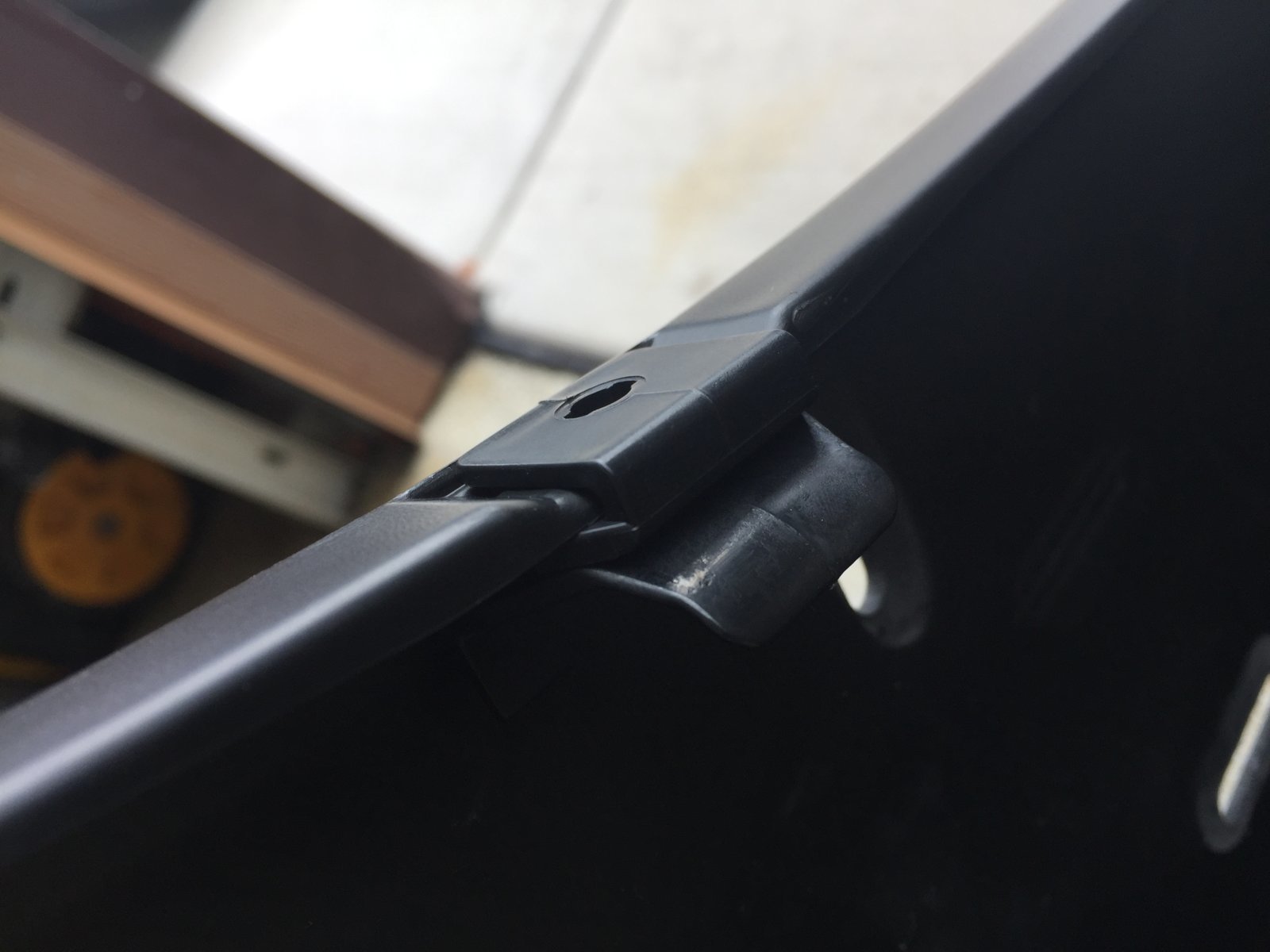

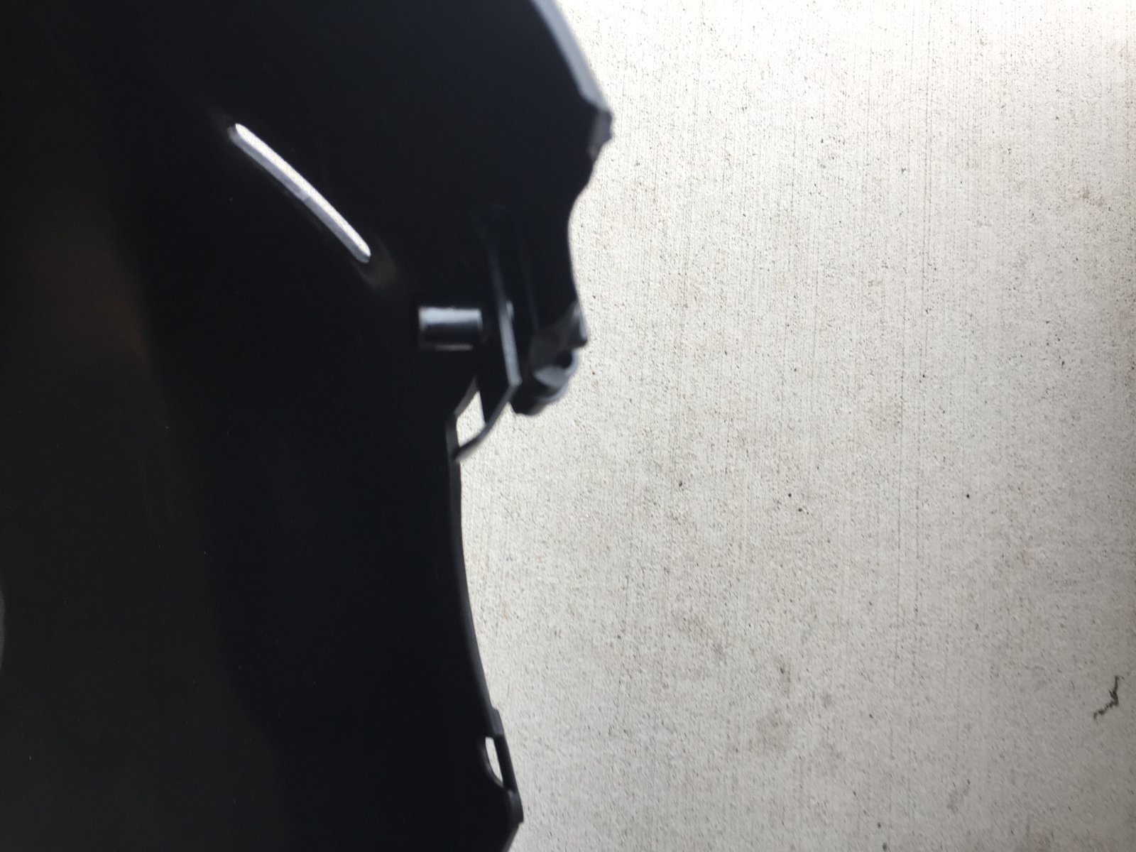

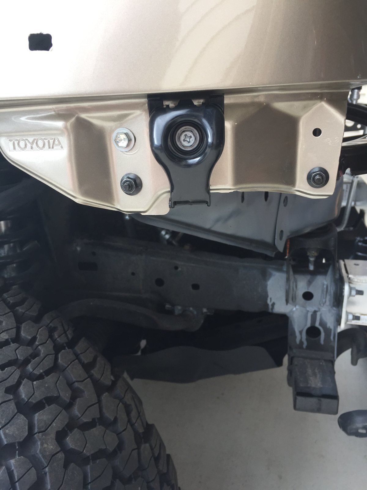

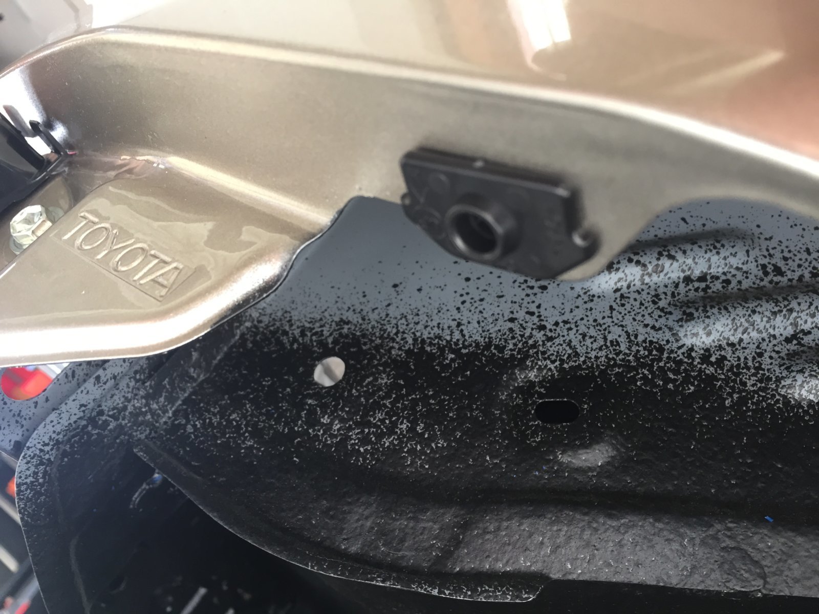

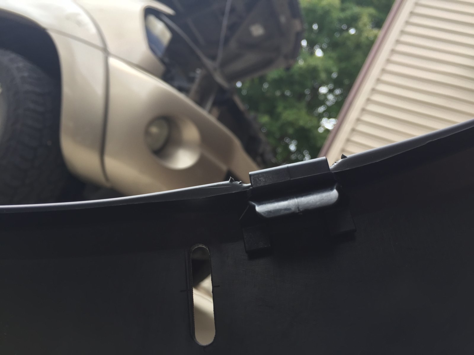

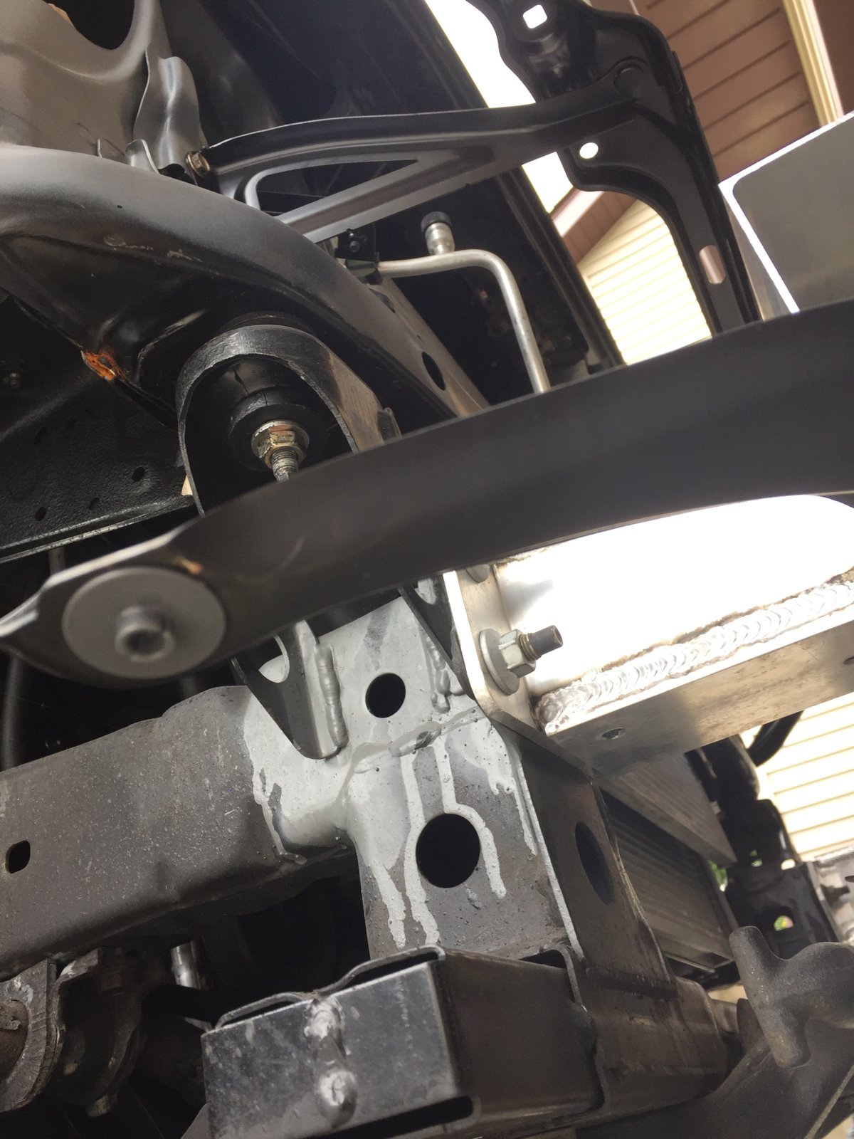

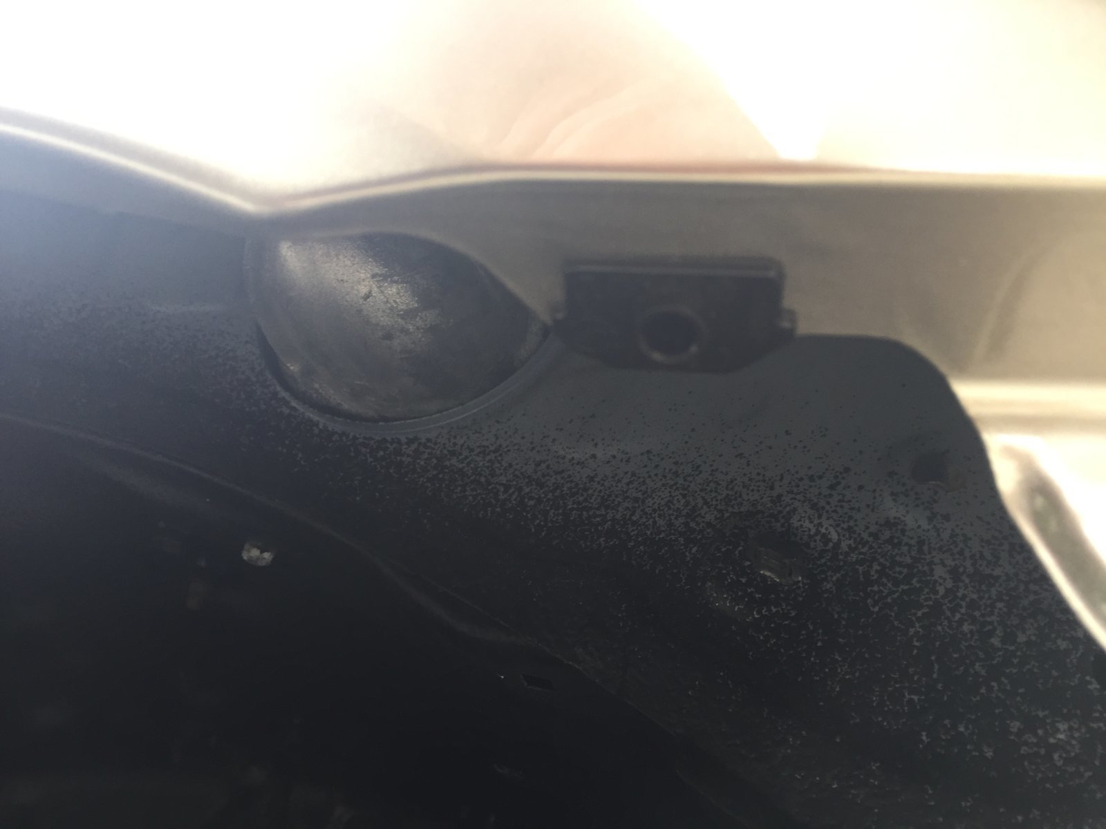

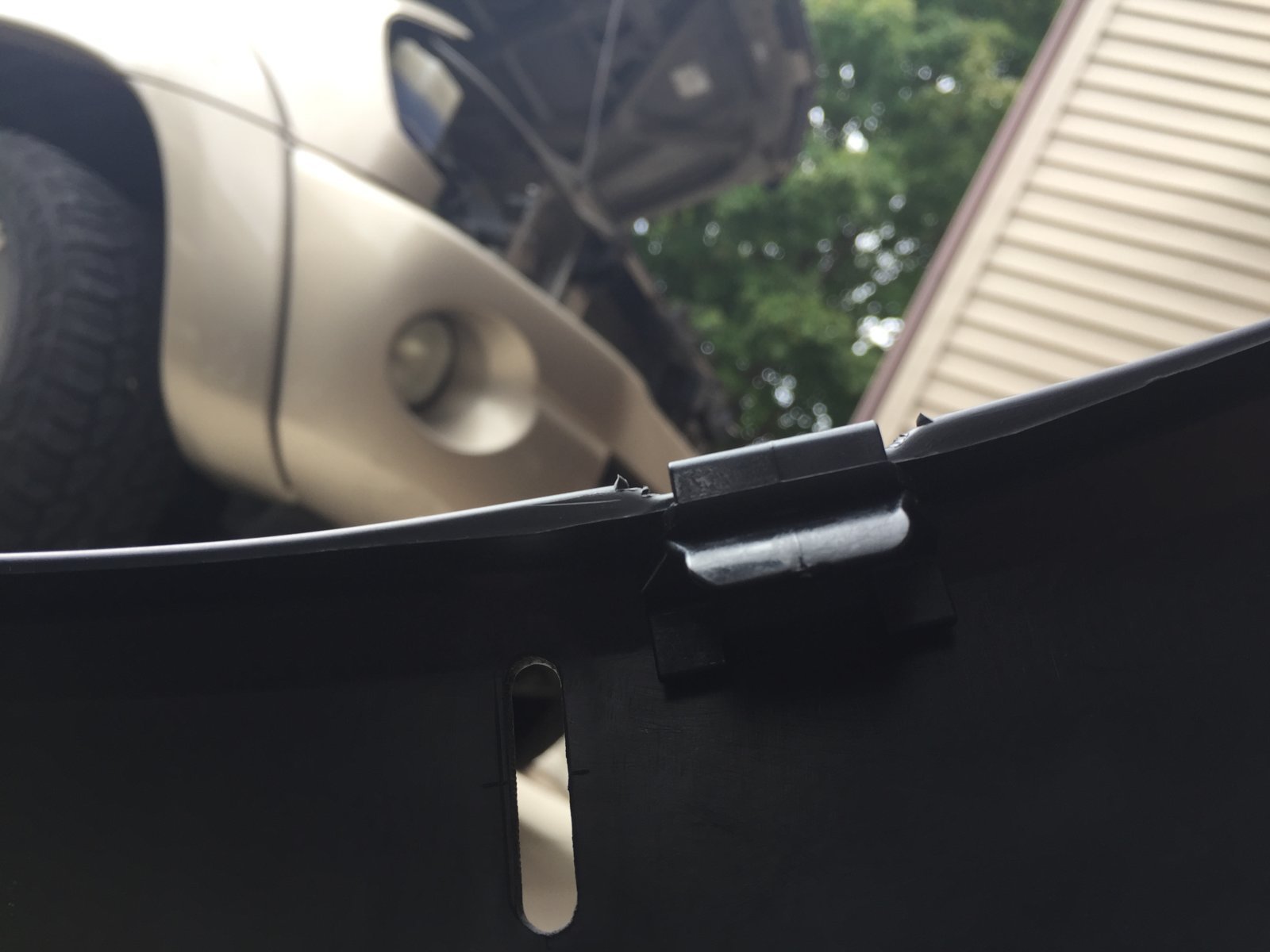

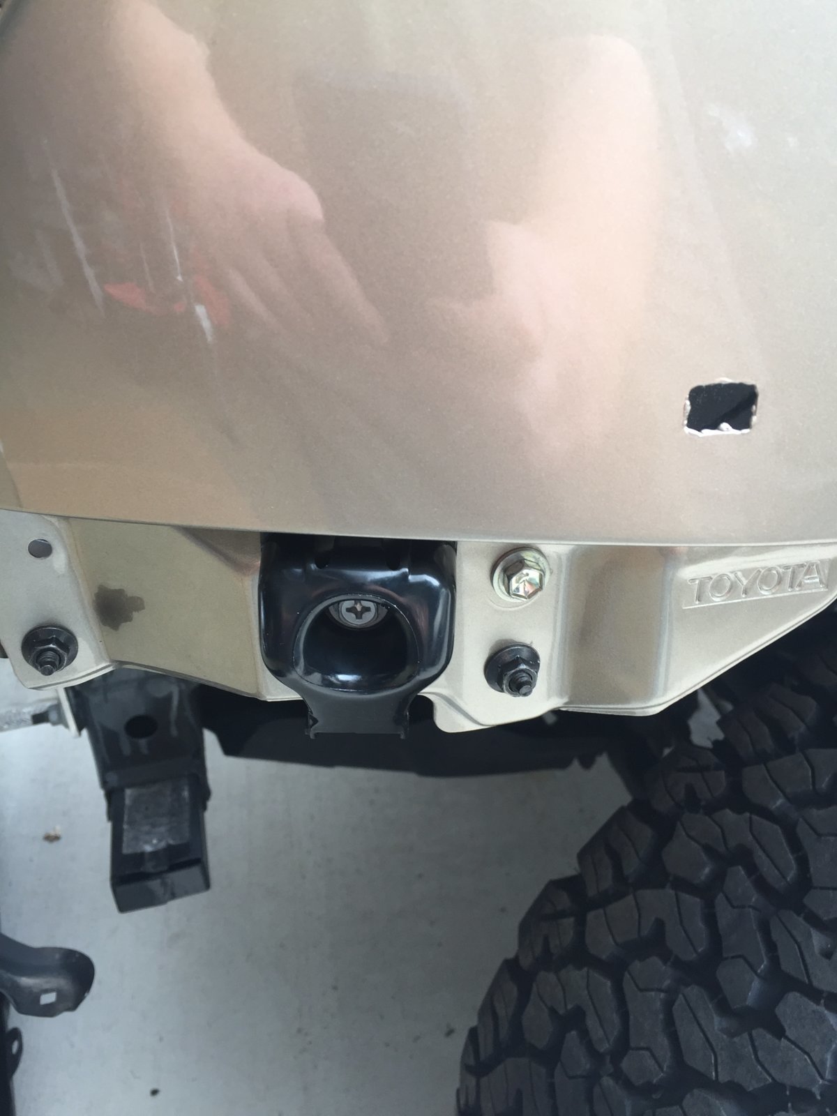

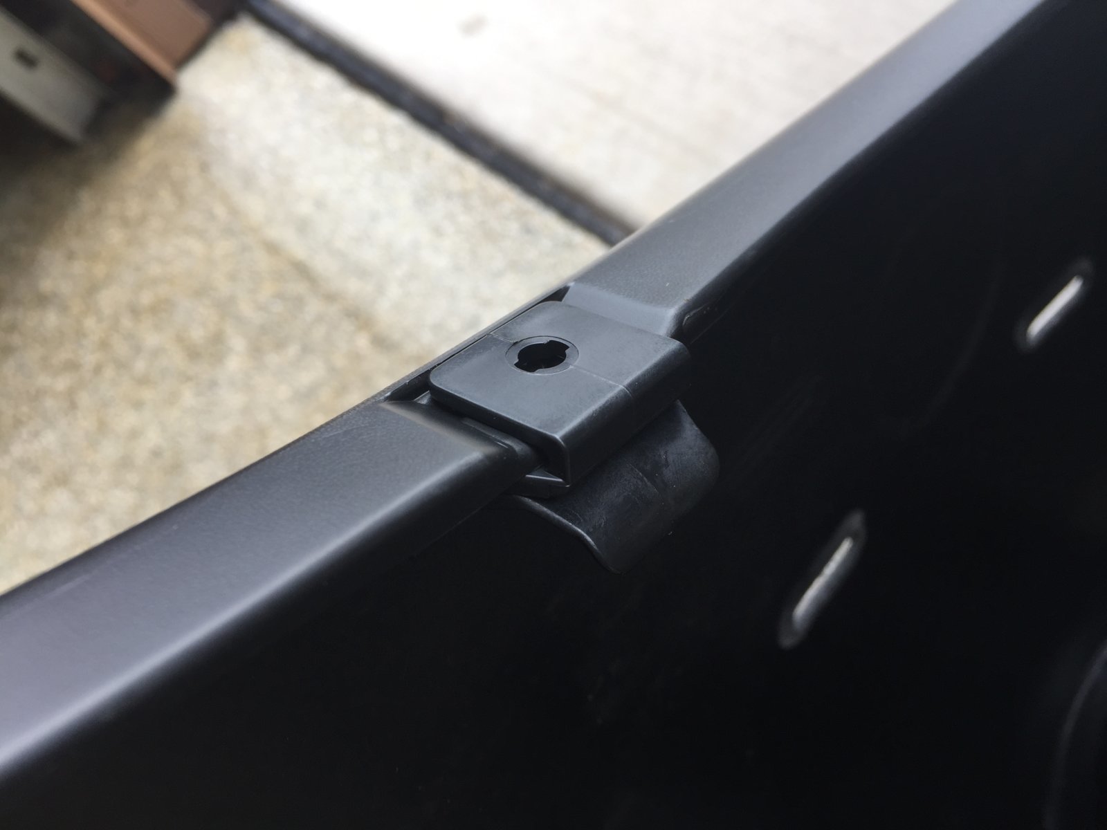

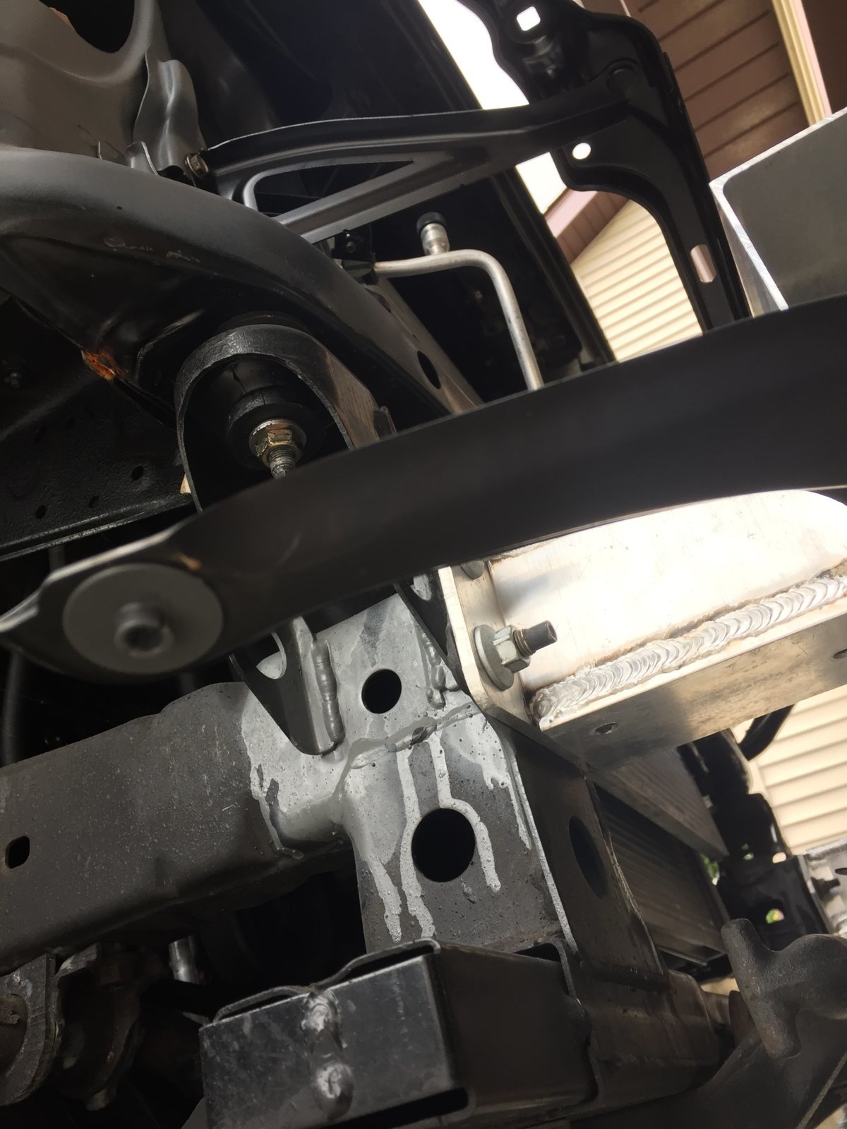

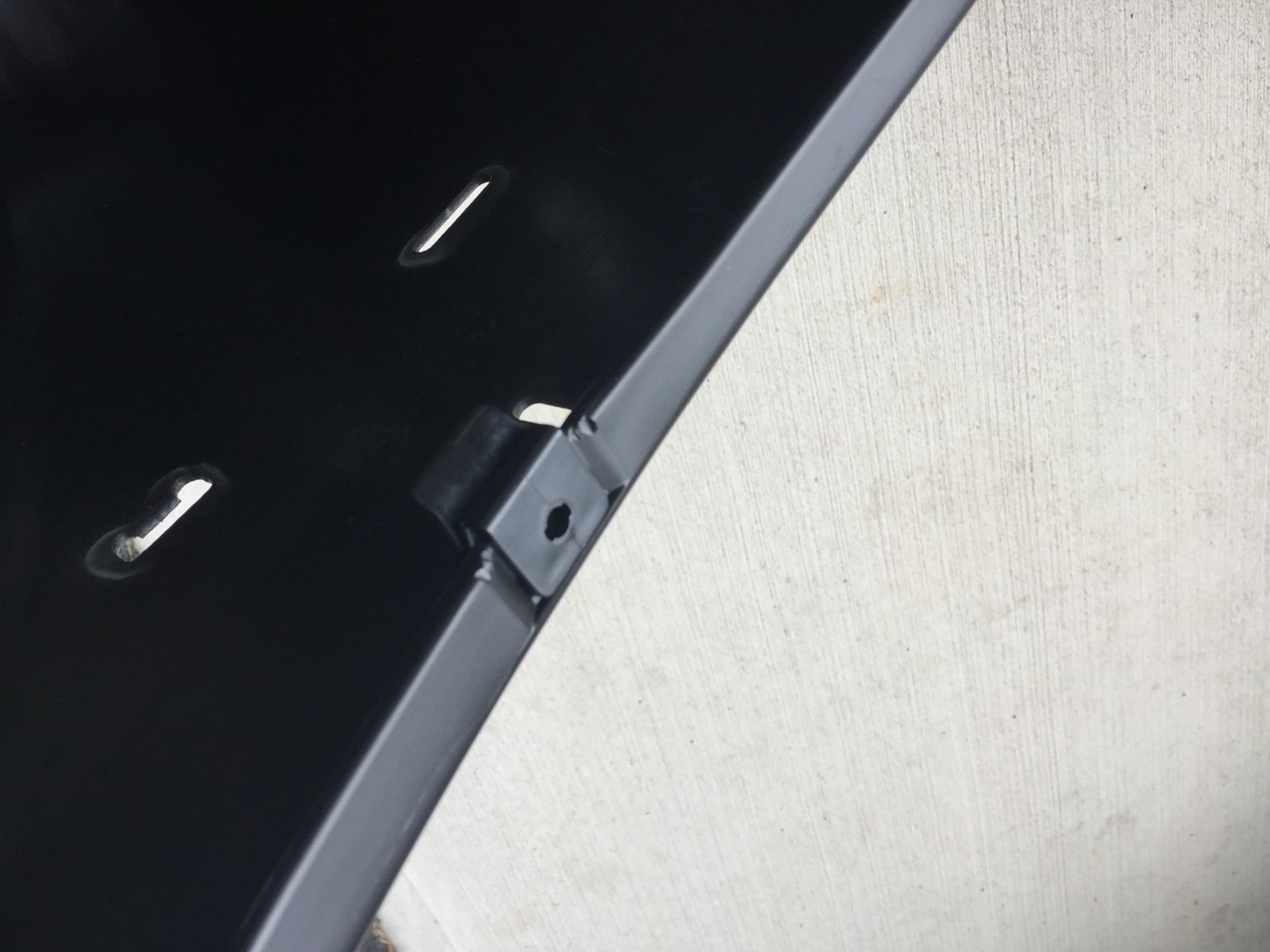

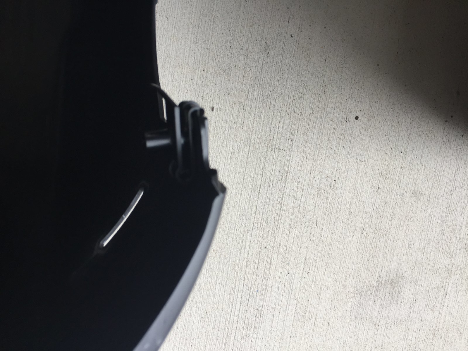

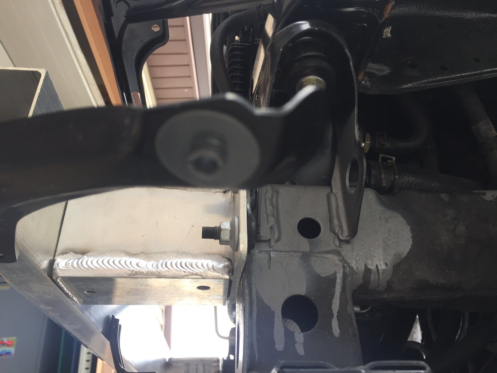

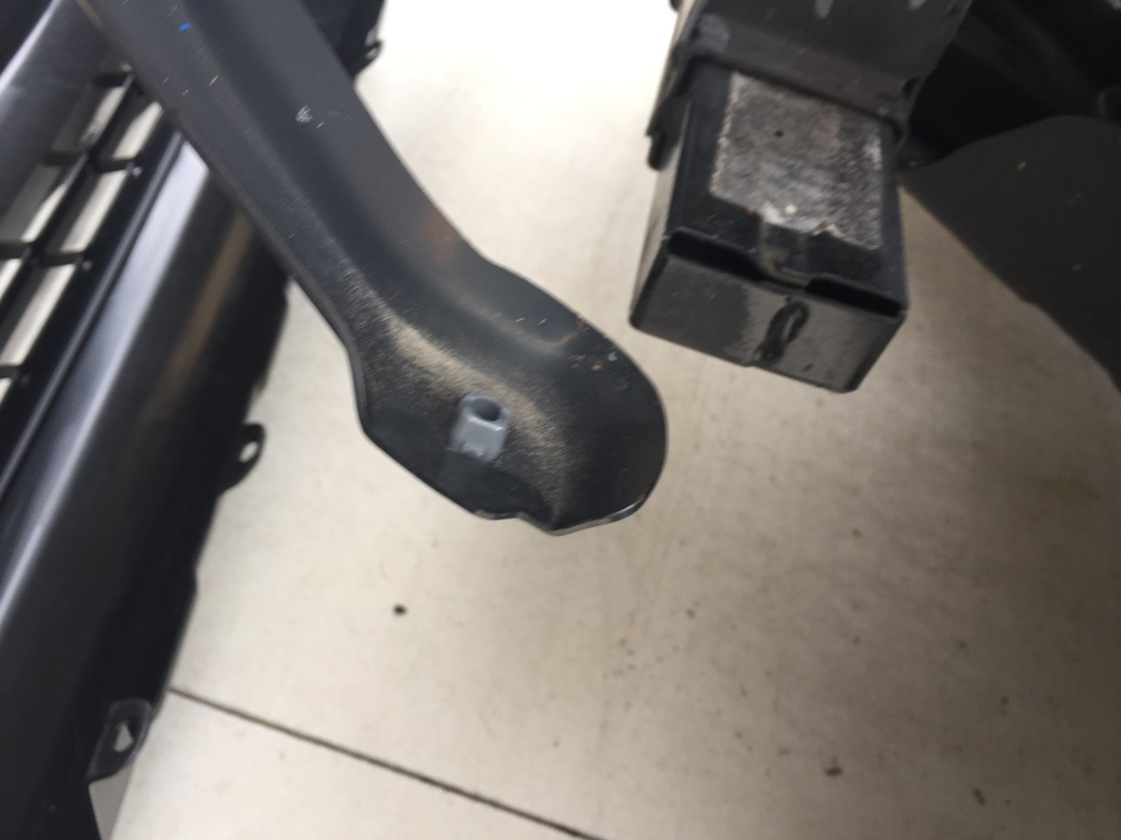

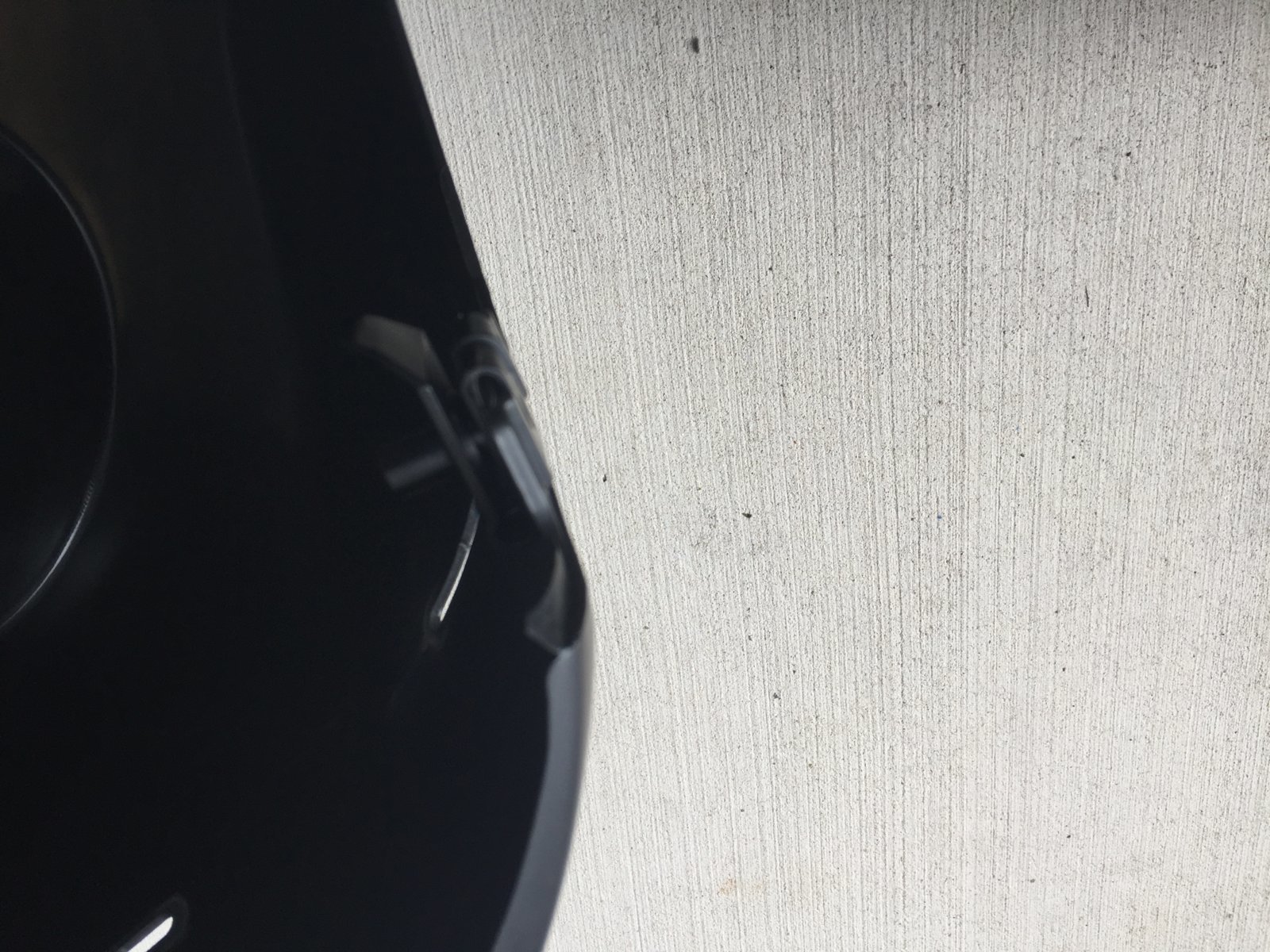

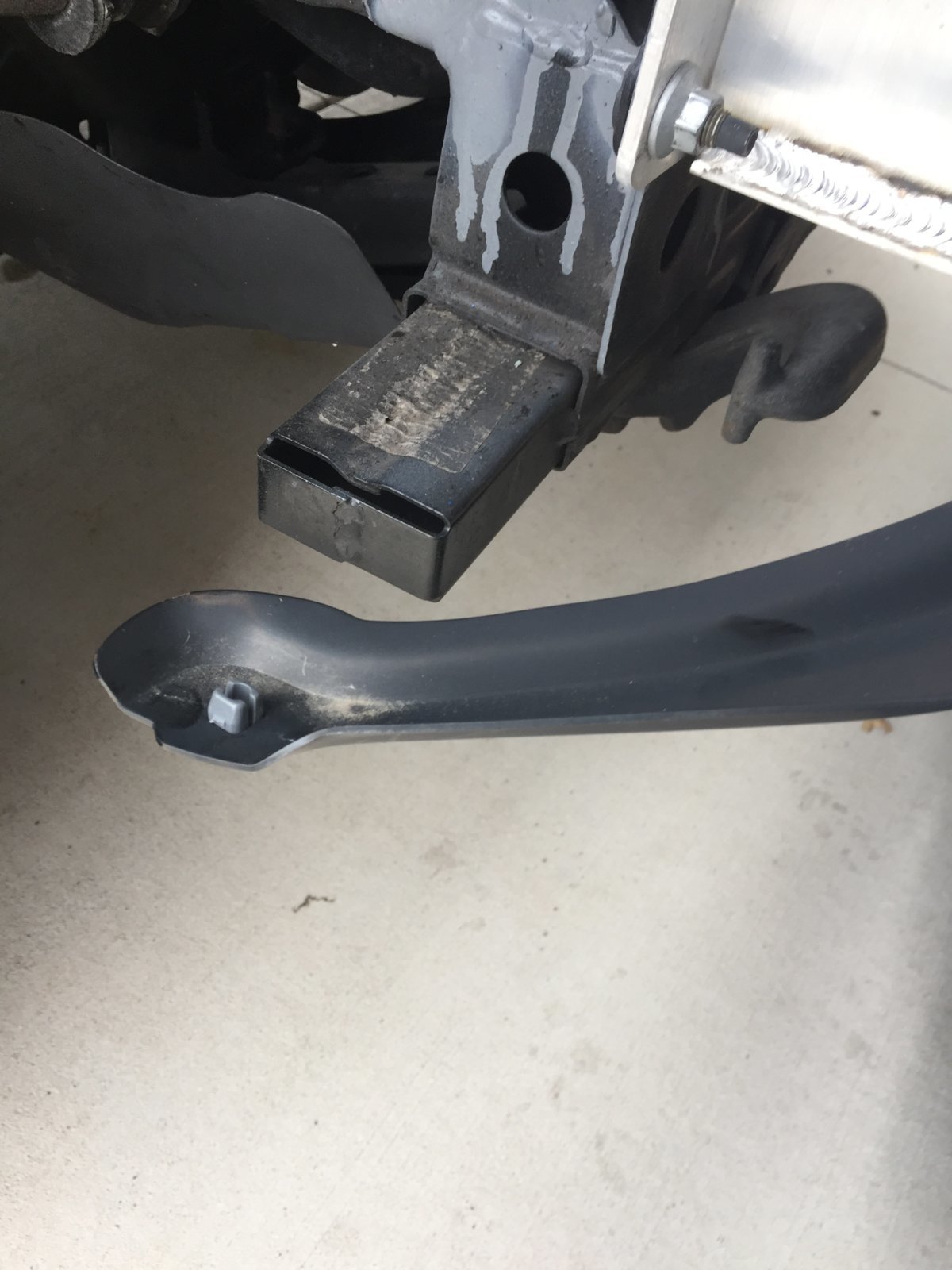

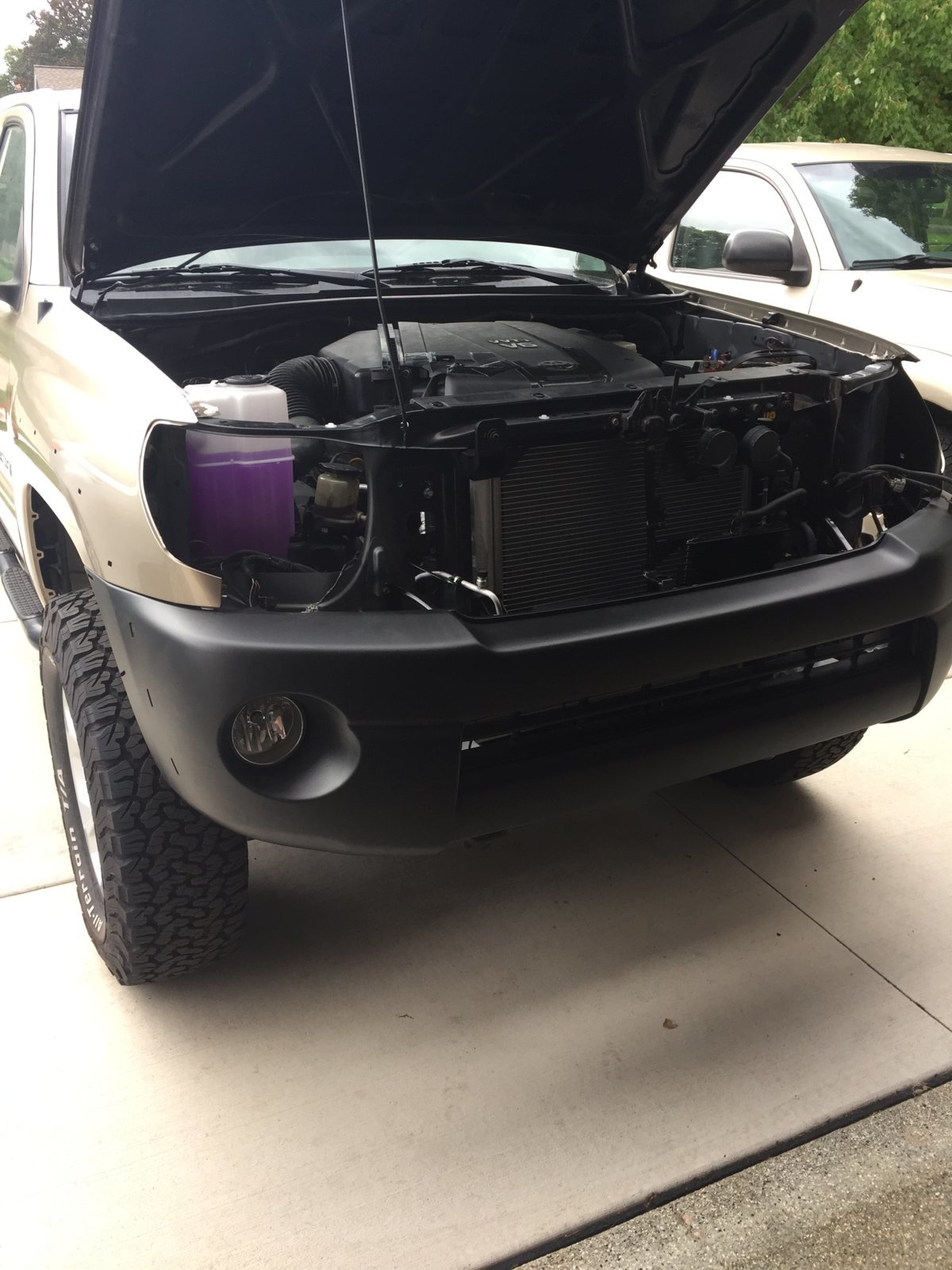

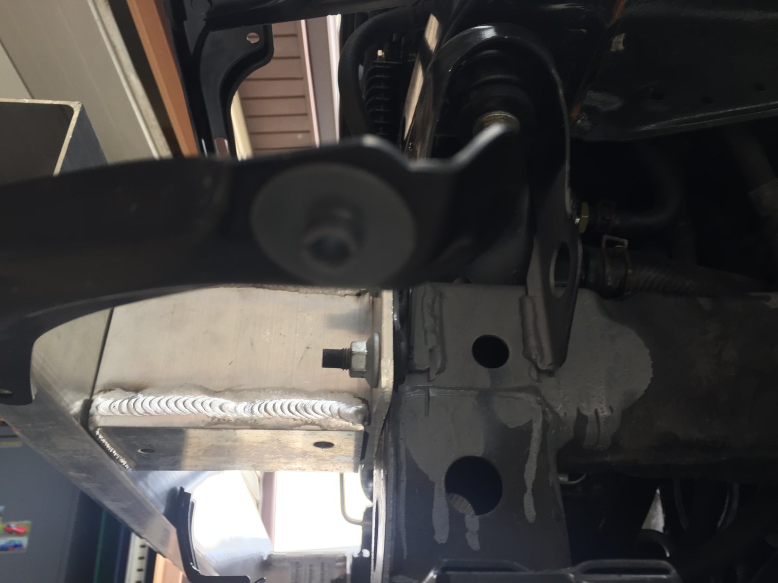

    I have an 2006 I took these photos last year when I replaced stock bumper. I had my dad's truck to use as a guide. It helped a lot.
    Here is a list of part and my notes, hopes it help with the pictures
    Bumper Bracket L ...... 53274-04020
    Bumper Bracket R ...... 53273-04020
    Bumper Rail C .......... 52521-04040
    Bumper Rail L ........... 52126-04010
    Bumper Rail R ........... 52125-04010
    Hood Latch Beam ...... 53209-04011
    Bumper Beam ........... 52021-04010 - Beam
    Bumper Beam Exten ... 52025-04010 - Front Right
    Bumper Beam Exten ... 52026-04010 - Front Left
    Bumper Bar Nut ........ 90178-A0044 x6 - Bumper Bar to frame (nut) -
    Bumper Bar Nut ....... 90178-A0044 x6 - Bumper Bar to Bumper Extension -
    Bumper Cover Bolt .... 90080-11416 x4 - Bracket to Radiator Support -
    Bumper Cover Bolt .... 90080-11416 x2 - Hood Latch beam screws -
    Nut, Flange ............... 90080-17258 x4 - Bracket to Center Support -
    Nut, Flange .............. 90080-17258 x4 - Bumper cover to Side Bracket support -
    Bumper Support Rail 52115-04060 x3 - Bumper Cover to Bumper Support
    Screw with washer 90159-A0029 x2 - Bumper Cover to Bumper Support
    Screw with washer tap 90159-A0029 x2 - Grill to Radiator Support
    Retainer ................... 53879-58010 x2 - Bumper Cover to Bumper Support
    Clip Retainer ............ 47749-58010 x2 - Bumper Cover to Bumper Support
    Retainer ................... 52535-0E010 x2 - Bumper Cover to Bumper Support
    Bumper Cover Clips .. 52161-02020 x7 - Bumper Cover to Bumper Support
    Bumper Cover Clips .... 52161-02020 x2 - Grille to Radiator Support
    Bumper Cover Clips ... 52161-02020 x2 - Headlight filler
    Clip .......................... 90467-08217 x9 - For Plastic Radiator Cover Clip -
    Nut .......................... 53117-04010 x2 - Hood Latch to Bumper Support
    Grille Retainer ........... 53145-12010 x2 - Grill to Bumper
    Panel Clip ................. 53935-04020 x2 - Bumper Cover Spacer Headlight filler clip

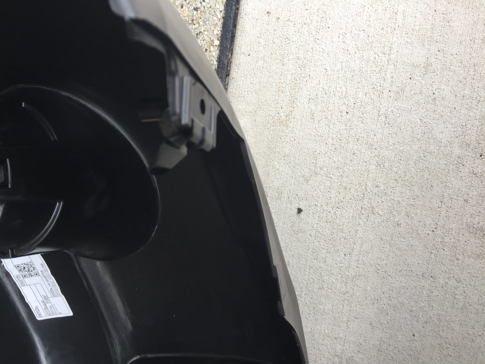

    Thank you.
    What is this thing? And what is it for? I don’t seem to have it on mine. upload_2024-7-20_16-49-33.jpg
  4. Jul 20, 2024 at 5:39 PM
    RockfordTaco2006
    RockfordTaco2006 Well-Known Member
    Dec 12, 2022
    #412888
    436
    Alexander
    2006 Toyota Tacoma TRD Off Road 4x4
    2 Inch Lift
    That bracket sits inside the big bumper cover. It comes off the bottom of the Bumper Bar. Mine came with them riveted in. It attaches to the bottom of the big bumper cover and inner fender liners. One screw goes up threw all of them to secure the bottom corners. Hope that makes sense...
