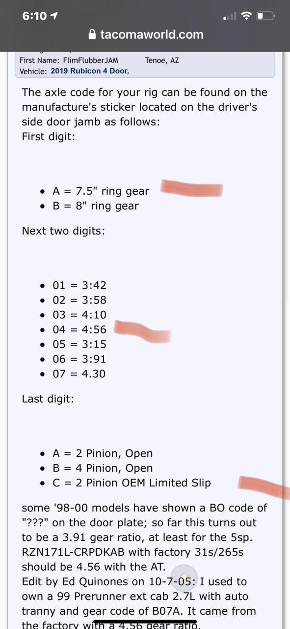

    Don’t mind the red lines those were from my last truck so I’ll pretend they’re invisible lol

    None of these apply to 2005+ Tacomas.
    Also there were no 4.0L 2WD 5-lug trucks, so it’s definitely 3.73:1.
