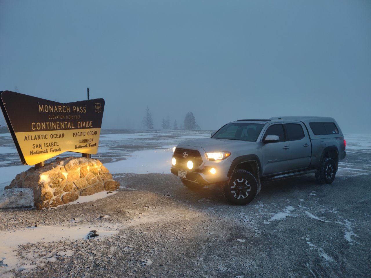

    If the 3peak mountain snowflake is not on the tire, it is not severe snow rated. OEM tires get different specs. I felt that the GY Wrangler Kevlars were horrible in snow/slush ( I am a dedicated winter tire snob), I swapped them out to 265-75-16 Toyo Open Country ATII which are taller, no rubbing, and now the new Open Country ATIII Are 3Peak rated, are quieter, and work very well in the snow slush (but nothing compares to a dedicated winter tire).
    265-75-16 /\
    265-70-17 ATIII \/
    265-70-16 Toyo Observe GSi5 Winter (this is the last season on them) \/

    Beautiful truck, beautiful scenery!
