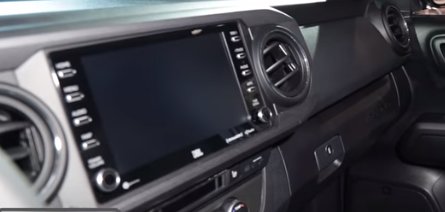

    The 2020 Taco will have Carplay/Android auto with the entune 3.0. From the pic below, it looks like it will be a direct swap as far as the physical size/shape go. Screen is just larger with a smaller bezel around it.
    The problem is, it looks like the current entune 2.0's retail for around $900+. Can't imagine what the entune 3.0 would cost if the swap ends up being possible with the '16 - '19s.
    I say go aftermarket vs. the NV Connect... I highly doubt it will work as well as you want it to and I guarantee it is frustratingly slow to navigate.
