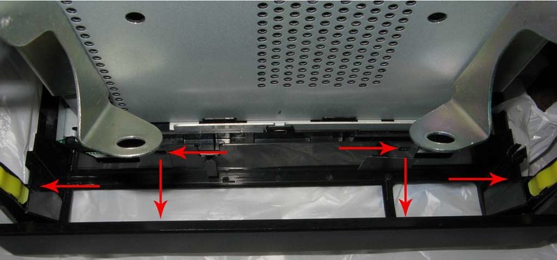

    The black plastic around it flexes somewhat. There are 6 little sawtooth hooks that you have to get past. It's kind of a pain to do. I'd recommend little flat blade screwdrivers. I managed to break the plastic in one spot during one of the times I swapped the radio in and out.
    I don't know if the picture helps. It might help to have someone give you a hand, if possible.
