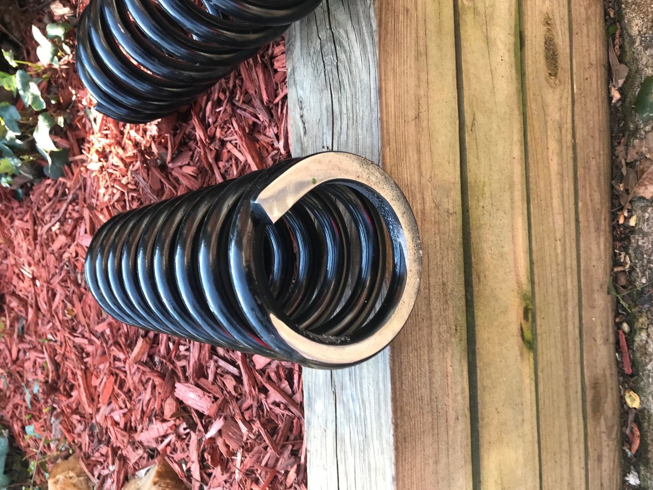

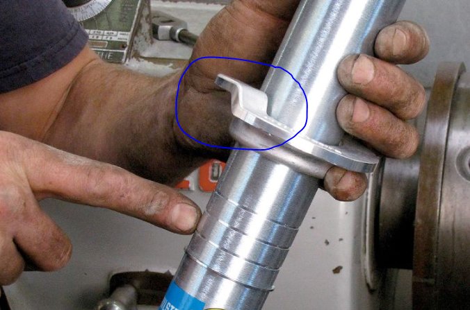

    I have had a 1997 Tacoma for a long time now. I have had stock suspension, Bilstein 5100 with stock coils, 5100s with OME 881 and 882 and Eibach coils, and now King coil overs. I have ridden in Tacomas with full OME suspension and complete parts store strut replacement options. More specifically the Monroe's you can get from Rock Auto.
    So I have had my far share of experiences with 1st Tacoma front suspension options in my opinion.
    I recently bought a 2004 double cab V6 as my daily driver since my 97 build is starting to get out of hand. The suspension was completly blown out and I was searching for budget options to get the ride quality back without lifting.
    I settled on the new Bilstein 5100 Shocks (24-249928) with the 4 c-clip positions instead of the old-school 3 positions, and Moog 81082 coils (465lbs coils) The cool thing about these coils is they are side specific! one of the coils came labeled "driver side" and this coil was just a hair taller than the other. NO MORE TACO LEAN
    I also purchased new bushings and top hats.
    Top hat part number: Monroe 904900
    Shock shaft (?) bushings: Wheelers offroad (no real part number)
    I did have to rip out the bushings that came with the Monroe top hats to work with the wheelers bushings, this ended up fitting perfectly. You cant replace just the top hat and try to re-use factor shock shaft bushings, the spacing wont work. So if you plan on buying new top hats you must buy the wheelers bushings as well.
    Total cost: $339.20
    If you re-use factory top hat and bushings: $262.70

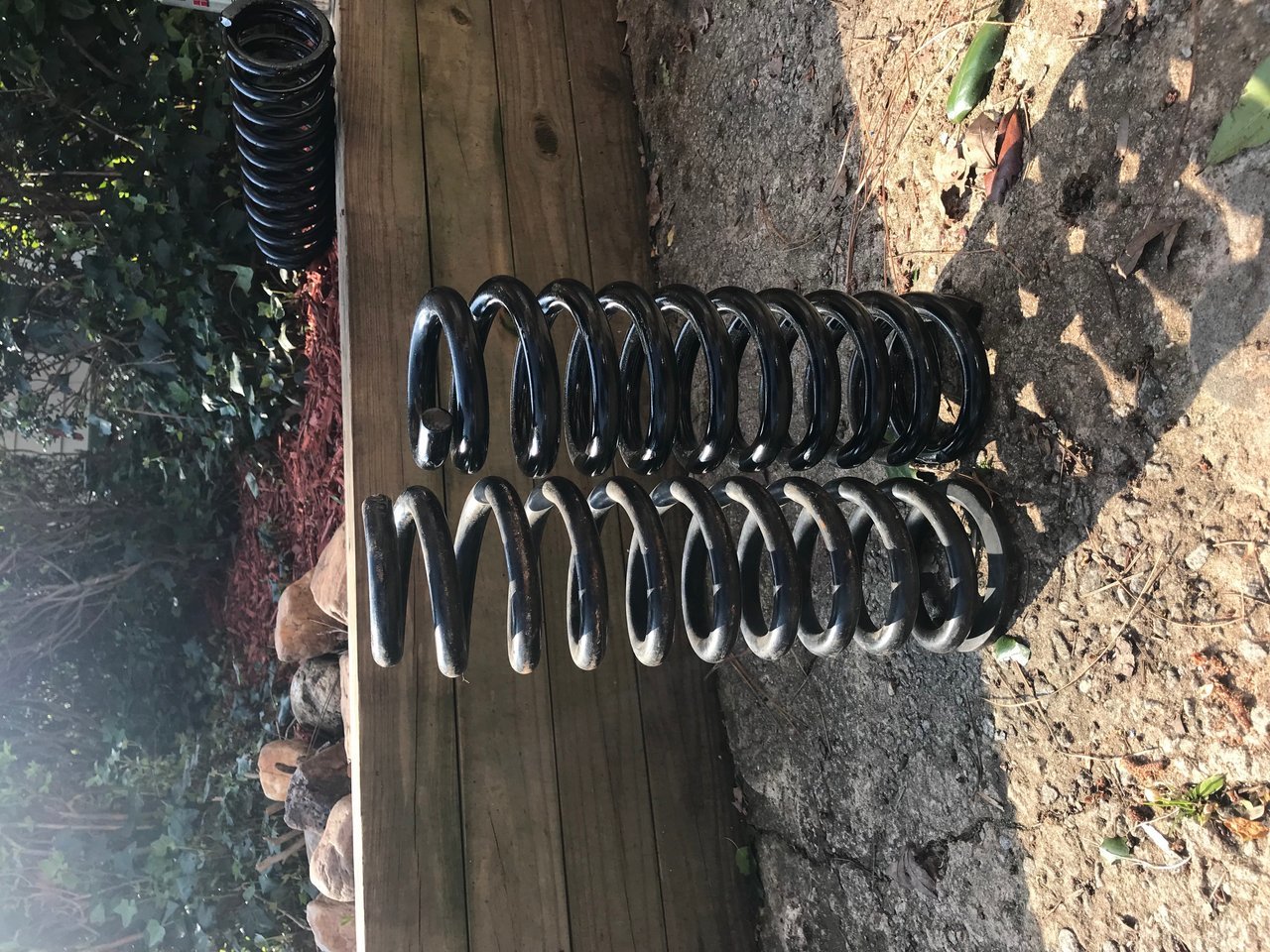

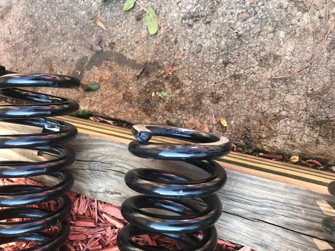

    In the pictures below you will see the MOOG coils are much shorter than the factory coil springs. I also had to take a grinder to the top of the coils to get a flat surface for the new top hats to sit level. I grinded away until it resembled the factory spring profile and when I set them down on a flat surface they stood straight up and down. I then re-painted the exposed metal and installed everything using the "on the truck method" without spring compressors. The whole process took about 1.5 hours and the ride quality.....AMAZING!!!! This is by far the best stock height budget suspension option out there period, minus King/Icon/etc coils overs of course. Like I have had experience with just about every option out there when it comes to suspension on a 1st gen Tacoma and this is absolutely amazing.
    I hope this thread will help someone out, I couldn't find any information on stock height coil replacement options for tacomas. After a bunch of research on the different Moog spring options I gambled with the 81082's and FRICKEN LOVE IT!
    When researching Moog spring options I considered the weight and the length (I purposely went shorter so the springs would be pre-loaded less), I gambled on whether or not they would "fit" over the shock body.
    And before some keyboard comando tries to say something about grinding down the coil springs...I really dont care, Shade tree coil modification has been apart of the automotive world for a very long time now and I can assure you the springs are in no way "compromised"

    The coils need to be ground down no matter what. The factory coils and all aftermarket coils designed for the Tacoma have a flat profile from the manufacture because the top hats are flat, unlike the bottom of the spring where the metal "cup" supports the coils shape. see the picture below
    Keep in mind i have a v6 double cab, if you have a single cab 4 cylinder you'll want to go with a lighter weight Moog coil.

    One last question, I see the groves for the height, can the height be changed once the spring is installed
    and mounted on the truck or dose the coil have to come off to set the spacer for a different height

    coil has to come off
    with stock springs bilstein advertises:
    1st setting: 0" lift
    2nd setting: 0.67" lift
    3rd setting: 1.25" lift
    4th setting: 2" lift
    with your truck and 881 springs probably add about 1" to 1.5" to each of those numbers

    Had to bump this thread to vouch for the Moog 81082. I have an '01 TRD quad cab prerunner v6 (280k miles), and changed the shocks to Bilstein 4600s (same as 5100s on 0" lift setting) with the stock trd spring. It was way softer. The real bummer was that I lowered my 6 lug 2" in the front using a shock sleeve and I was hitting the lower profile bumpstops ALL THE TIME. Not to mention the increased body roll. After reading threads (mainly this one) I decided to go with the Moog 81082 465lb linear rate springs https://www.amazon.com/Moog-81082-C...TF8&qid=1523298245&sr=8-1&keywords=moog+81082. Interestingly (and unlike @wolfgang123 found) they were the same height as the stock TRD progressive springs. I did not grind down the top coil, just left them as is. Also reused the stock 280k mile top hats and bushings. It only took 45 minutes to replace the spring because I didn't even need a coil compressor with the lowering sleeve. The ride is just peachy and took the roll back out of the cornering. Next on the list is a bigger swaybar!

    glad it worked out for you. Did you notice the drivers side coil spring was labeled and slightly taller than the other (moog coils) ??
