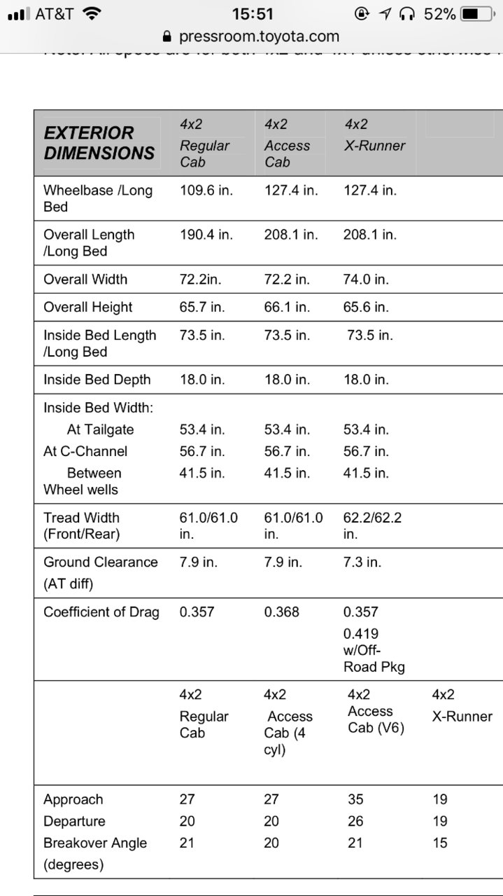

    Hi y'all!
    Looking for a quick favor. Need to find out the stock ride height of a base reg cab 2nd gen. Looking for measurements from the ground through the center of the hub to the bottom of the fender. Trying to get measurements on stock 215/70/15's and no lift. Any and all help is greatly appreciated.

    Not what you asked for but here is stock dimensions if you need that

    Thank you.

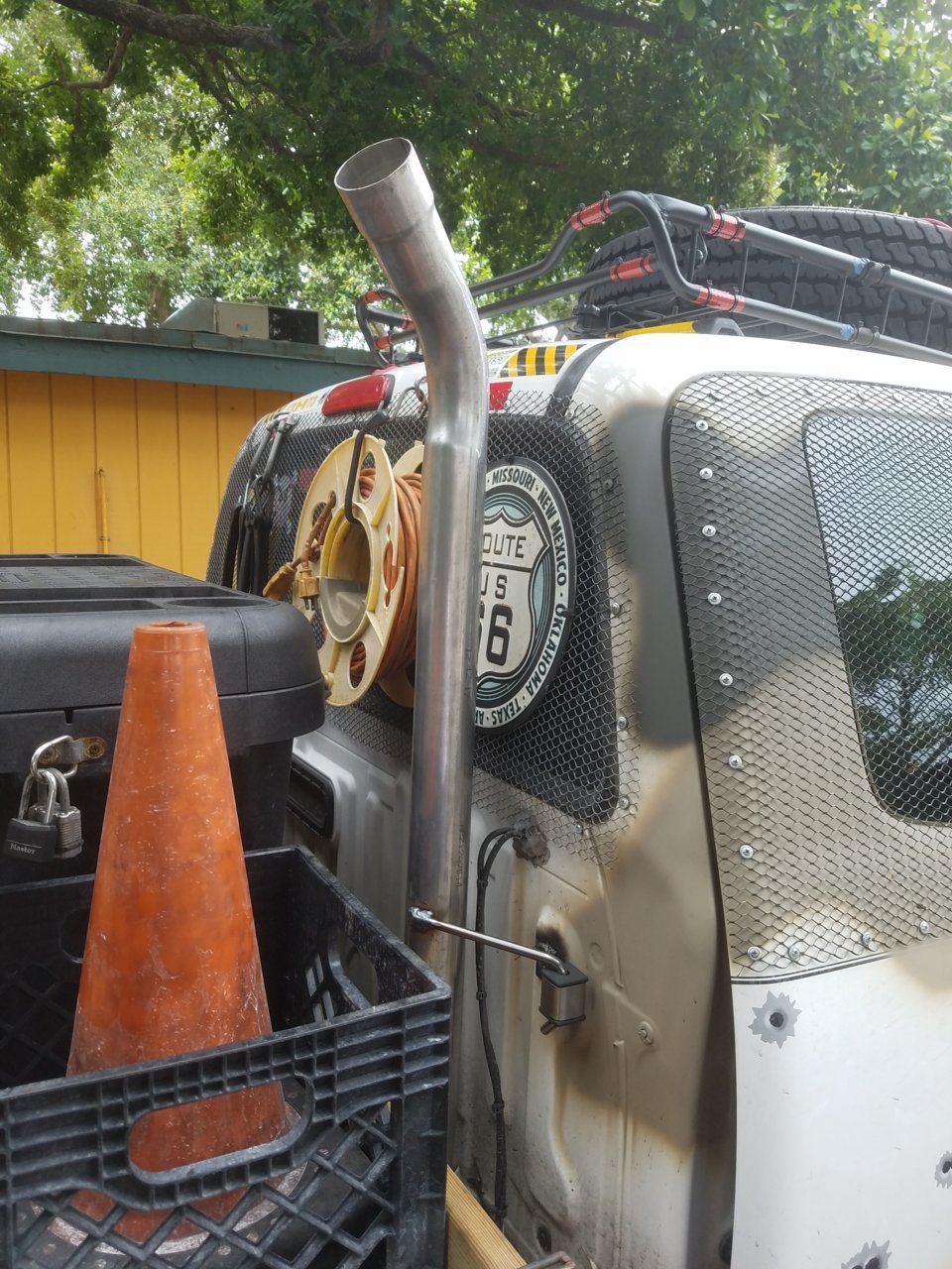

    Is that a padlock on the driver door?

    Yeah Buddy lol

    Is there like a serious problem with theft where you live?

    Well.. It is Miami.. Lol.. :infantry:
