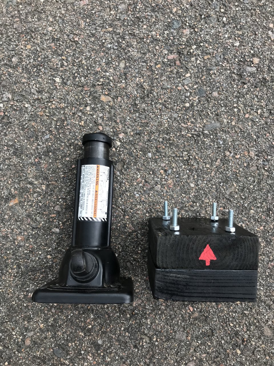

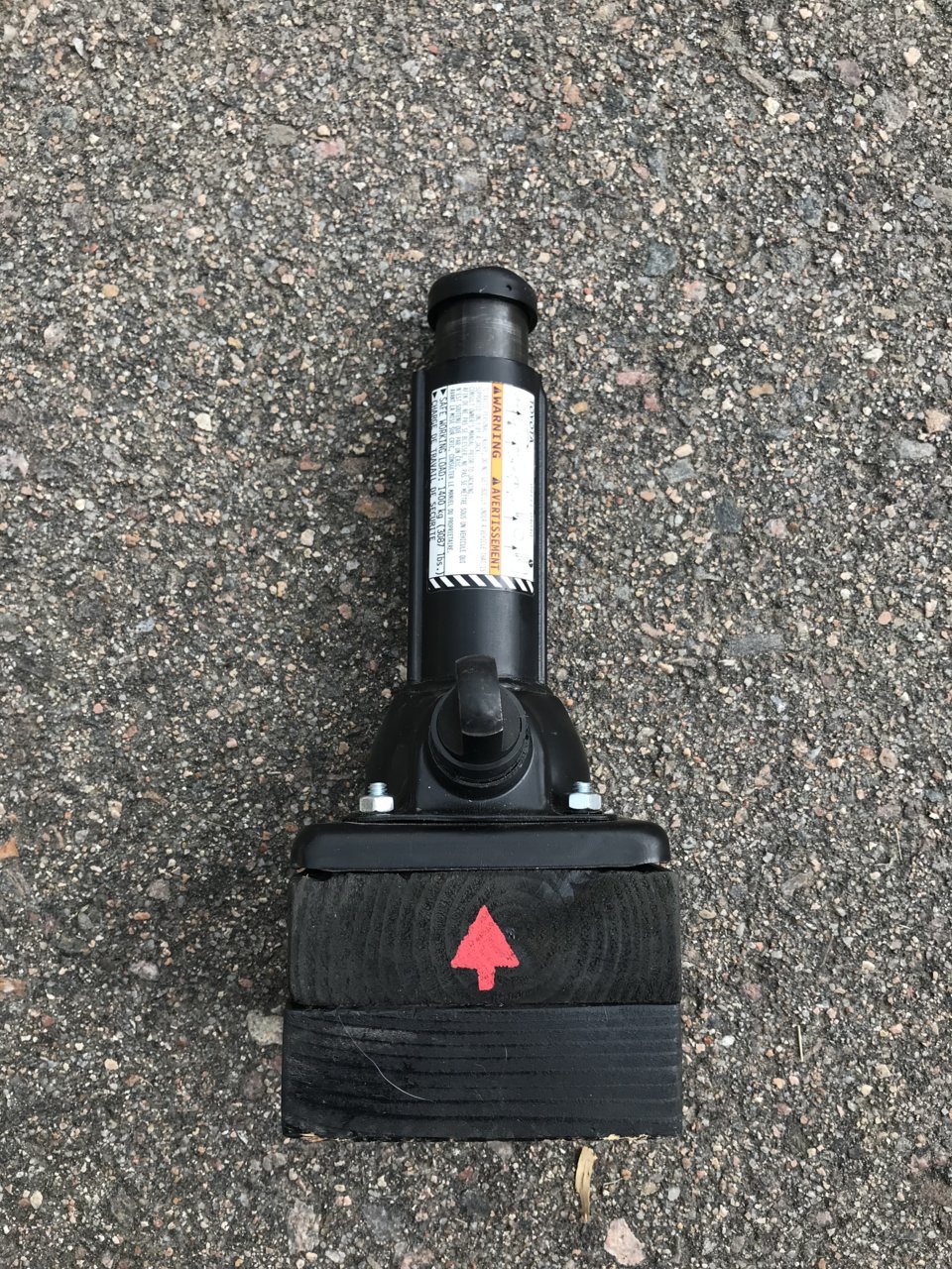

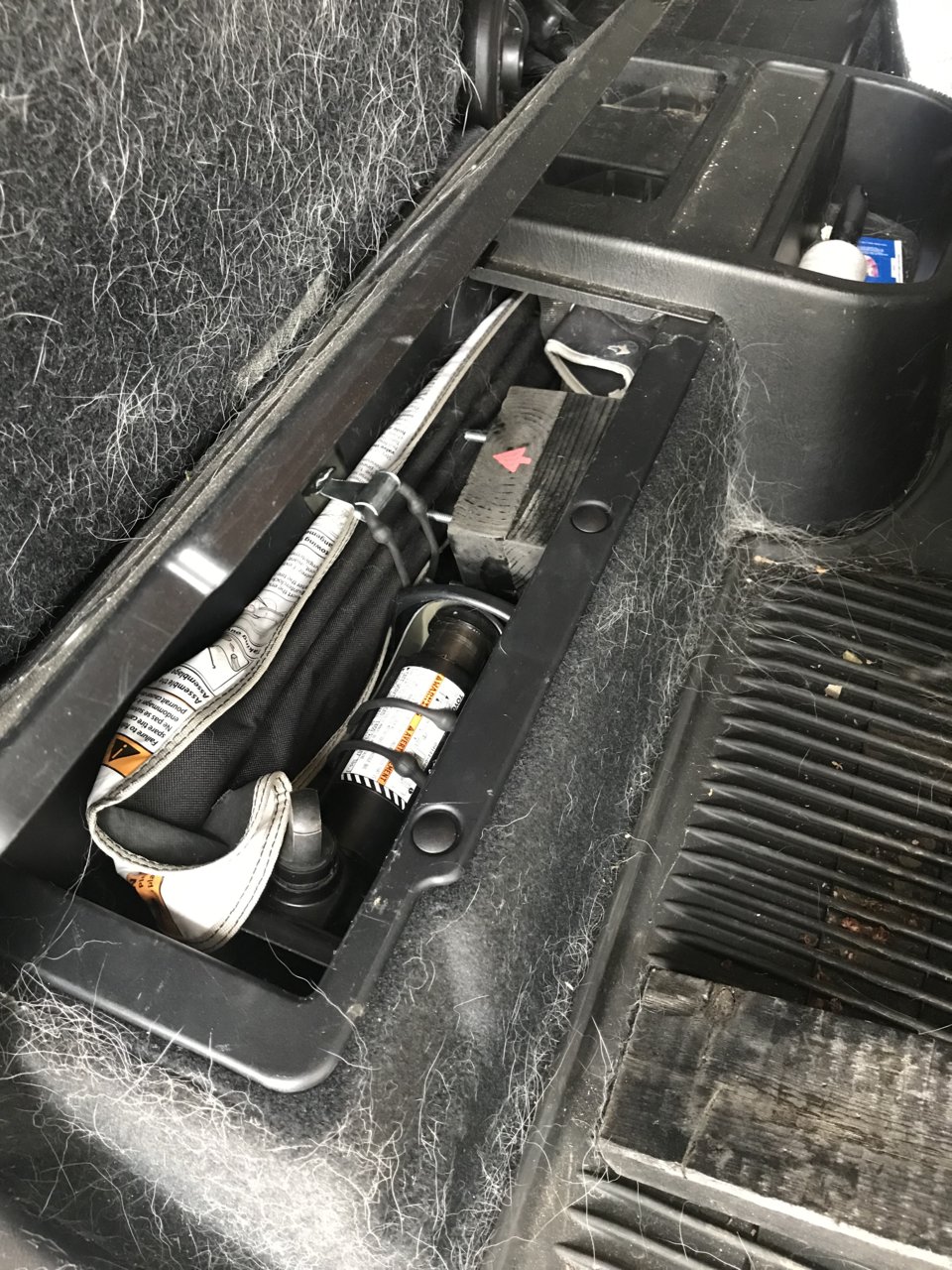

    @Syvman I had the same issue once I lifted my truck and went to 285s. I made a "extension" out of some 2x6 wood and some carriage bolts. It fits in the same compartment as my jack in my 17' access cab.

    Very cool. Good on ya.

    This sounds like a great idea. I guess I don't think far enough outside the box. Thank you
