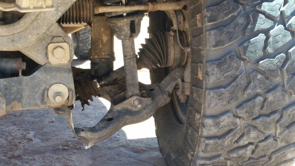

    Terrible idea.
    Here's why: 6d536b819216b14f6d2799539fa52973_f3dd40e39f4ca4adfe438bb1528b77a667c97ef1.jpg
    At the end of the day if you can afford a high dollar bypass set up meant to go fast no need to skimp on the LCA which there are a few stock width options. (That are cheaper then bypasses! )

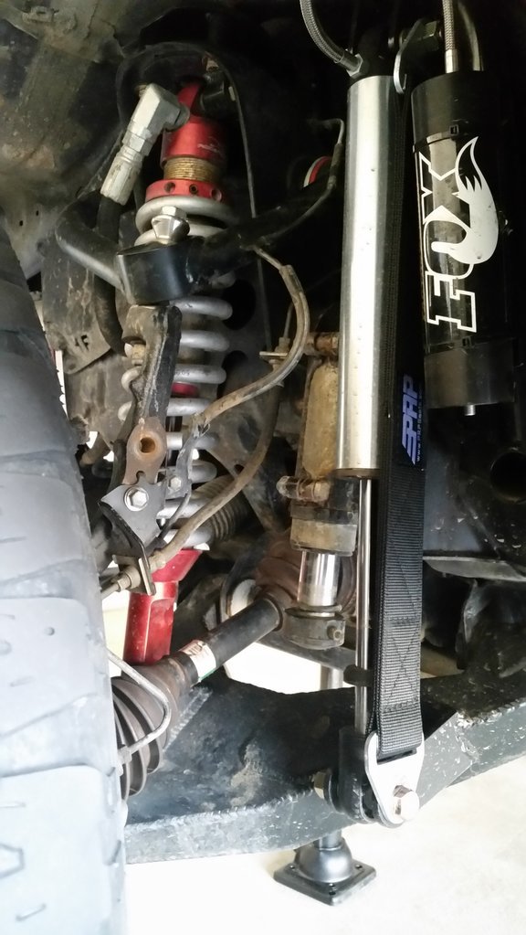

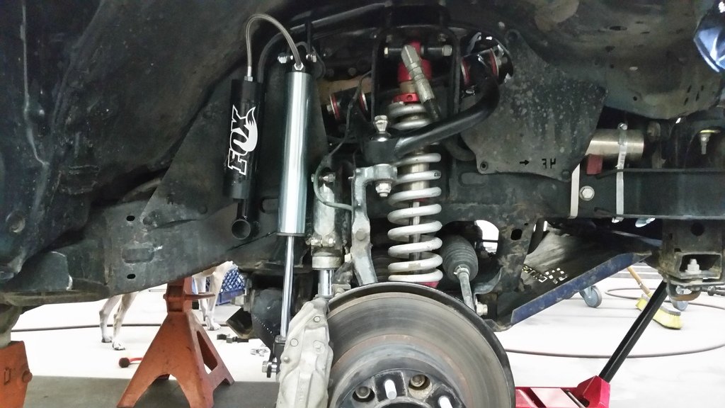

    Coming from a guy who has dual shocks I am going to have disagree with you immensely. Since the upgrade I have nothing but upped not only my offroad comfort, but overall confidence out there. I could take washboards, jumps, G outs and high speed play like you wouldn't believe it. It has essentially turned the truck into a whole new vehicle offroad and the on road manners have not chaned a bit. Matter of fact, they improved as well. This thing could actually keep up with the entry level LT vehicles. It's all about the valving and how it's set up on each shock. This thing thing just absorbs all the hits and keeps asking for more.
    Now, would it be worth it to incorporate a dual shock setup using stock? No. The stock arms are weak, and prone to damage over time with the use involved with offroad play. Could you do it? Sure. Again though. It wouldnt be worth it unless you have high strength boxed arms.
    Adventuretaco13 likes this.

    Thats the input I'm looking for!! haha, Thanks for the sweet pictures by the way:thumbsup:

    Exactly. Yes to dual shocks, no to running them with stock LCA. You will not be able to use them to their full potential if you use the stock LCA's.
