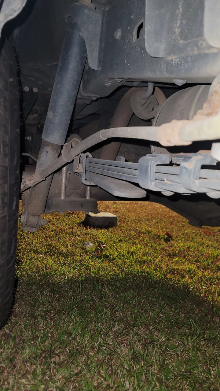

    I was wondering if any of you guys could post pictures of how much arc your stock leaf springs still have with an unloaded truck bed.
    I've got an 08 I'm working on and it seems that mine are warm out and just looking for comparisons. Thanks.

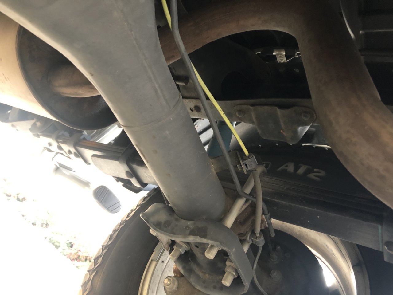

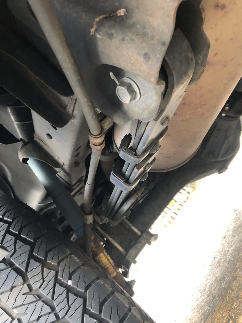

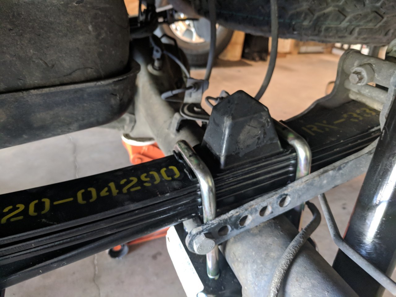

    EDIT for pictures;
    Here's a picture of the old bumpstop with the 2 leaf + 1 overload leaf
    Here's a picture of the recall leaf pack showing the new bumpstop and the 3 + 1 leafs
    If they are the original leaf pack, I'm sure they are flat or even negative arch.

    Flat as a 12 year old Japanese boy

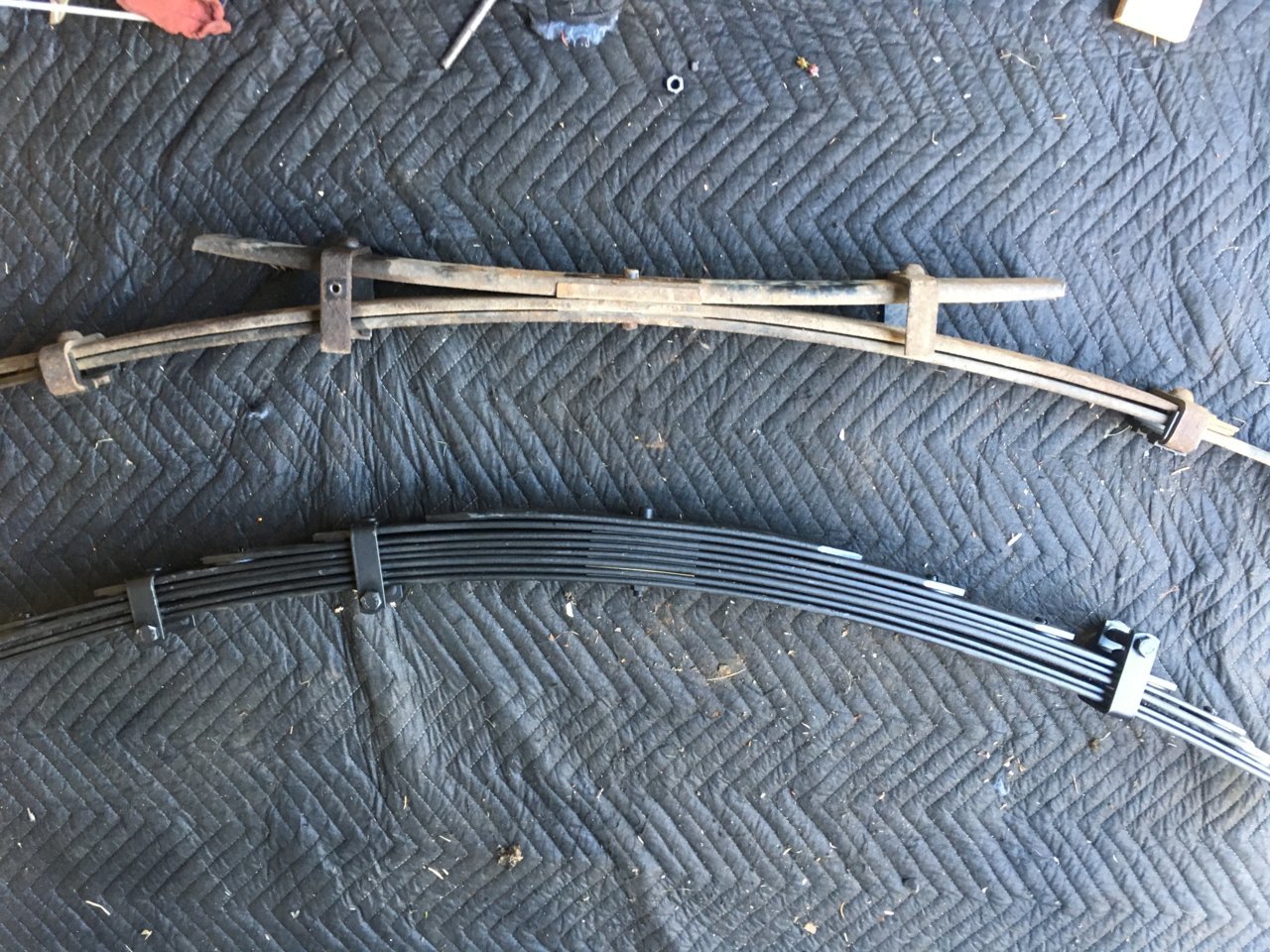

    Stock TRD OR next to Icon RXT

    I didn't do any measurements but pretty sure my stock springs have a negative arc

    They don't look flat quite yet, but it could be the picture. Our rear springs are notoriously flat.

    Those appear to be the TSB springs, TSB being Toyota Service Bulletin. It was NOT a recall, but a service bulletin, meaning enough people complained about "harsh ride with load" than they decided to address it, but not enough of an issue to warrant a recall. The originals were 2 springs and 1 overload, and they went to 3 springs and 1 overload (which you appear to have). I can't remember the year they started putting the 3+1 pack on the 2nd gen, mighta been 2012 when they did the front end refresh.
    I honestly don't think your springs look all that bad. A SLIGHT negative arch isn't surprising, specially given the age. they are pretty flat, even new. You can prolly find some newer take-offs for cheap if you are worried about it, or there are a ton of aftermarket options for more $ depending on what you want: Lift, Travel, Load Capacity.
    And here are my Deaver U402 Expedition Stage III leaf packs. Mainly wanted to show up @ChiefBrody and his cute RTX pack, my 9+2 vs his 8! JK man, all good stuff :thumbsup:
