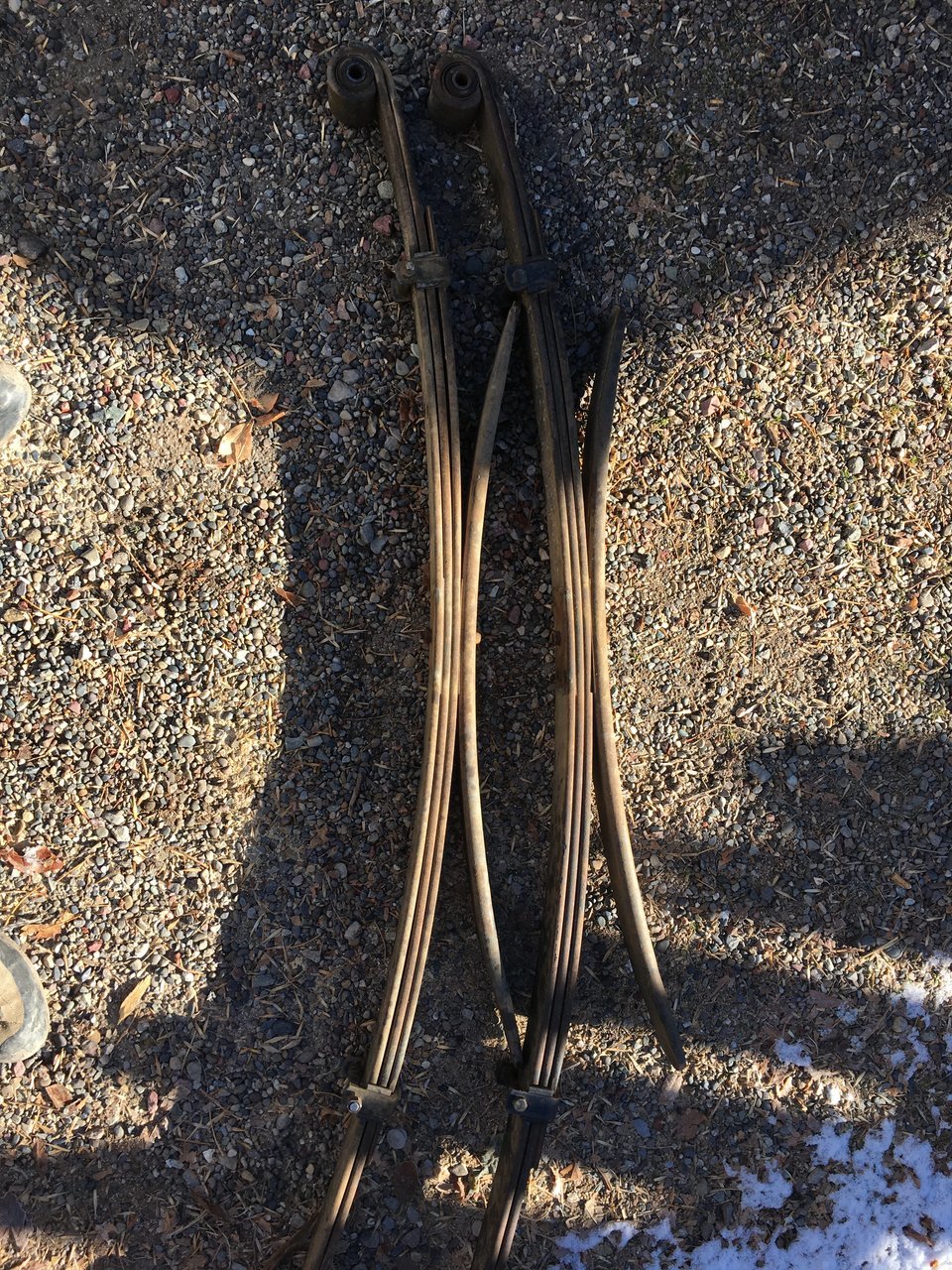

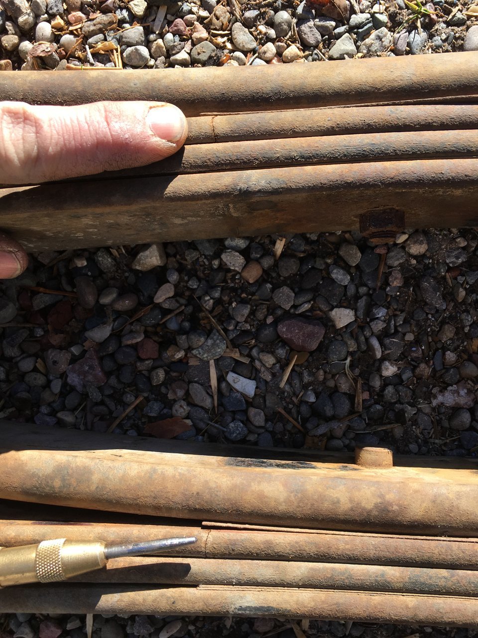

    GENERAL SPRINGS IS THE HARBOR FREIGHT OF SUSPENSION:
    I put General Springs heavy duty springs on my truck in October of 2015. About 3 weeks ago I was having the gears upgraded. I got a call informing me that both the leaf springs R & L were broken. I headed down to the shop and they were both broken in the same place, forward of the front u-bolt. While I do wheel my truck, I don’t go ape poopie, I’ve been accused of babying and not using my truck to it’s full potential. Suffice to say I like getting out there, just don’t see the point of hammering the snot out of it. At any rate my General Springs lasted just over two years, I’ll edit this post with some pictures later today. It appears that axle wrap, or a Newton would say “the equal and opposite force” was the reason these springs broke. I would recommend spending a few more shillings up front and getting quality springs, rather than going cheep and replacing them in a few years.

    Dang. I've never heard of that happening before with these but there aren't that many reviews out there on them. Did you try contacting General Spring and seeing what they'd do about it?

    They have a 1 year warranty, essential I’m SOL. I thought about shipping them back, but I don’t want spend the money. I have OME’s now with the additional leaf and a u-bolt flip. It’s been an expensive few weeks.

    This is what I had after 2 years with General Springs HD Leafs607A6347-B534-401B-BE74-4FC13864A7EF.jpg B212C945-6223-471C-8D65-6121CCDF4D10.jpg
