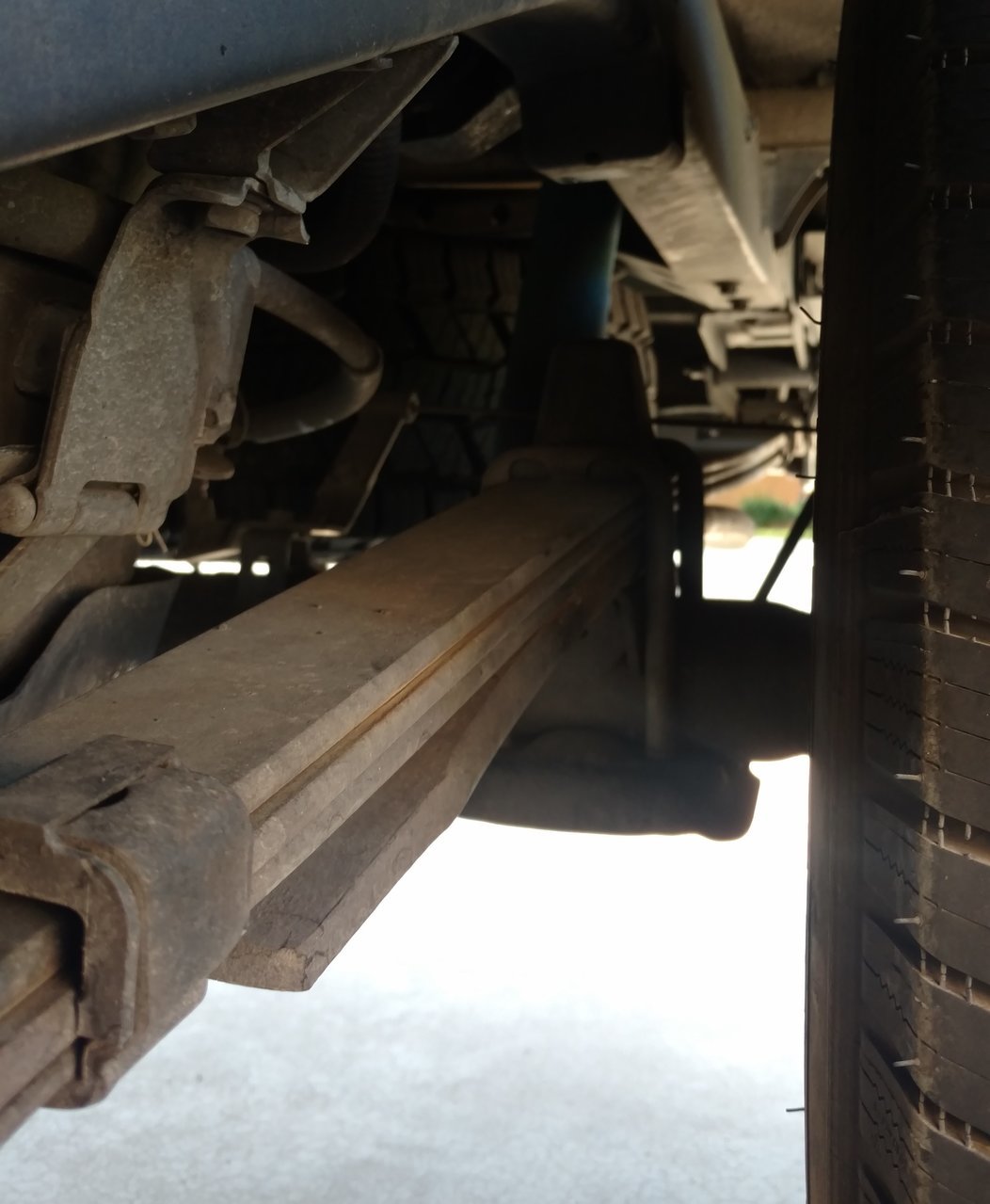

    Looks like I'm jumping on this wagon train as well. Here are my tired old springs with nothing in the bed.

    While I'm thinking about it, is there any easy way to tell if the front coils are sagging/worn out? The front is riding about 1/2" higher than the rear at this point, but everything is 19 years old and probably well past it's useful life..
  4. Mar 27, 2018 at 5:57 PM
    #44
    Danno1985
    Danno1985 Well-Known Member
    May 2, 2017
    #217999
    325
    Milwaukee
    2003 Prerunner TRD Off-Road (RIP)
    Yikes. That's bad. I'm also piggybacking on this thread as well, as I just received a set of General HDs and will be doing them next week, hopefully. After reading old threads, it sounds like I can expect the Generals to start out higher but settle to stock height or so... Looking at stock photos of our trucks from Toyota ads, it does look like there was a slight forward-rake from the factory; we've just all gotten used to the saggy-ass look. If it's way higher than I'm expecting, I'll just replace the 5100s up front with a fresh set and bump them up a notch or two.

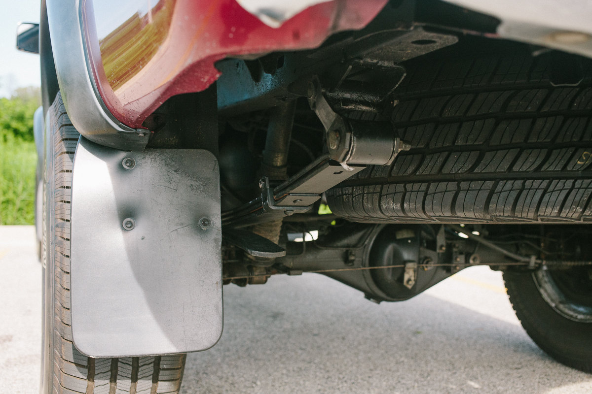

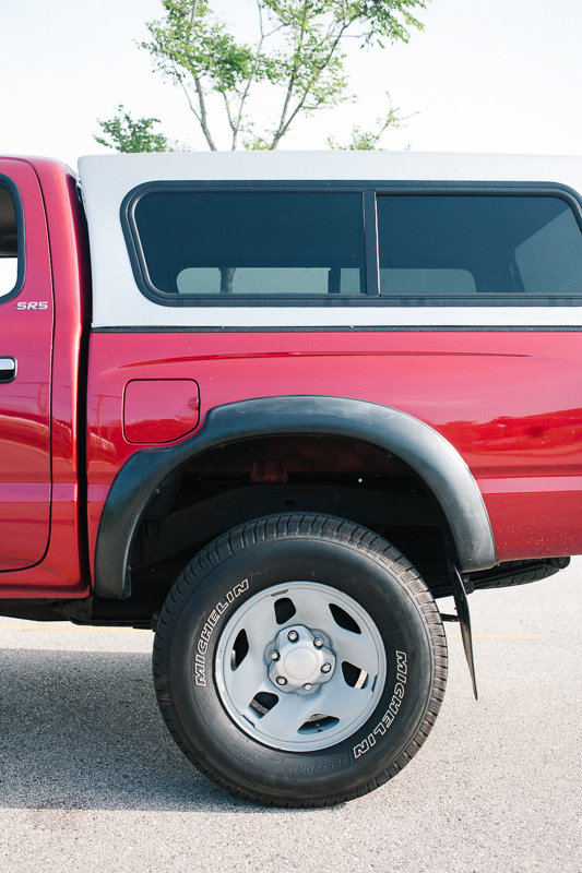

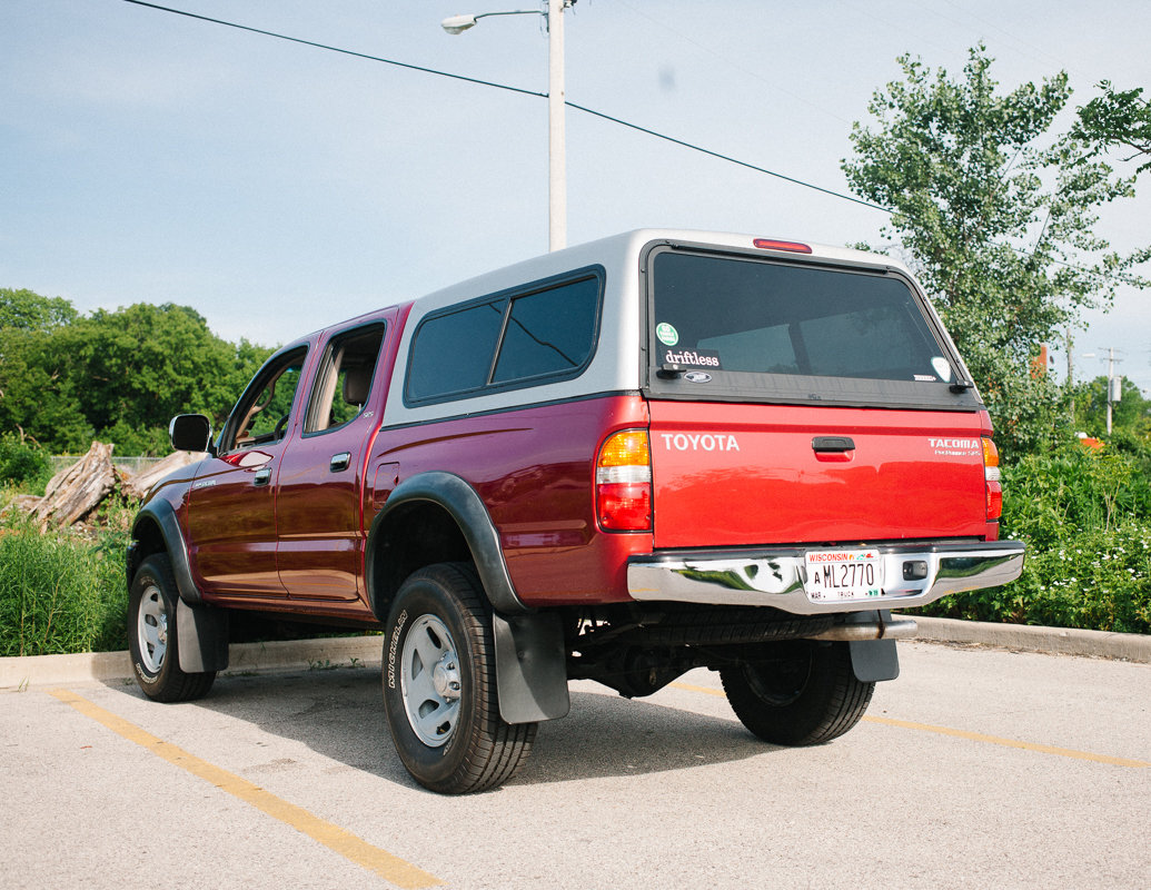

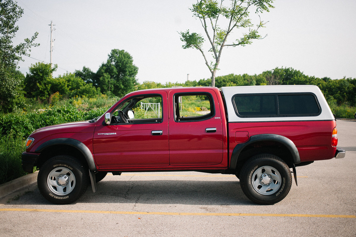

    So, I got the General HD leafs installed today and took the opportunity to have the front shocks swapped out for some fresh ones. My truck already had Bilstein 5100s up front (stock height setting), but they have a decent amount of miles on them and I figured it wouldn't hurt to replace them and bump them up a notch in case the Generals added a noticeable rake. Sure enough, the back end is sitting about 4 inches higher than it was before, but keep in mind the old springs were slightly inverted from wear. Completely unloaded, the truck would sit pretty much level but any weight in the back caused a noticeable sag. Accounting for the sagging that I somehow got accustomed to, I'd guess it's maybe 2 inches taller than factory at the back. I haven't measured anything yet. The Bilsteins are at the 1.75 setting and even still there's a pretty noticeable rake, but I actually dig the look. I'm sort of of the school of thought that pickup trucks are supposed to have some rake because, well, they're trucks. I think it looks appropriate. I'm going on a canoeing trip next week and I'm anxious to see how the Generals handle the extra weight of my canoe and camping gear. The tires could be a size taller, for sure (I'm running stock size), but I'll wait another 80-90k for these Michelins to wear out before I start thinking about that.
    Other thoughts: I wasn't even aware how much I had tuned out the axle wrap symptoms until today. Whoa. There were definitely some weird clunks happening that I sort of attributed to normal RWD driveline slack, but everything's silky smooth now. I'll have to update when I have some miles on this setup and see if it settles any, but for now I couldn't be happier.
