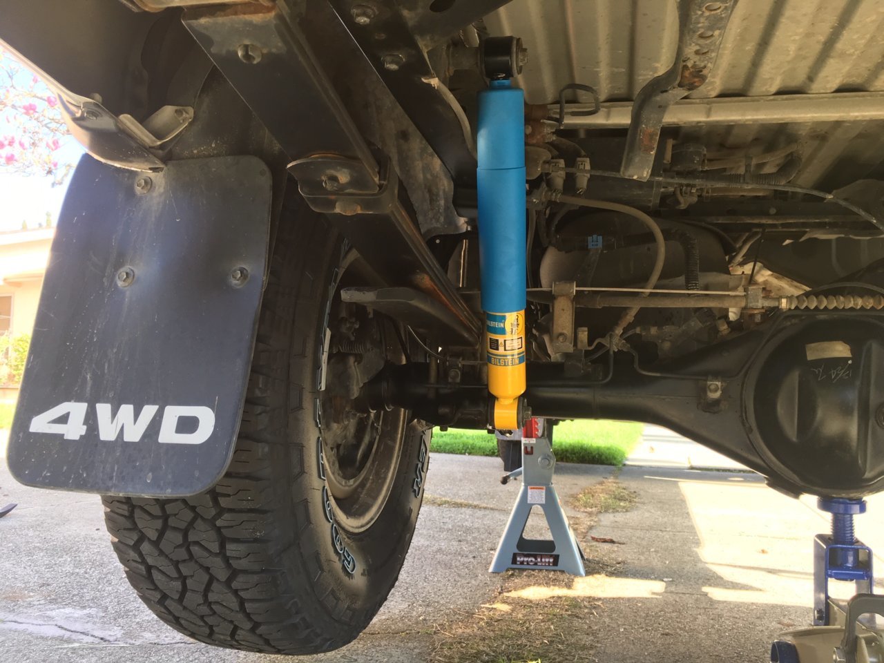

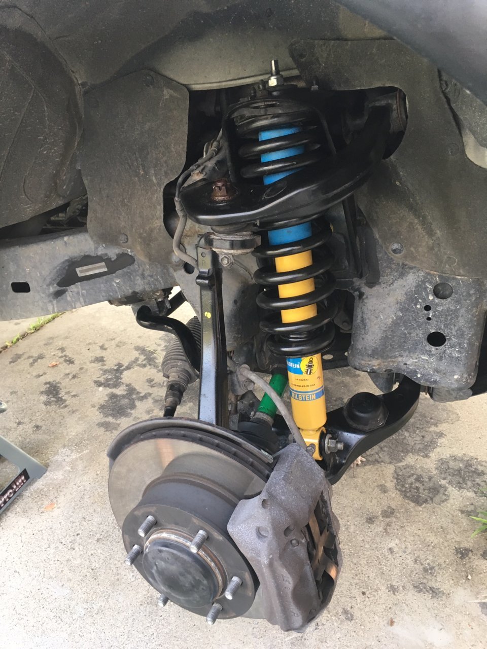

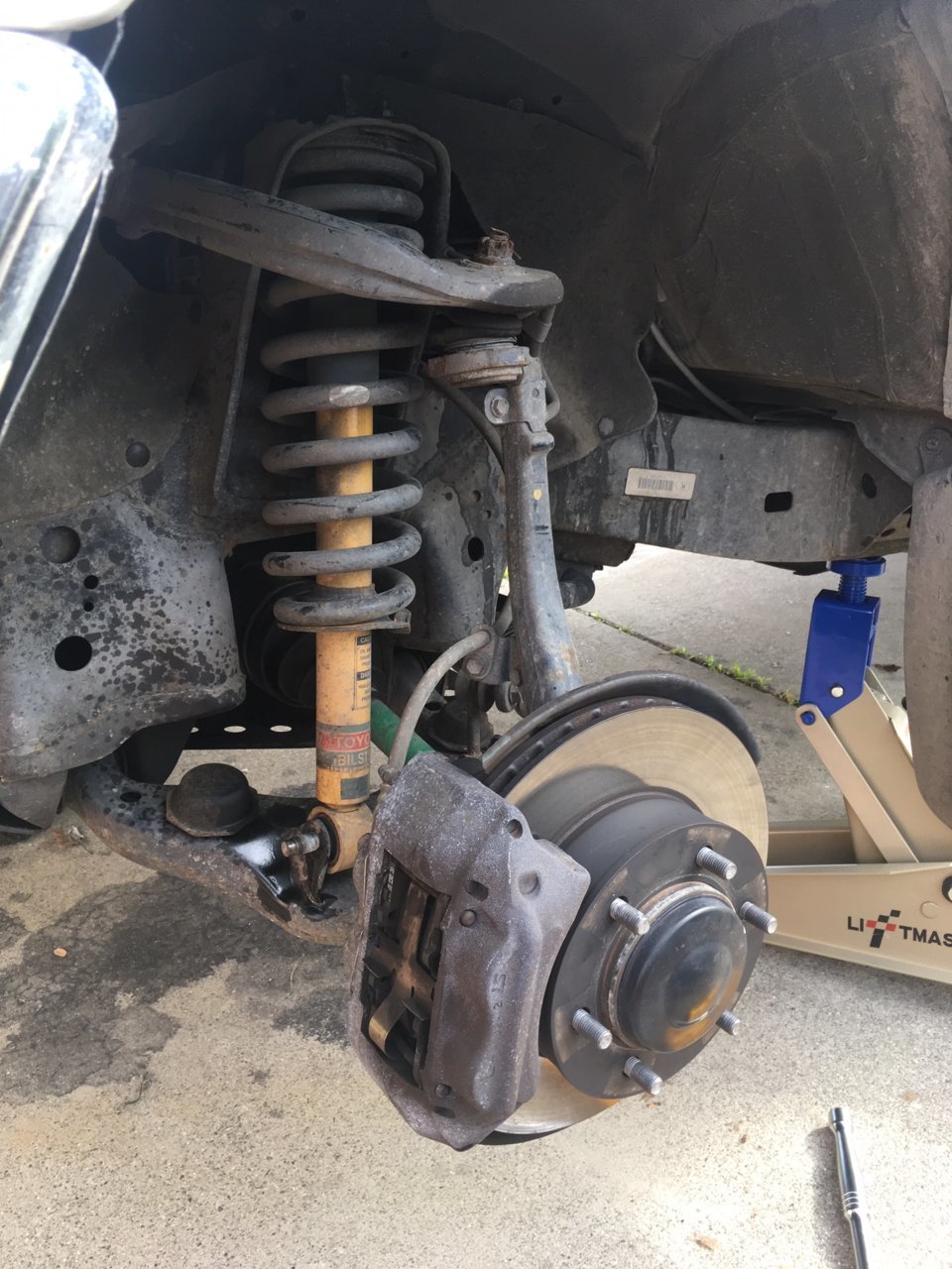

    I bought the standard (non HD) General Springs which are arriving today for my 02 XtraCab 4WD TRD Tacoma. I just bought the truck, only 100k miles on it and very clean (no rust, garage kept, 1 owner) but the previous owner used the truck for towing a small camper, so the suspension is ready to be replaced. Especially the rear.
    I bought four Bilstein 4600 shocks and replaced the fronts this past weekend. I kept the original coils, as they seem fine, but the leaf springs are pretty flattened/tired. I'll be replacing the leaf springs and rear shocks tomorrow and I'll try to report back on how much lift (if any), etc. I'm not looking for any lift, just trying to restore the truck's ride/performance to new.
    Here's the before/after on the fronts-

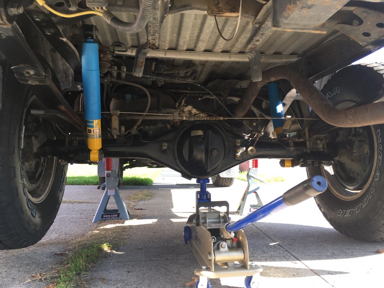

    Well, I chickened out on the leaf springs and only did the shocks for now. It was not an ideal setup and I didn't feel good/safe about doing it unsupervised since I've never done it before. I'm going to enlist a mechanic friend's help to do it this Saturday and I'll report back after.
    In the meantime, here's a look at the shocks. I wiped a bunch of things down under there since I was already in there.

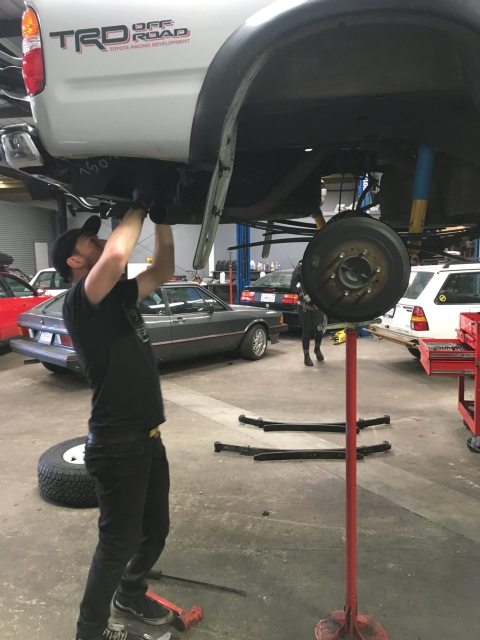

    Victory! Swapped out the 100k mile, 17 year old stock leaf springs with the standard (non HD) General Springs.
    With the stock leafs I had very noticeable axle movement when coming to a complete stop. That issue is completely rectified with the fresh leaf springs.
    The truck is about an inch higher in the rear with the new leaf springs than it was with the tired old stock springs. The old ones were well worn since the 100k miles they saw included many miles of towing a camper.
    It only took 2 hours including setup and cleanup, etc. I brought it to my buddy's shop and he sorted it all out quickly.

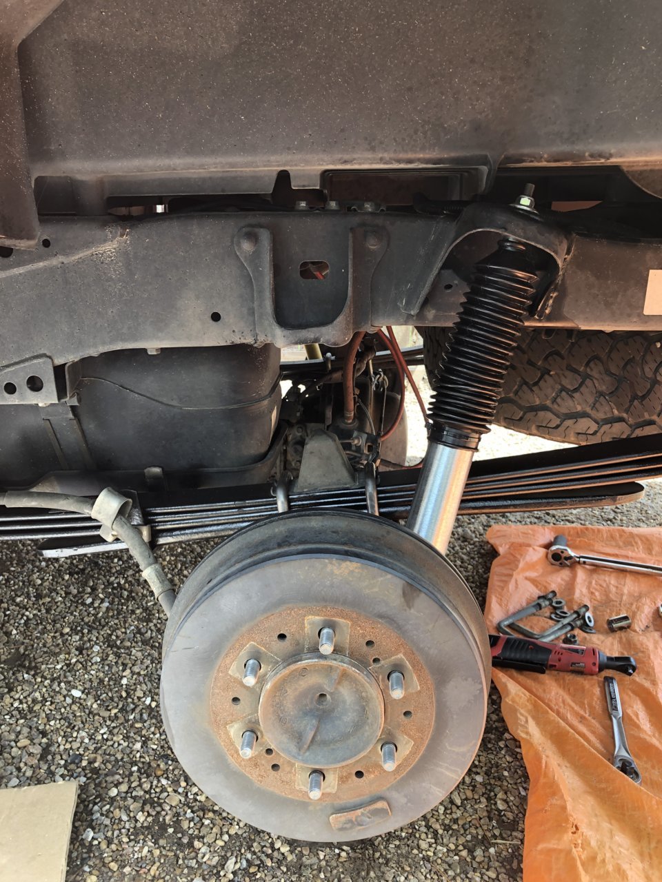

    Installed General Spring KC HD leaf with 5100s. Install went smooth. About an hour each side. The fronts got Bilstein 6112s. Drove it around the block and immediately can tell a difference. They feel so nice, ride is not harsh but feels more like a truck than an SUV now. Original suspension had 95k miles.
