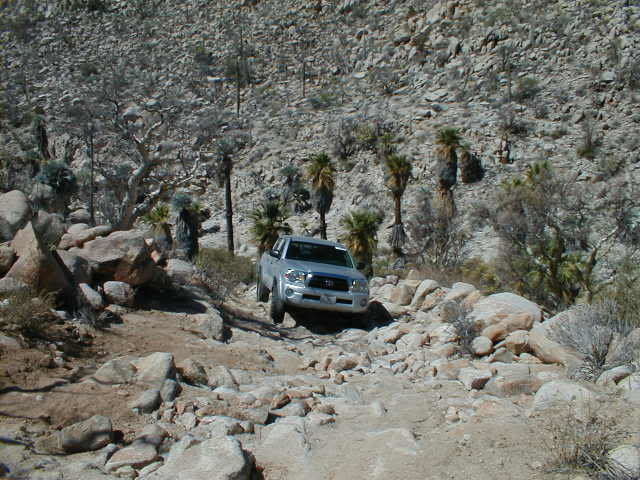

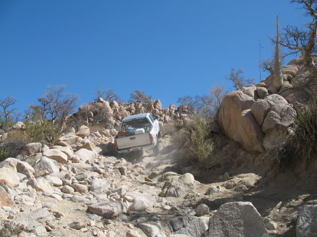

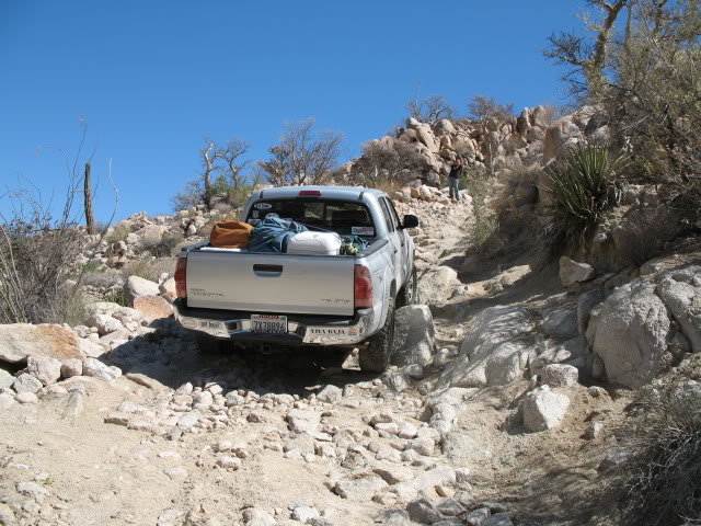

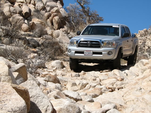

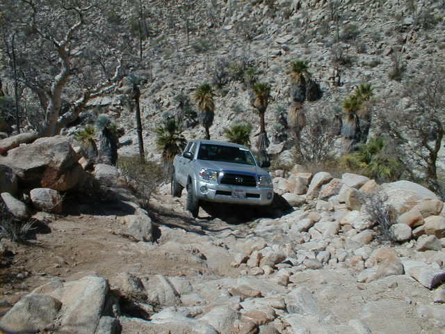

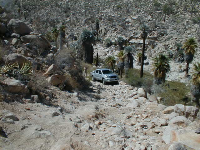

    Clueless? Seriously you need to drop to that level to feel good?
    I have been four wheeling for over 40 years and stuck in some pretty bad places including a river crossing and high tide rising beach.
    So, you don't know half of it, even though I post plenty here...
    What I mean is the rear locker alone did not get me unstuck without other action (I been stuck many times). Since getting the A-TRAC, in the same places I got stuck before, the A-TRAC pulls me through. It's that good having traction on the front as well as the back!
    I can't always stop to take photos in the most technical four wheeling. I more often go solo (specially with the security of A-TRAC), so nobody to take pictures of me...
    There are a couple of You Tube links in my signature of my truck climbing in A-TRAC and pulling a 2WD Taco up the Diablo Dropoff in front of TWers and Jeepers (who said no way could it be done).
    Some picks from the Widowmaker, Mission Santa Maria road, Baja California (I have done in all three of my Tacomas, but the 2010 with A-TRAC was by far the easiest and the grade was the worst of the many times I drove/ rode it...
    Had people at the top and bottom taking pictures.
