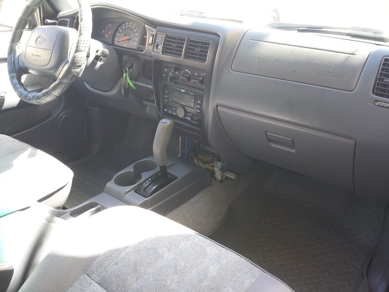

    Hey all,
    I have an '01 and would love to upgrade the stereo with something that can accommodate some combination of USB/aux/Bluetooth inputs while keeping the look of the dash as close to stock as possible.
    Does anyone know of any stereo units/face plates that accomplish this?
    Thanks for the help!

    Yes. Keep what you have and add an "interface" to it. That would be a small box that plugs into the unused CD changer port on the back of your Toyota radio. The box will then handle the USB/aux/Bluetooth aspects.
    Option #2:
    I bought the simplest-looking aftermarket radio I could find, a Blaupunkt New Jersey from Crutchfield. It's plain-jane, unlike anything from the Japanese makers. However, unlike nearly *any* other brand in the world (?) you can't change the color of the lights; they are white (with blue-lit knob). It doesn't even dim with the interior light dimmer.
    In my picture you can also see I've got a right-angle USB cable (downward angled) plugged into it that snakes under the radio and through the ashtray and over to my iPhone elsewhere.
