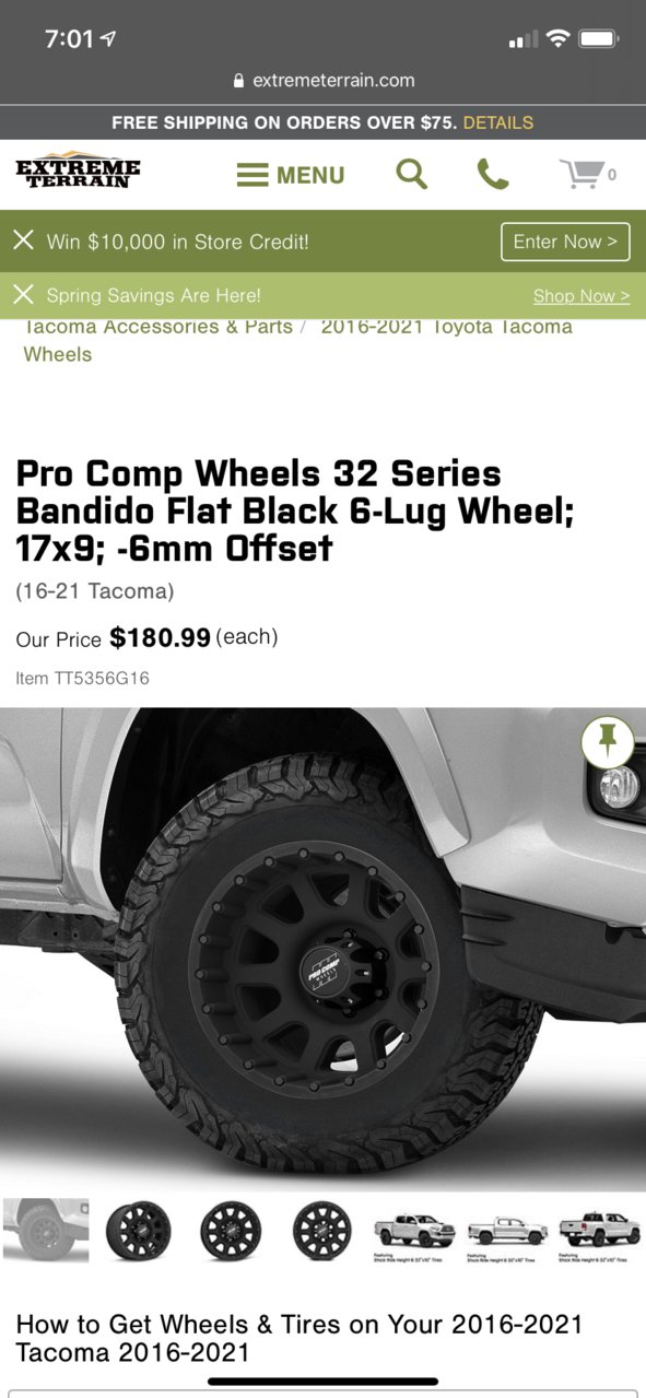

    Link to wheel?

    Pro Comp Wheels 32 Series Bandido Flat Black 6-Lug Wheel; 17x9; -6mm Offset

    did you win the 10k in store credit?:D

    They do not appear to be mag seat wheels. The part I don’t like is the hub bore is 130.81 eeeh!!! My bad they come in a 108 hub bore for the Tacoma you may want some of the hub rings to correct down to 106.1 should you have a vibration issue. Just incase hopefully you don’t need them.

    Someone correct me if the hub is not 106.1 on the 3rd gens.

    Toyota literature states it's "106.1 nominal".
    106 is gtg.
