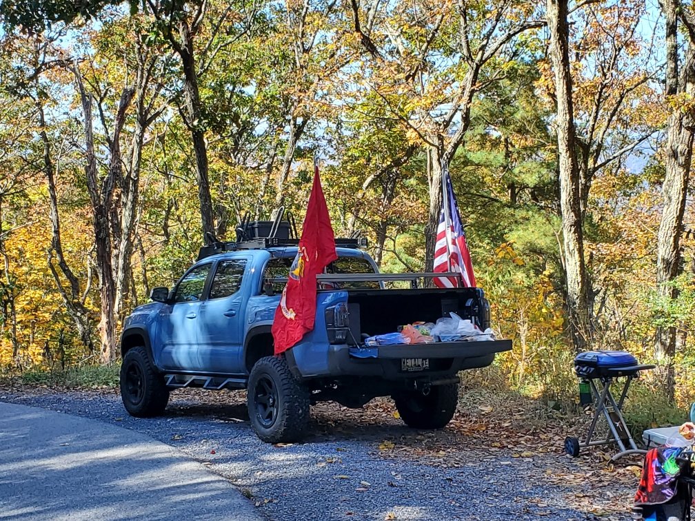

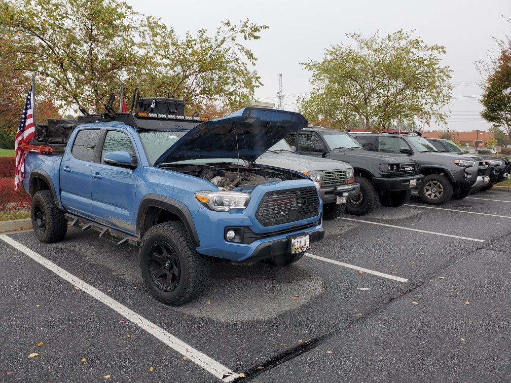

  5. Nov 2, 2020 at 10:03 AM
    #25
    jwizzmasterwet
    jwizzmasterwet 2019 TRD OR Cavalry Blue #SUPERCHARGED #METALAF
    Mar 28, 2019
    #288260
    521
    Joseph
    Maryland
    2019 Cavalry Blue TRD Off-Road #SUPERCHARGED
    INSTAGRAM: JWIZZMASTERWET #SUPERCHARGED #METALAF #HARAMBE PERFORMANCE/FUNCTIONAL UPGRADES: -URD Supercharger -Sound Deadened cabin with Noico Solutions 80mil -Skar Audio full pro-audio setup (2xtweeters, 4xmids, 3x10inSUB) SUSPENSION/LIFT/TIRES: -ICON Stage 4 (650lb coils) -ICON RXT Leaf Pack (Option 3), -285/65/18 BFG KO2 FUNCTIONAL(eye candy?): -Rave OffRoad roof rack -Rave OffRoad 43in light bar (amber + white) -Rigid led PODs (x4) (mounted along roof rack) -Westin Side Steps -BakFlip tri-fold tonneau cover -VOODOO Fabrications hi-rise crossbars -Pelican Case loaded with recovery gear(mounted to roof rack) -Smittybilt gen 2 overlander tent -Smittybilt recovery boards -HI-Lift Jack COSMETIC AND NON-PERFORMANCE UPGRADES: -Custom front grill -Bumper Shellz rear bumber cover -Meso Customs full interior chrome delete -Interior of cabin lined with sound deadening material (Noico Solutions 80mil) -Rear seat delete and custom shelf (home-made) AUDIO (SKAR AUDIO): -2x pro audio tweeters, 4x pro audio mids, 3x 10in subwoofers (SKAR AUDIO) -1x RP-1200 amplifier (mids), 1x RP-2000 amplifier (subs), 1x SK-400 amplifier (tweeters) (SKAR AUDIO) -Audio crossover
    This is my full load (a bunch of gear in the bed also) and I'm getting about 15-16mpg also. As long as you get a proper suspension, wheel/tire, and rack setup MPG will only slightly be affected!
