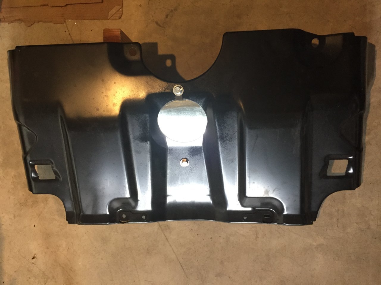

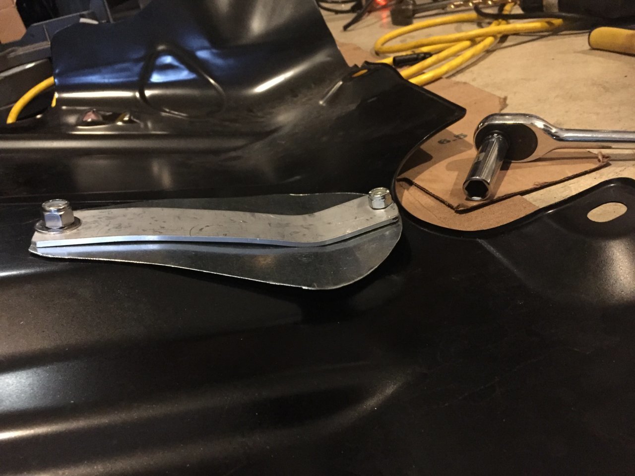

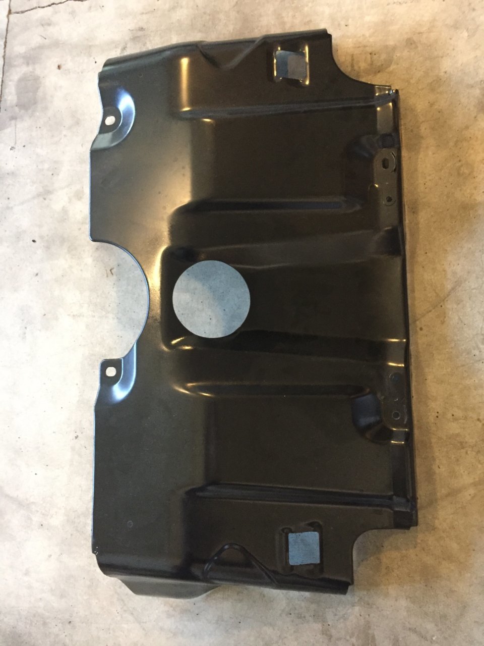

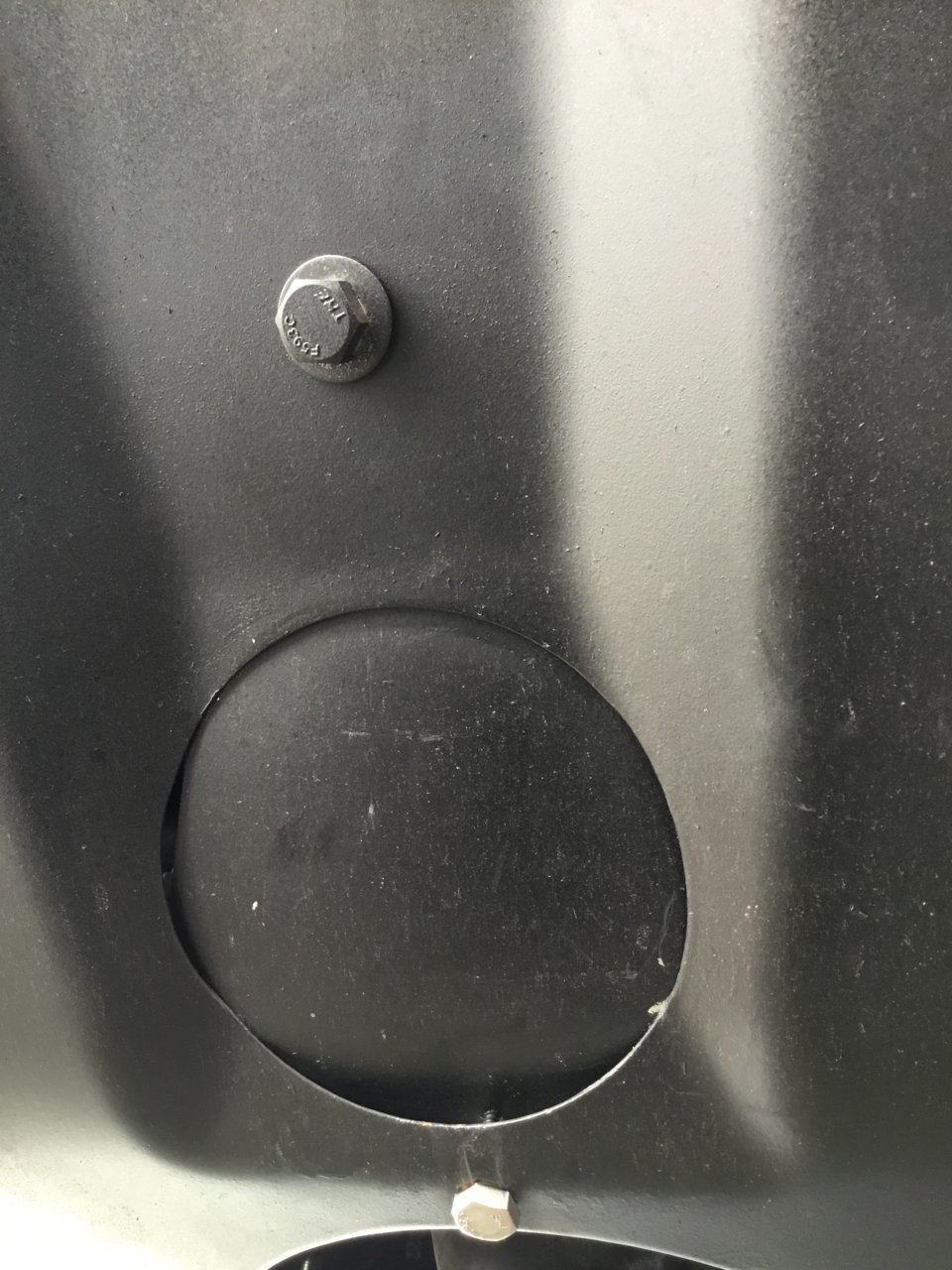

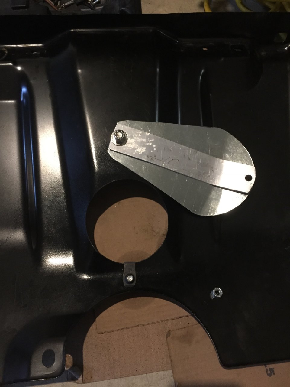

    Use hole saw.
    Make cover with scrap in garage.
    Doesn’t rattle and stays closed even when using just the one hinge bolt.
    Stock pebble deflector plates can be purchased on Craigslist for cheap.
