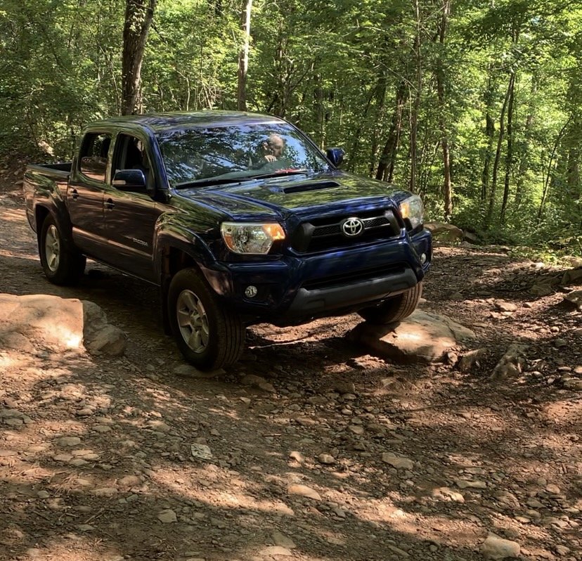

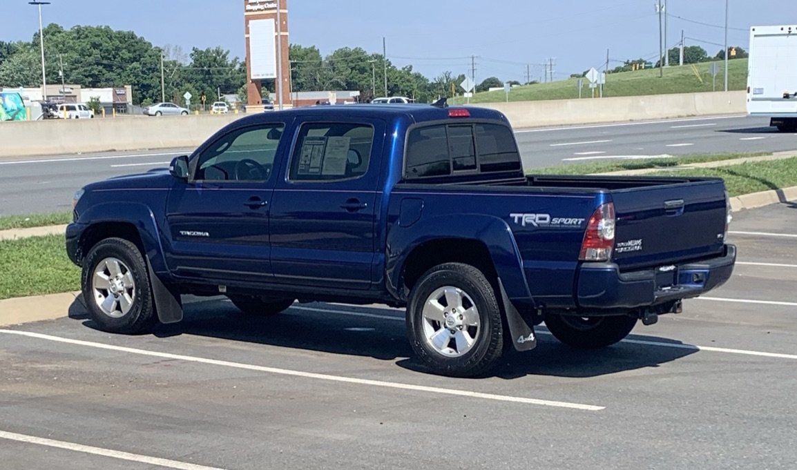

    Here is my new (to me) 2015 DCSB. She is completely stock and in great condition.
    I went to Uwharrie OHV (North Carolina) and spent about half of the day on the easy and moderate trails. I was super impressed with how capable this truck was from the factory!
