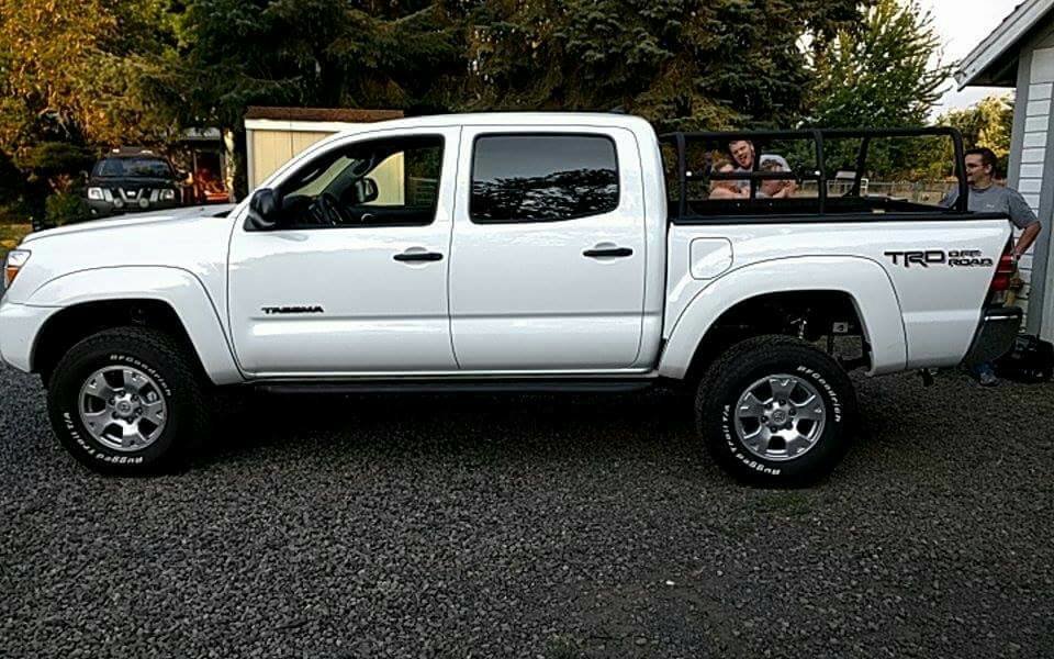

    I know all trucks are different but does anyone have a base line I could work with? I just lifted my rig and forgot to measure before (doh) and curious how much I need to adjust the front coilovers. Installed a Icon stage 4 with Dakar leafs. Setting at 36in up from and 39 1/2in in the rear unloaded.
    2015 DCSB OR
    As you can see I have a pretty good rake!
    Thanks!

    I was at 20" front and 22" rear hub to fender pre lift. '13 SR5 4x4. I doubt if there is any difference between the stock ride heights of the different packages. Not sure if you're 4x4, but I would assume pre runners sit a tad higher up front. Again, just assuming

    Looks like you gained 2" front and 3" back. Measuring hub to fender rather than ground to fender takes out the variable of different tire sizes. I'm pretty sure icon coil overs are adjustable. If so you can raise them up if you don't want so much rake.
