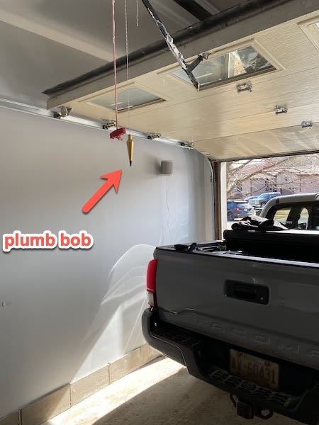

    First, note that my truck is a 2018 TRD Sport manual transmission dual cab short bed. It's an unusual configuration, has 17" wheels from the factory and mine is running on aftermarket winter tires (265/65R17 Blizzak DM-V2). The winter tires are the same nominal size as the factory-supplied all-season tires where I am in Canada.
    My static measurement was 1814 mm on the winter wheels, or in the 1811 range if I take into account where the plumb bob ended up. I have a set of 265/70R17 KO2s on TRD Pro rims that will raise the truck a nominal 11.6mm in the summer.
    In the end, because 6 feet is about 1828 mm, I would have only 14 mm of nominal clearance. Because the dynamic envelope goes higher than the static measurement, it would be a really bad idea to drive into a garage advertised as having 6 feet of clearance. You might be okay, but you might have a really bad day when you tag the overhead sewer pipe.
    I measured using this method:
    1. Back truck into garage, suspend plumb bob over shark fin antenna to locate where to suspend plumb bob. I made a mark on the horizontal member of the garage door opener.
    2. Drive truck out of garage.
    3. Mount plumb bob, lower it to ground and make an aiming mark.
    4. Back truck into garage, suspend plumb bob from the mark. I ended up about 3 mm above the shark fin, see picture.
    5. Drive truck out of garage.
    6. Use Bosch laser measuring tool to find distance between tip of plumb bob and the mark I made on the floor.
    Laser tool shows 1814 mm. Claimed accuracy is around +/- 2mm.

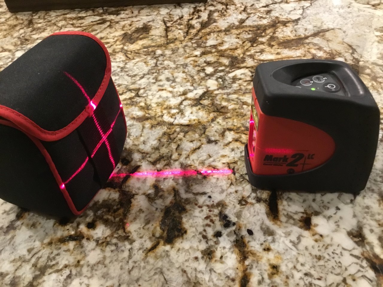

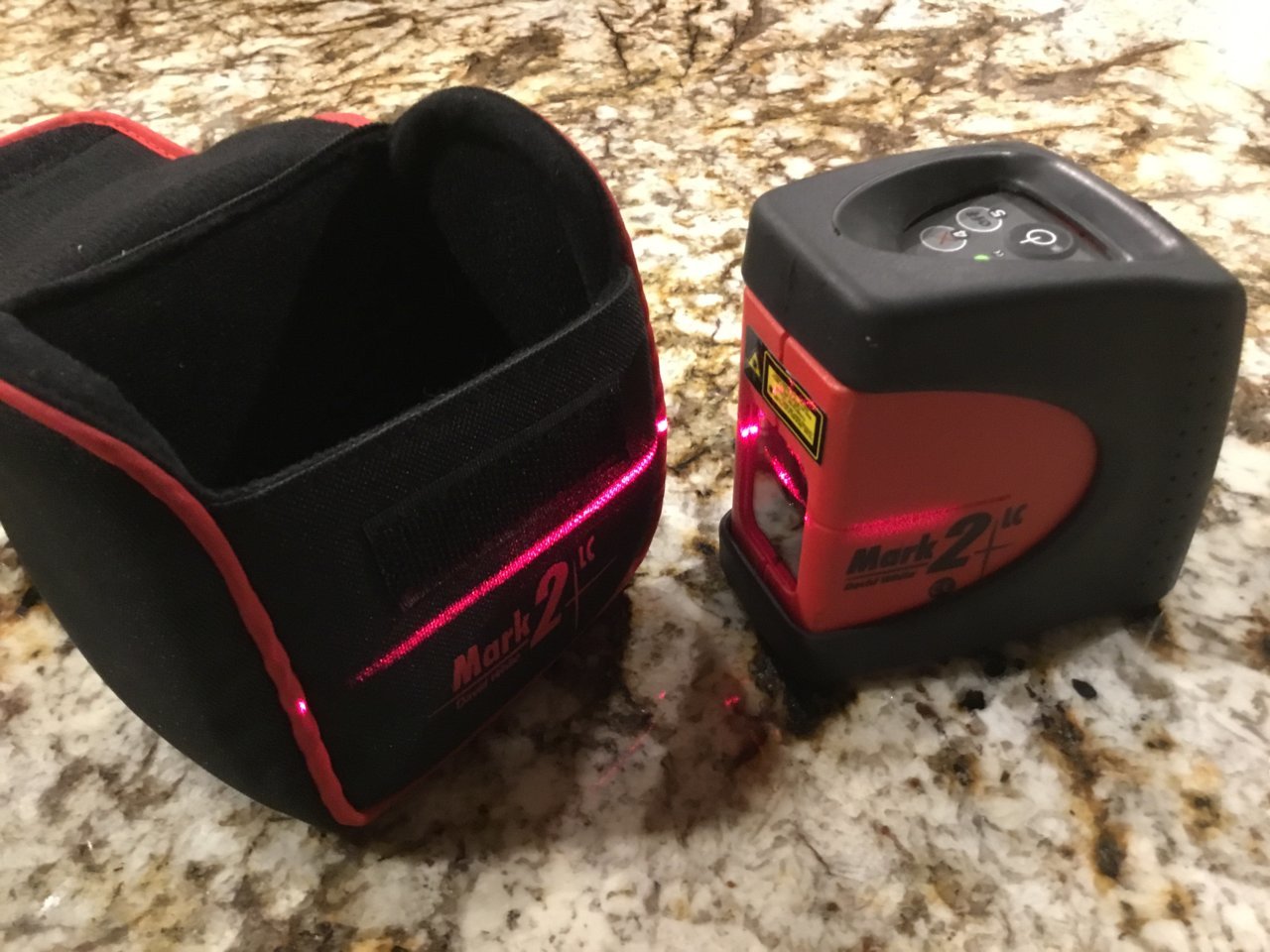

    Set one of these laser levels on a ladder or shelf and position it so that the laser line is touching the top of the shark fin.
    Measure from the ground to laser line using a tape measure.
    You’re done.
    Fast, simple, easy, accurate.6DDDA5F4-F4E1-47A8-ACB6-B1FCFCC5BD80.jpgABE8DF74-0430-475F-B600-7125EF1FFE22.jpg
