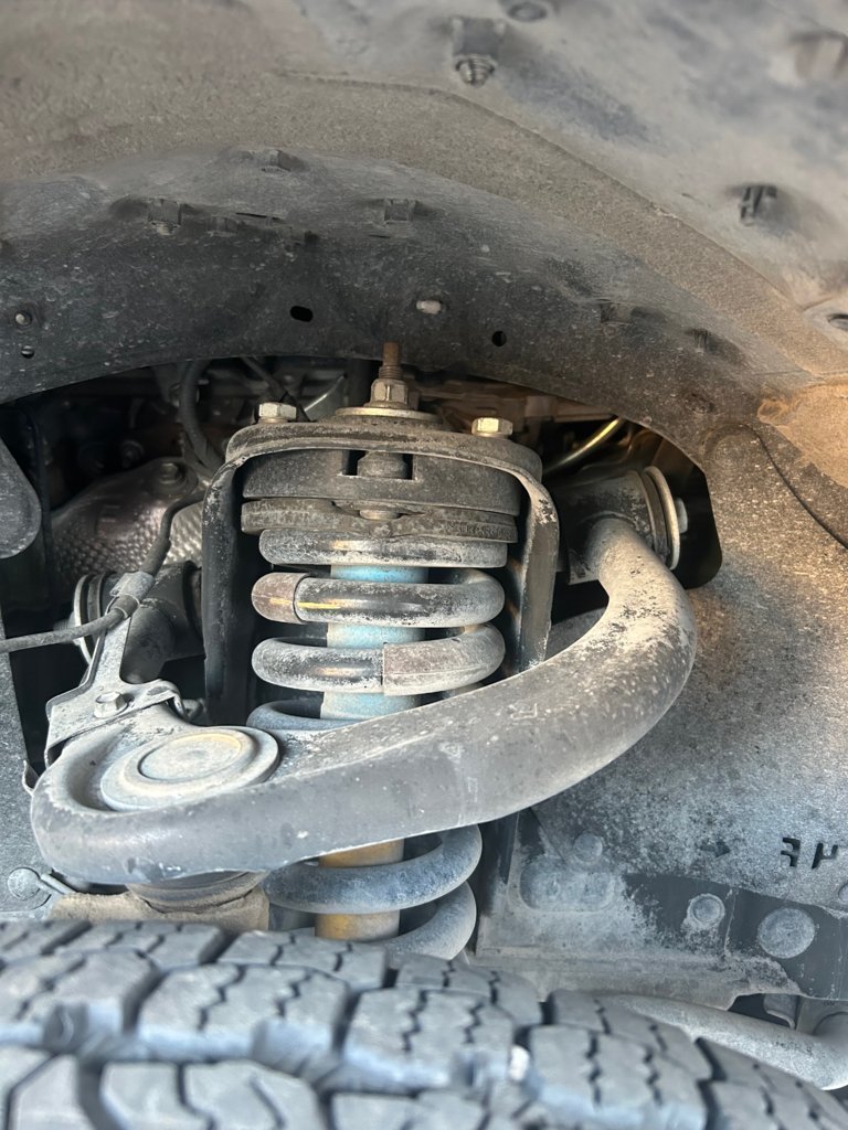

    Here is a pic of the front shocks, it has a spacer not sure if it is factory or not. Either way some rear springs might be in order.

    Looks like a spacer lift. If you want the lift but the rear to sit higher you have a few options
    You can get an add a leaf which will give you lift and more load capacity but harsher ride empty.
    A new lift leaf pack
    or put an inch lift block on the stock leaf springs

    Can I still use the shocks or will I need new ones if I add a block?

    If you add a 1' block you can use the factory shocks.
