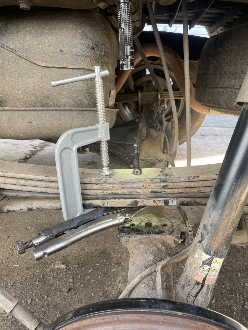

    Here ya go…
    Oh, and thanks for making me look… found this new gem…
    yup, that’s a crappy chinezium wrench. Would love if it was a lifetime brand.

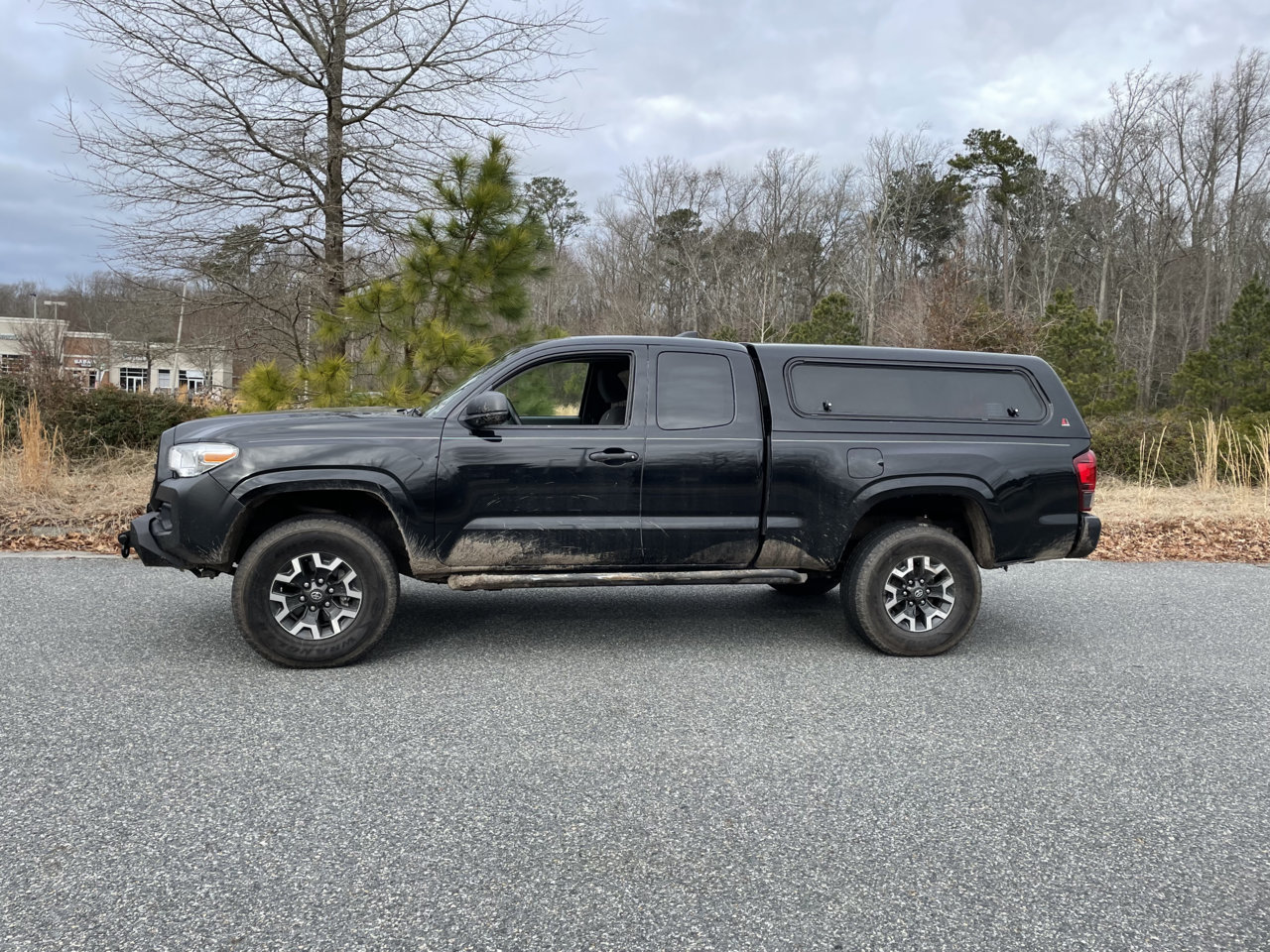

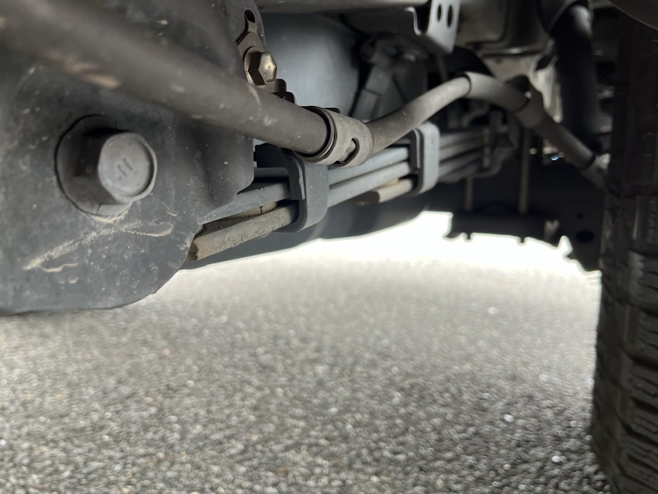

    .so I have a fiberglass camper shell, decked, and about 250 pounds of tools inside the decked. Around 700 ish pounds. I went with wheelers 1.5 aal and bilstein 5100s. Directly after the lift I netted 2 inches. Last pic shows it with the aal and bed loaded with everything. It looks stock to me, slight rear rake (which is what a truck is supposed to have). Ride quality hasn’t changed. It’s either the same or slightly better. It was like $300 for the aal and shocks.

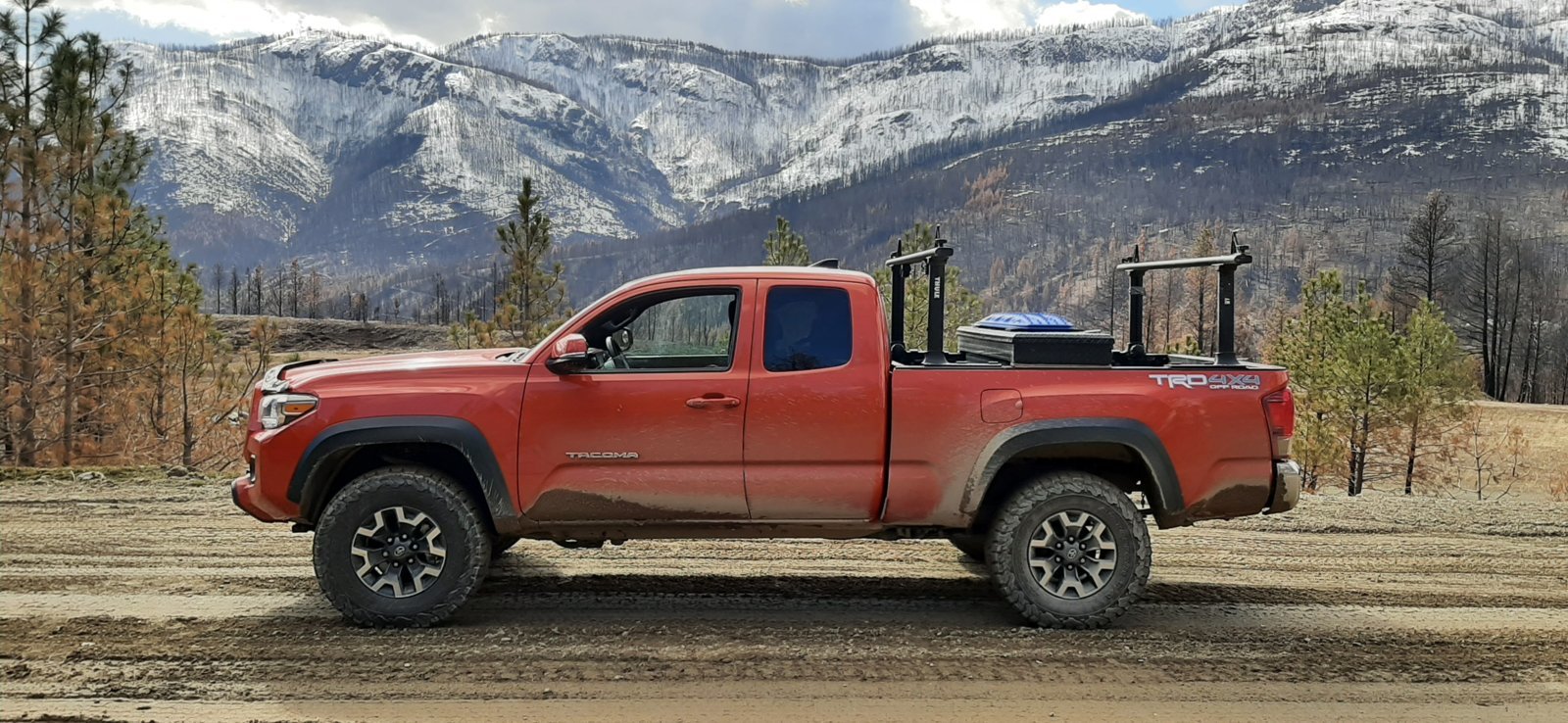

    Just added toolbox and roof-rack to haul my fishing boat 100's of miles into the backwoods every week. Goodrich K02s, Bilstein 5100 front and back, no lift.
    Funny no one ever mentions air bags.
    I am off road every week. I often have 800-1000 pounds in the back for longer camping trips.
    Bilstein 5100, no lift.
    If I put 800 pounds in the back, with the Firestone air bags I can get the ass end to sit up 1.5 inches higher than this photo. In the photo, the air bags are only at 18psi with max capacity at 150psi. I often raise the back end a lot as I am mostly on deactivated trails with a lot of bumper dragging through deep washouts.
    Even with 800 pounds, I have never needed to inflate them past 35psi.
    The unexpected bonus from the air bags was the major improvement in grip on corners. Prior to the air bags, the rear end would always lose it on loose gravel or even wet pavement when trying to turn into traffic. The air bags eliminated 90% of that issue.
    Also, it drives much more securely at highway speeds. Prior to the air bags, I never felt safe in this truck going over 65mph. Too much wandering and instability. Now it is rock solid at highway speeds.
