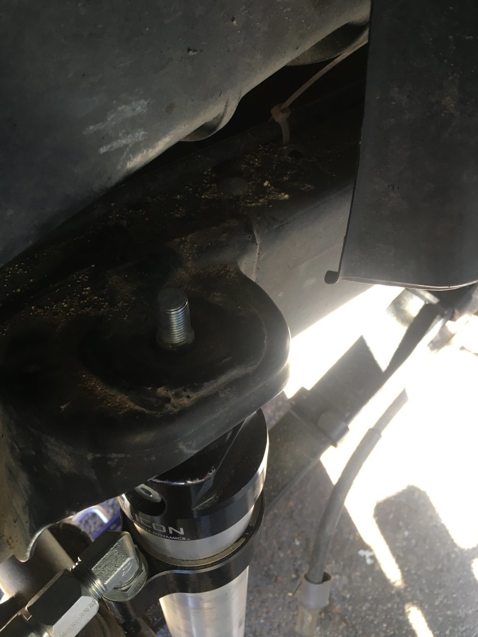

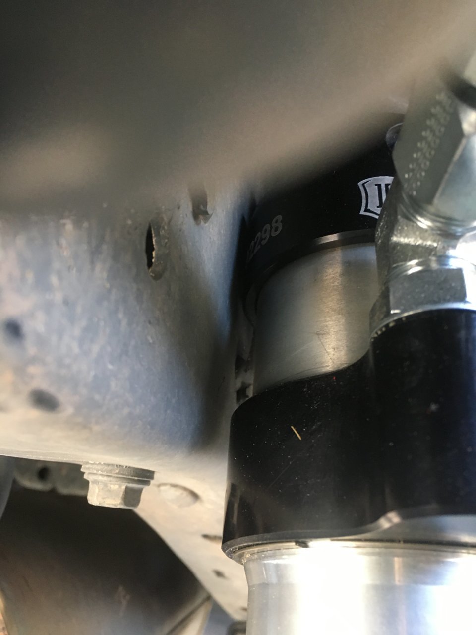

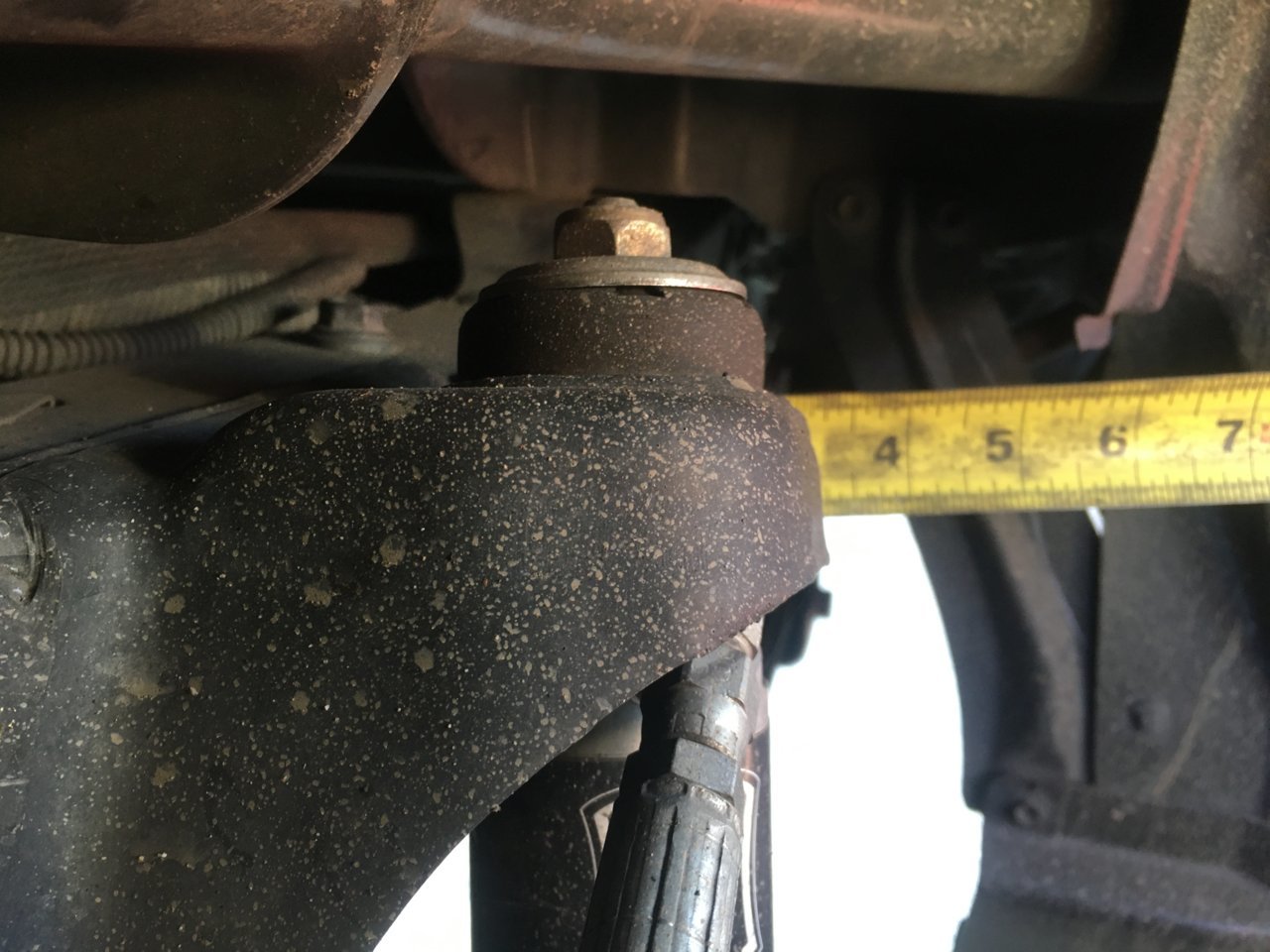

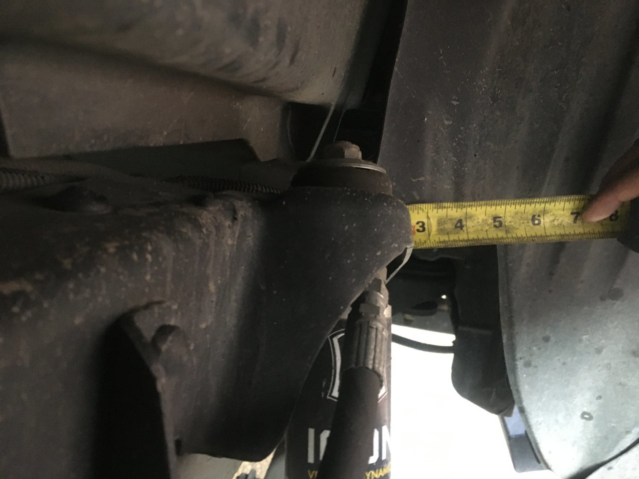

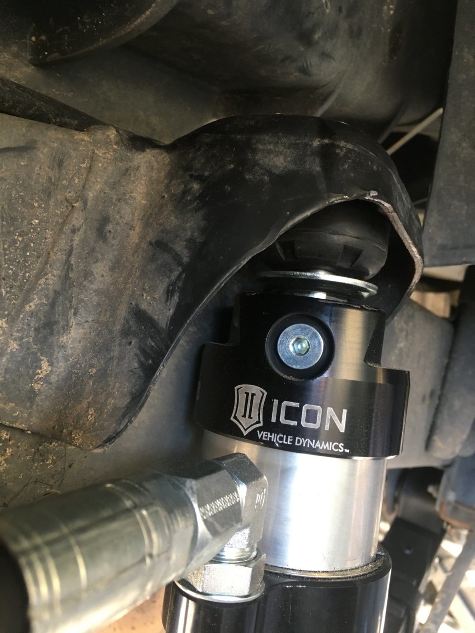

    Ok. Got a new one that had me scratching my head. Has anyone noticed that the stock rear shock towers are different sizes on the driver and passenger sides for 2nd gens? I was installing Icon 2.5 rear shocks on @the dashing ham ’s 2012 today and the shock fit fine on the drivers side but would not fit on the passengers side. After some back and forth I verified that both shocks were the same and the part number was indeed for a 2nd gen Tacoma but the old tape measure told me what was wrong. The shock tower on the drivers side sticks out about an inch more than the passenger side which in turn moves the mounting hole for the top stem outward on the drivers side (or inward in the passengers side). The 2.5” shock body would make contact with the frame and not allow the top bushing to seat all the way. The drivers side shop went in just fine as expected. At first I though something must’ve happened to his truck for this abnormality but I verified on mine (2015) and it was the same.
    Didn’t see anything on Icons website that even mentioned the difference.
    Has anyone noticed this before? Any known workarounds to install 2.5 shocks in the stock location? I can fav something up but just trying to gauge what other have done before I start cutting and welding.
    pics of passengers side:
    pics with measurements for comparisons (and 2.0 shocks).
    passenger:
    driver:

    2015 prerunner. Verified approximately 1” difference.
