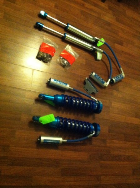

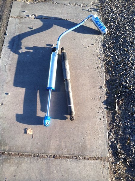

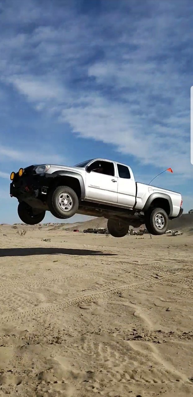

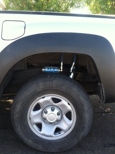

    One the best days of my life was after two years of offroading/adventuring on the stock black shocks I pulled the trigger on a set of OEM kings in 2015. I put them on with my 245/75/16 dunlops w/steelies no armor or other mods for a few years. I thought I was badass and felt like king of the sand doing all kinda hood rat stuff with friends in the desert. image (19).jpg

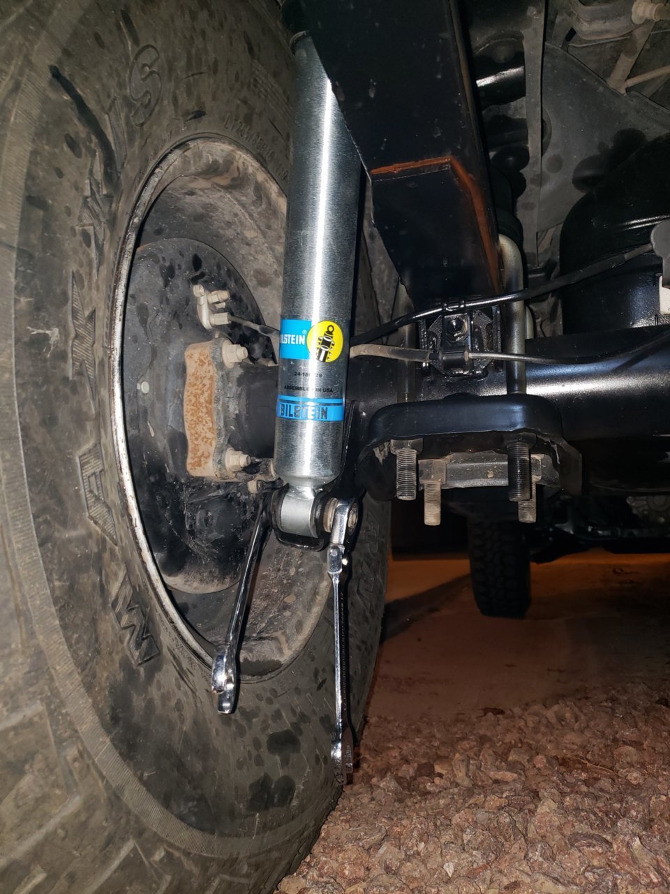

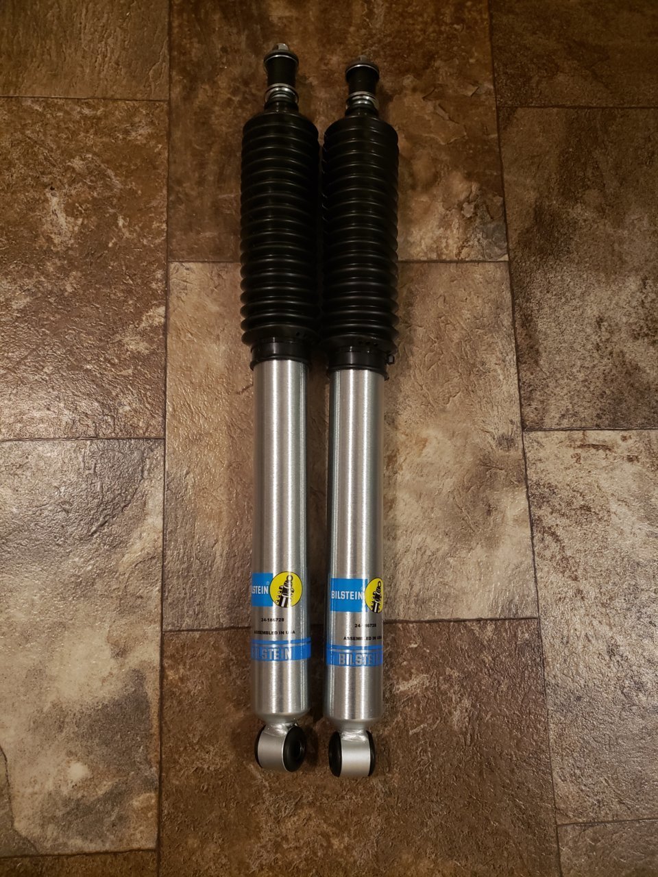

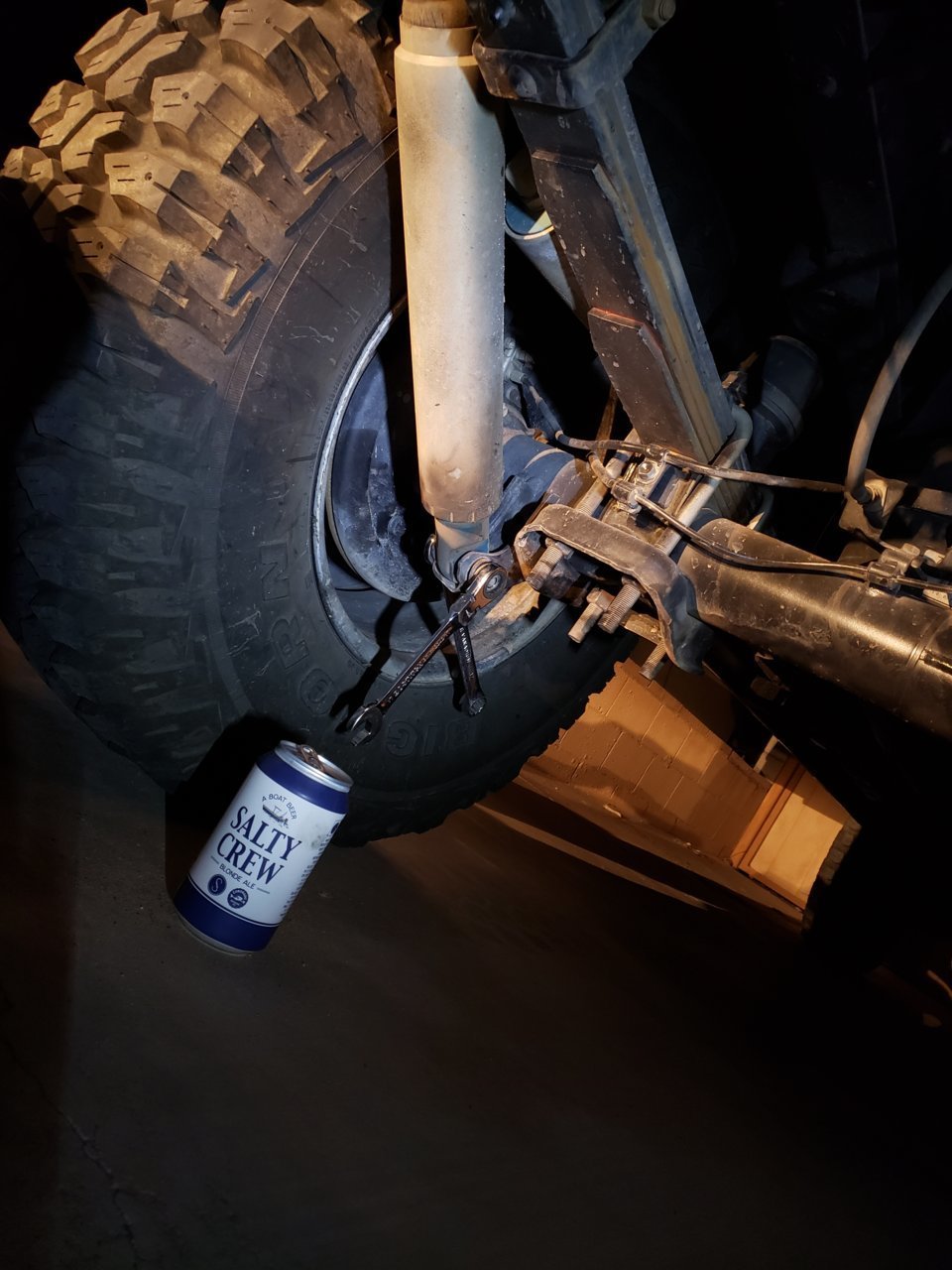

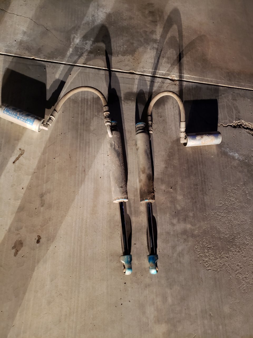

    Pulled off the kings after about 50k over 4yrs to send out to @desertjunkie760 for a much needed rebuild
    Put bilstein 5100s in the rear temporarily until the kings comeback

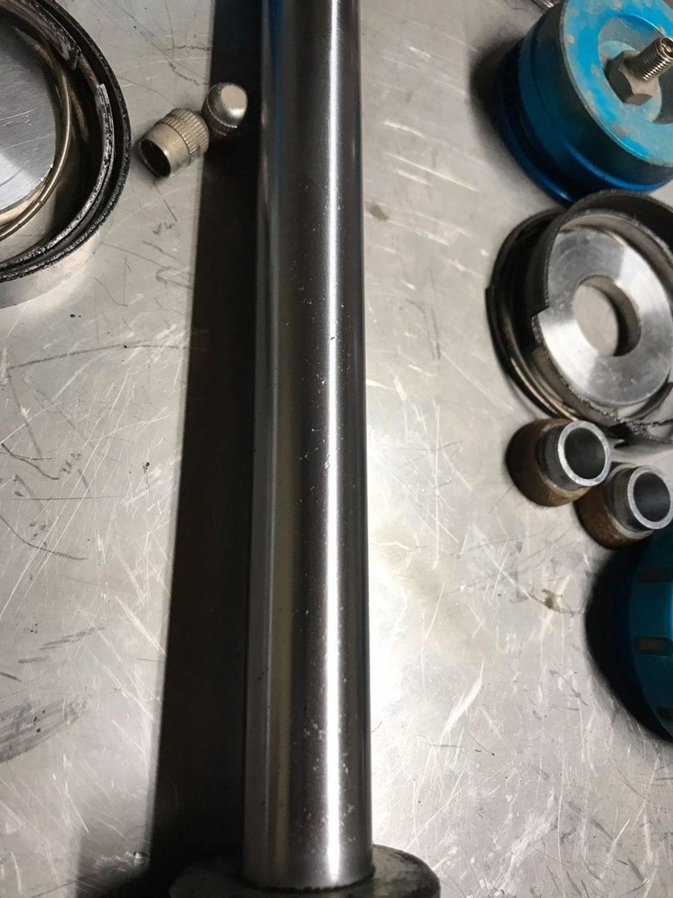

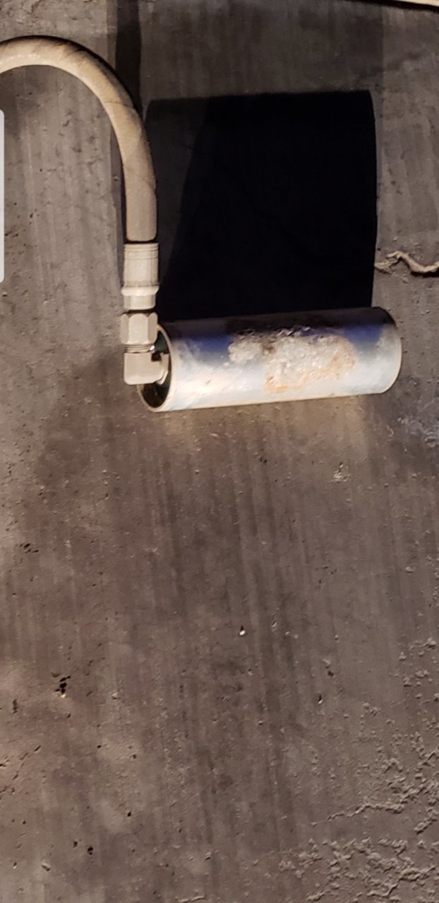

    Good Bad and the Ugly
    Valving intact and not bent up
    Shafts need to be replaced from pitting
    One remote resi caught corrosion
    Shocks oil burnt AF
    They ain't near as shinny and pretty as when I bought them
    King shocks stickers sand blasted off

    So to compare worn kings to bilstein 5100s. The bilstein 5100s compression is garbage compared to the worn kings. I would bottom out 1/3 of the speed I was going on the same whoop/washboard sections as on the worn out kings. Rebound on the 5100s not terrible and manageable with cutting angles across terrain. Road manners really good super smooth with no porpoising. Would recommend this as a good budget or in between rebuild shocks for rear end. Will get the job done but not much more than basics.
