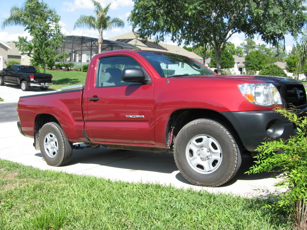

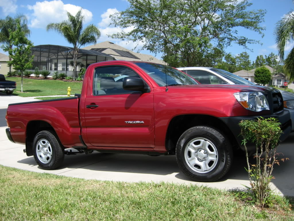

    Before:
    After: Yokohama Geolander 235/75R15
    I did the black box mod, but I am pretty sure it was not necessary.

    Did u get a lift too?? Or jus bought bigger tires?? Jus got my new truck want to buy correct size of tire to get ur look on urs it's 235/70/15 on ur after picture right?

    I do not have a lift. The LT235/75R15 fit without any modifications, however i did do the black box mod before the tires were put on, thinking that i would need the extra clearance. I love my Yokohama tires, but i don't do any real offroading or anything. I noticed the ride was a little stiffer and i think it is because the tires are "LT" rated and not "P" like the stock tires are. The "LT" have a stiffer sidewall and are for light trucks, i believe. Someone can correct me if I am wrong about that.
