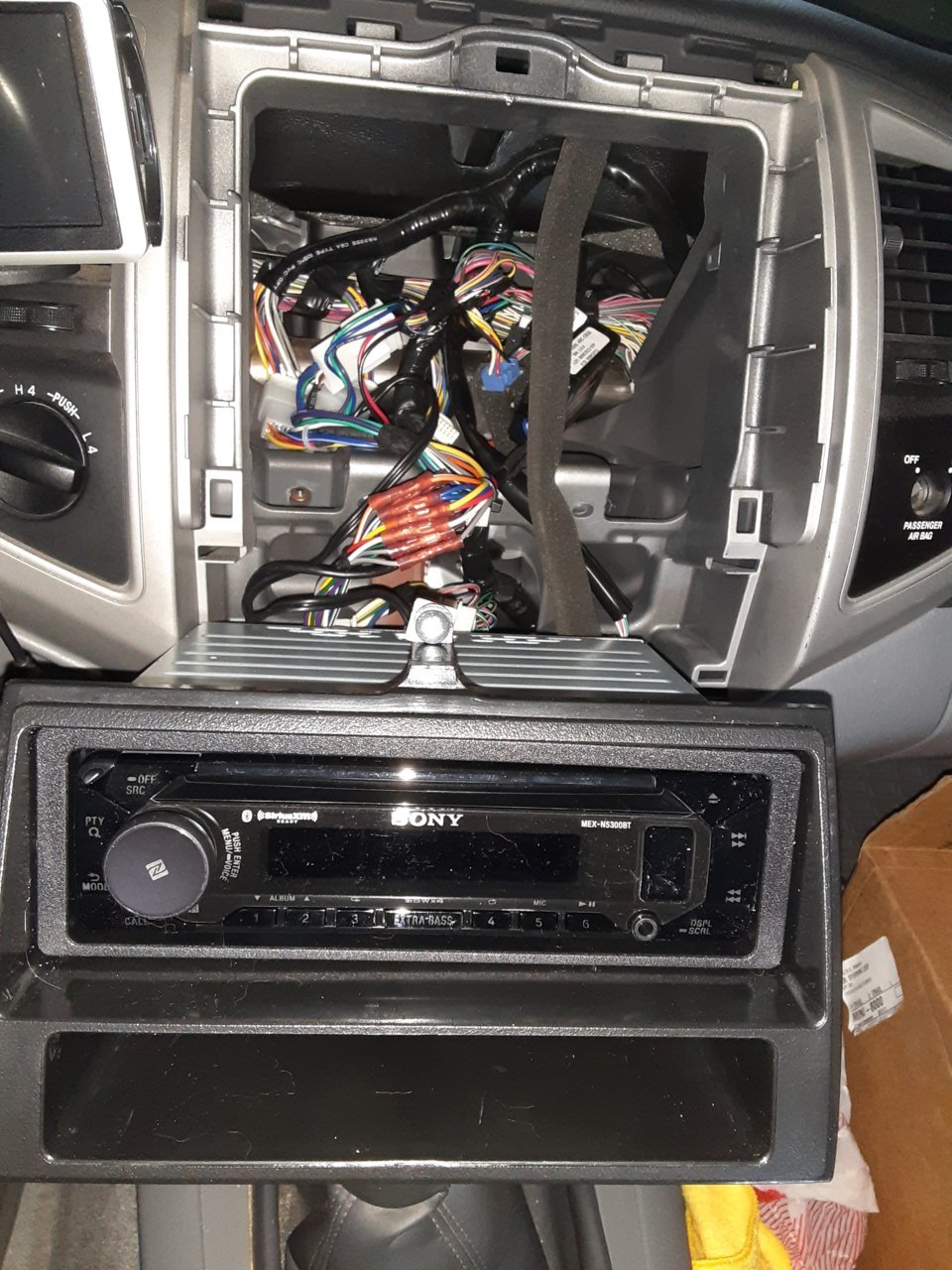

    Don’t bother trying to diag or repair.
    Replace the radio.
    One of many common problems with these early stock radios.
    Myself, went through three before l just got a aftermarket unit.
    It’s internal...
