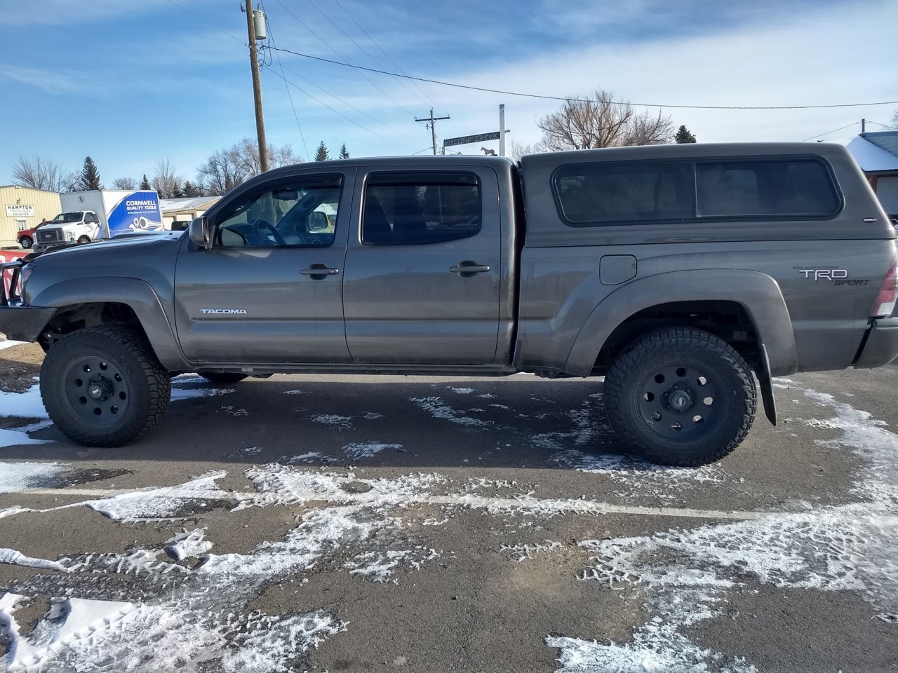

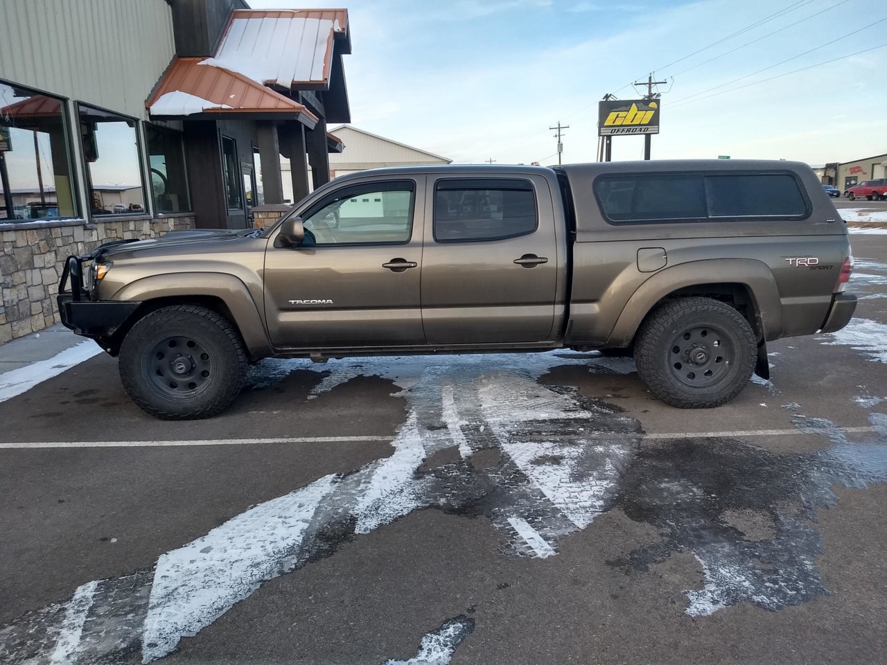

    I have the same size of tires but Falken Wildpeaks and with my stock suspension I had to take the mudflaps of and I had a little bit of rubbing when I was turning and going over a bump. But I just got on an OME 2.5" lift and that all went away and mudflaps are back on now too. No issues.

    @Ejburk1981 Yeah I have a buddy that has the same lift and runs stock size tires and really has had no issues on the Forest Roads and stuff out here. I got mine from Headstrong Offroad for a little over $900. If you want to get one I would definitely recommend contacting them. They'll lead you in the right direction for what you want.

    Looks sick!
