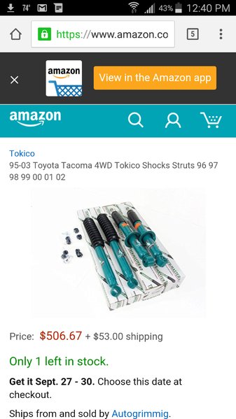

    Son of a gun, Tokico does have a front rear package for the first gen. I'd love to hear some reviews of it.

    good call, i need to change them out, but just havent had time to get around to it. I too would be interested in hearing some of the reviews. Personally, i will be upgrading to 5100s, at least, but most likely kings when i change mine out finally.
