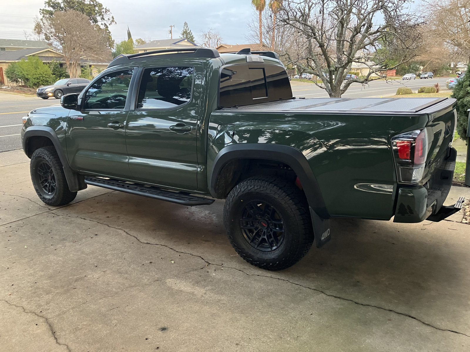

    Running 265/75R16 which is about the same diameter of tire, just different wheel size. On TRD pro 16" rims I think the offset is around +13, which allows the tires to clear the front mud flaps even when turned and full stuffed upwards into the suspension (which I have definitely managed to do turning around on tight trails several times). Lift is about 2" but that's basically irrelevant when considering potential front tire rubbing at full upwards suspension articulation and max wheel over. Most of the stuff I see where rubbing was encountered seems to involve near zero or negative offset wheels that cause increase the scrubbing radius and chance for rubbing when turning.
