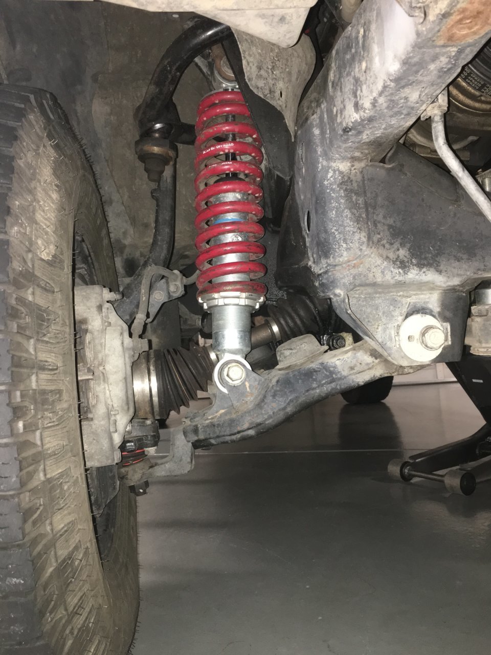

    Anyone have the hub to fender measurement for a stock first gen? I have an adjustable 0-3in lift on my taco via all pro adjustable coil overs and I blew the boot on one of my brand new cv boots in less than 2000 miles. I feel like im too high, but don't know if I am or not. I have looked at the threads and still dont feel i have a concrete answer. Also i do have a diff drop installed. Im try to get to a 3 in lift based off the stock height so i dont blow another boot.

    got a pic of your CV angle? I think all pro (I'm sure others do too) make a "high angle" CV boot. Might also call All Pro and see if they can give you a measurement for where the coil adjuster should be for a max 3".
    I used to have a couple pics with a tape measure I took before I installed my 5100s many moons and 3 phones ago, but can't for the life of me find them.
    Here you can kinda see my CV angle, but this is only set to like 2" or maybe less. Like you, I really don't have a clue what the exact "lift" is. I have a diff drop, too.

    Yeah that looked like way too much in your pic. That upper ball joint looks like it wants to die.
