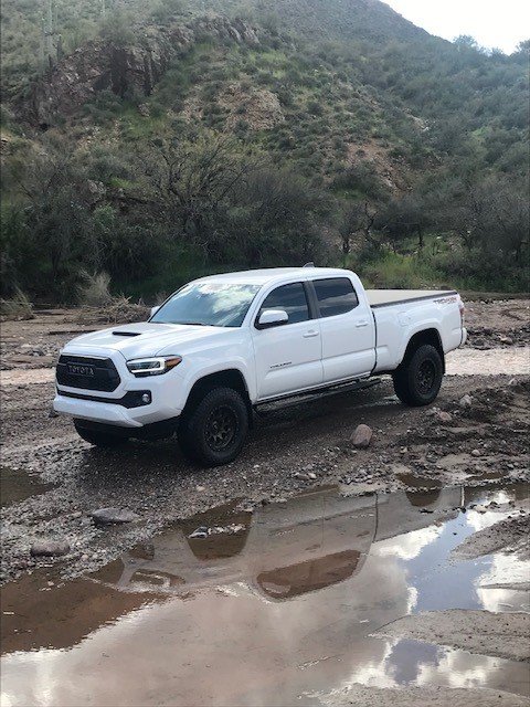

    2023 Lunar Rock Tacoma TRD Sport 4x4
    2023 TRD Sport 4x4, stock - no lift
    4Runner TRD SEMA wheels - 17x7 +04, Falken Wildpeak AT3W - 265/70 R17
    Minor rubbing when turning and hitting bumps

    Is it rubbing on the OEM mud flaps?
    If so, replace em with some generic flat ones. I have an OR with RokBlokz and stock suspension without any rubbing at all.
    I wonder if the Falkens are a bit taller than General ATX…
    Truck looks good though!

    Yes. Thanks. I will check it out.

    Try and remove them first. See if that makes any diff.

    Removing the mud flaps should cure it. I have the same tires on mine with a 8.5 width -10 offset wheel. I needed to add 2" spacer lift to get rid of the rubbing w/o the mudflaps, but I put them back on and they hit whenever I am in a turn going over a bump, like entering a driveway, but I can live with that. I believe the wheel offset contributes more to the rubbing with this tire size that the tire size itself. You said you have a 7 width+4 offset wheel, so I'm betting the mudflaps are what its rubbing. I also had to cut off the corners on the front air dam as well but I don't think you'd have to do that.
    BTW, nice pic of your truck in the wash. Where is that?

    Road to Castle Hot Springs just northwest of Lake Pleasant. Nice, easy intro drive.

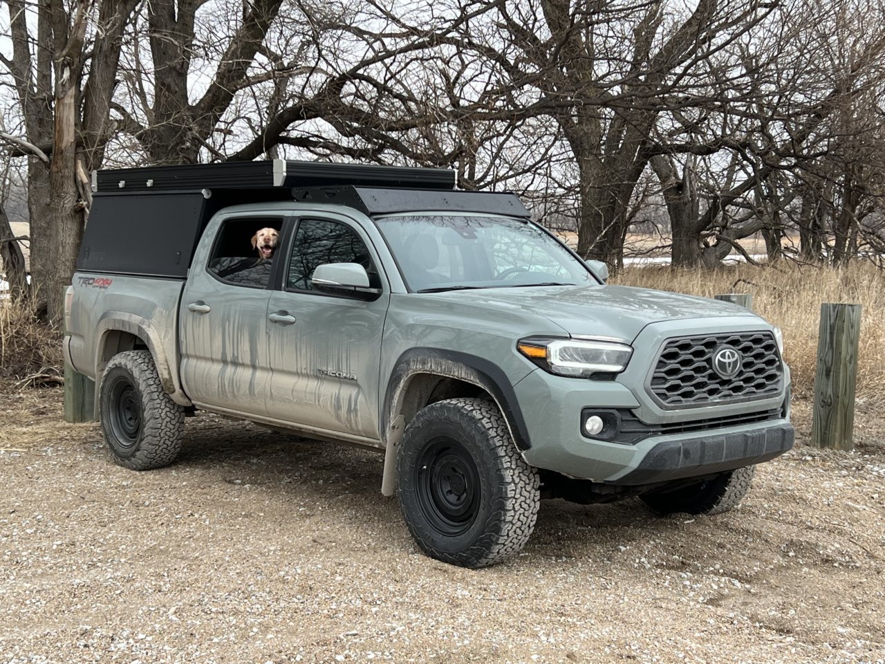

    265/70/17 installed this weekend. They do rub a lot on my Rekgen mudflaps so I might see what a heat gun can do.

    That good boy in the back is soooo stoked!!!

    Rubbing is surprising with the Rekgen mudflaps. I suspect your wheels have a more negative offset than my 17x7+4 wheels. I only had mild occasional rub with 265/70r17 on 17x7+4 wheels and OEM mud guards.

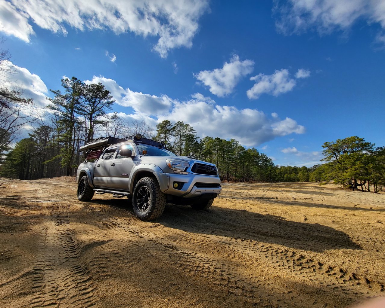

    74
    Silver Tacoma Double Cab
    None

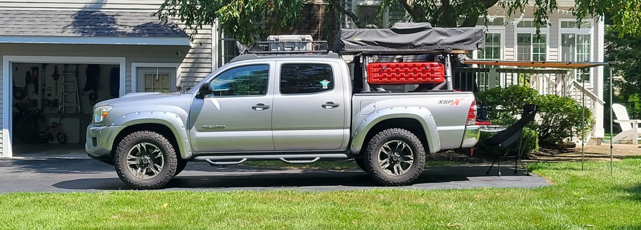

    No rubbing. Stock suspension with the Ultrawheels the XSPS came with.

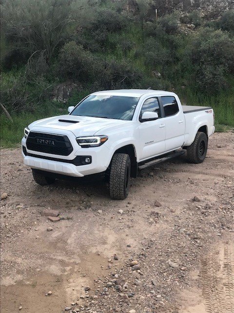

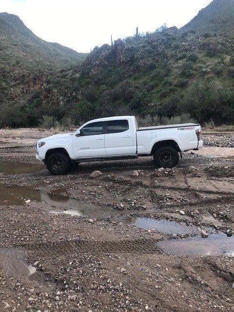

    Was out on Castle Hot Springs Road over the weekend. It was still pretty wet out there and a very fun drive through water etc!

    @jjsinaz great pics! Love the scenery, because its my back yard. Can't remember when we have had so much rain in the past. It is a desert right? Nice looking truck also!
