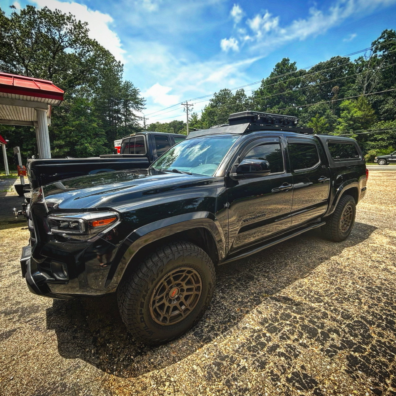

    My sr5 only had the front air damn, which they did rub a tiny bit at full lock so I removed it. Other than that, no issues since then for the last 7 months. Although I do plan on probably a 2” lift and going up slightly in tire size.
    Edit: my wheels are 17x8.5 et 0 so that does help gain a bit of clearance being pushed out further.

    are those the gunmetal or silver ones?

    Sweet truck!

    Thanks :cheers:

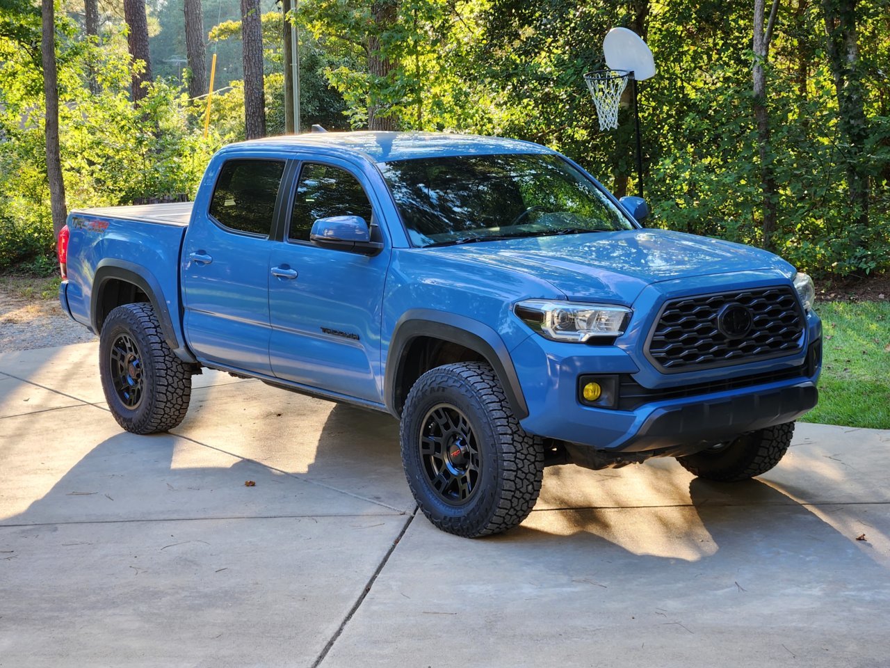

    Old thread but it helped me make the decision to not lift and go with the falken wildpeak at3w 265 70r17. Like almost everyone says, the tires look so much better in person. Only had them a few days but so far gas mileage looks the same, they ride really well(possibly slightly stiffer which I like) and are quite! I can have my music on the same volume as with the factory goodyear wranglers with 54k miles on them.

    That looks great brother. Glad your happy with them.

    Thanks! Oh yes I'm very happy with them. From all I've read I'm sure I will be happy for a while to come. Now if it would just snow this year lol.

    @CavalryTRD thanks for posting, the rig looks fantastic! It's great the tires are doing well for you. Did you remove the mud flaps for clearance?

    Thanks! No I didn't have factory mud flaps. No rubbing so far that I can tell. I have a drop off on my driveway where it goes from asphalt to crush n run so it can hit hard but I haven't noticed any scraping yet. I actually would like some oem mudflaps to help with rocks since these stick out farther than the OR rims.

    This setup will rub at least slightly with OEM mudflaps, almost guaranteed.

    I assumed I would have to do some trimming. I'd prefer oem but if someone makes aftermarket ones that are good I'd go with them too.

    Rock Blokz flaps solved my issue. Thread here: https://www.tacomaworld.com/threads/aftermarket-mud-flaps-to-eliminate-rubbing.803569/
    If you go that route definitely follow the instructions for providing the most clearance, it just involves trimming the flaps slightly along pre scored lines, and leaving off a spacer.
