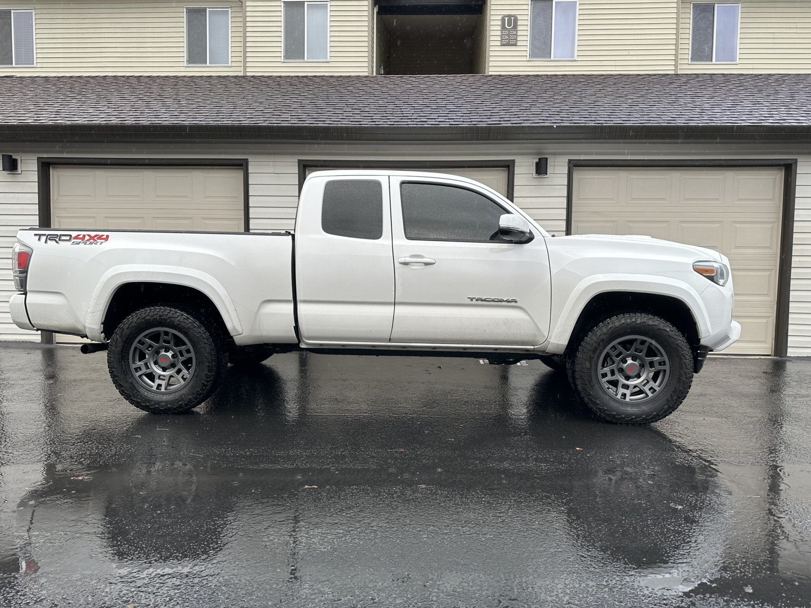

    Very nice! That’s what I’m after. I have 265/70/17wildpeaks already on. 17” pros in matte grey arriving this week. Will post pics after install

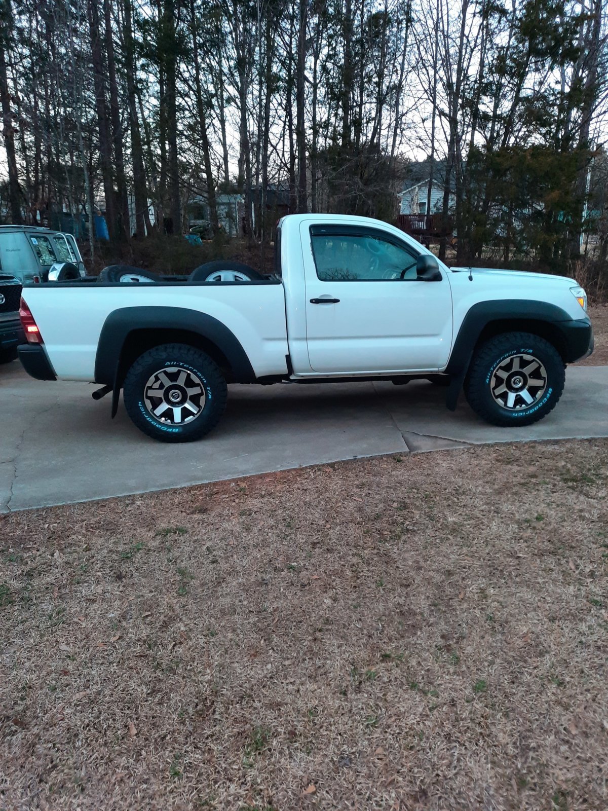

    #195473
    4,620
    Travis
    Easley, South Carolina
    2014 RC Taco 4wd

    Stock suspension
    265/70/17

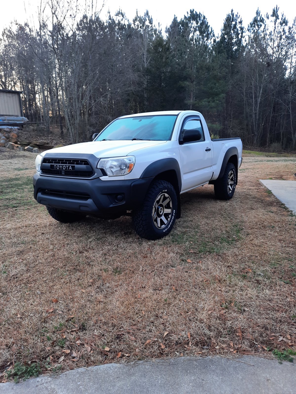

    No lift, had to trim and remove mud flap. 0 offset wheel 265-70/17.20231105_134435.jpg
