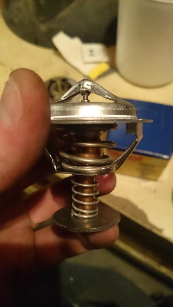

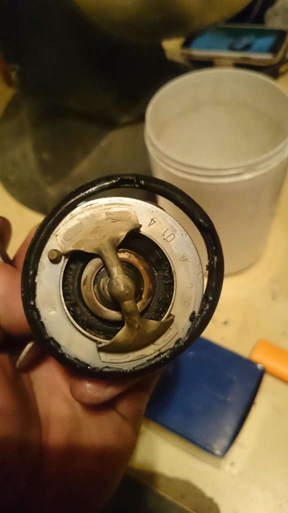

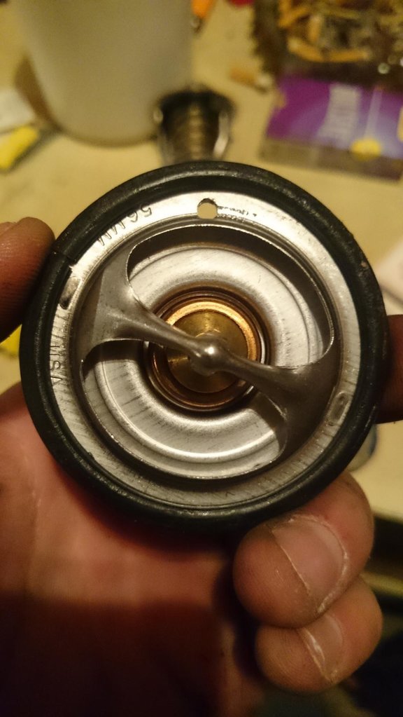

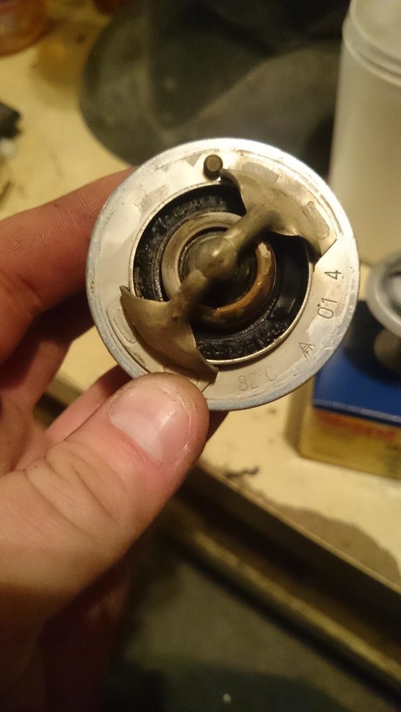

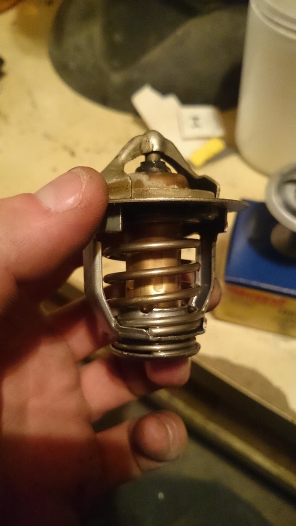

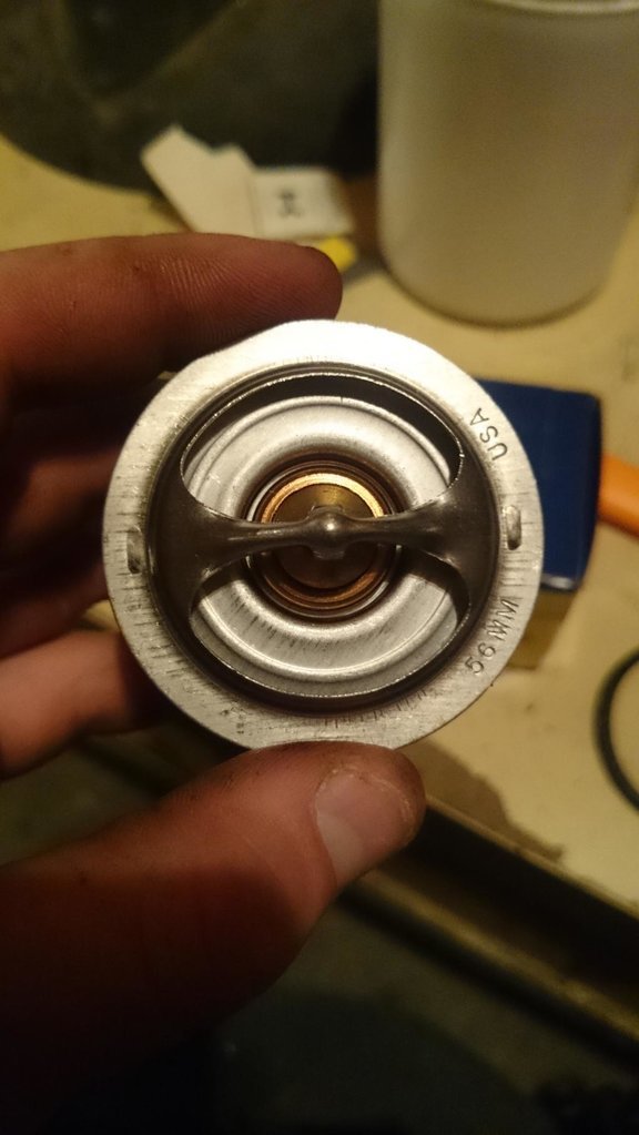

    Ok guys I'm changing my thermostat right now for the supercharger and they look quite a bit different. The stant doesn't have a jiggle valve and looks cheap compared to the stock one. Pics are below. Which way should I put the stant in??? Also it didn't Come with a rubber seal so I will reuse the stock one?

    You will want the jiggle valve, otherwise you will not be able to purge the system of air, possibly causing you overheating issues.

    if a part looks cheap then its made cheap and will work like a cheaply made part so get a genuine replacement, when it comes to a thermostat they last a long time and you want it to work reliably so its not a huge difference to get a quality oem replacement
    ps - you need the seal, that's what seals it to make it work correctly. without it the water just flows around it. its just deformed out of shape from being old.
    go to Toyota and get a oem replacement, it should come with the new rubber
