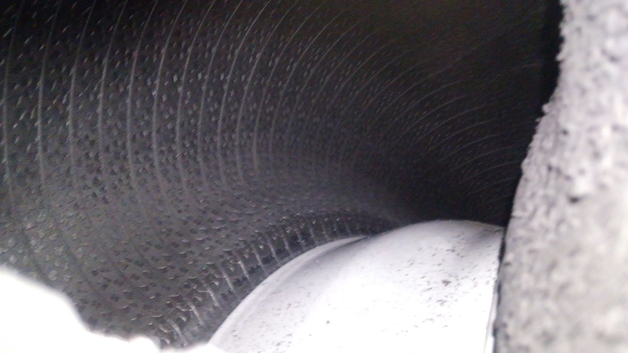

    Wondering if your tire was both slightly defective and possibly mounted wrong at the same time? When you get that off the wheel look and see if the major splice is near that failure. If not, that tire wasn’t properly mounted which might have contributed to that sidewall tearing like it did.

    It's still on the rim, so it's hard to tell. The tear is huge and sidewall bendy, so I just jammed my phone and a flashlight in there. Does this help tell anything?
    The little bits in the middle are tiny pieces of rubber. They're kinda stuck on there, not flaky.

    What is the major splice? Sorry, I'm not too familiar with tire tech.

    That’s the thickest part, and thus the heaviest part, of the tire. It’s where the rubber overlaps in the manufacturing process. The valve core is usually at the smallest diameter and the lightest part of the wheel, so for balance reasons the major splice is usually closely aligned with the valve stem.
    It might be marked with a sticker on the inside of the tire, or possibly with a dot of paint on the inside of the sidewall near the bead.

    Ok thanks. I'll check this when they remove the tire.
