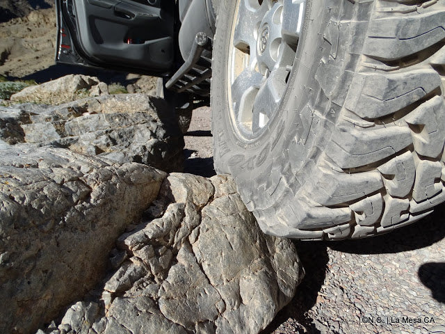

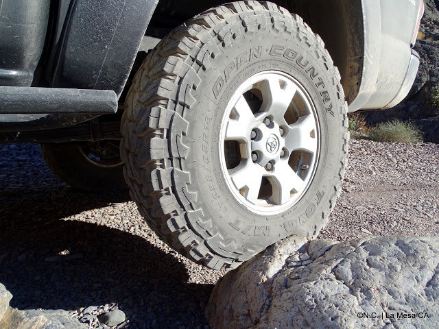

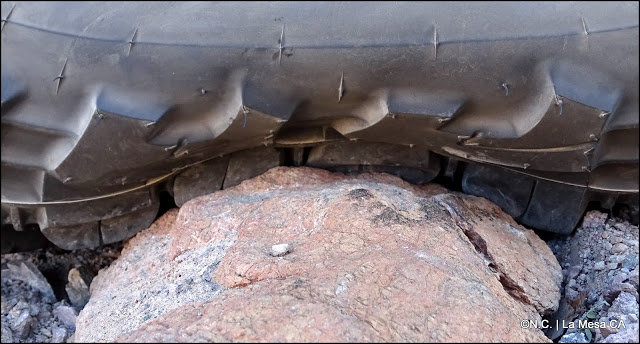

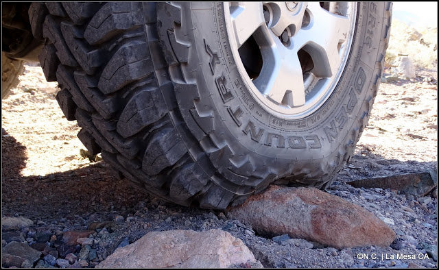

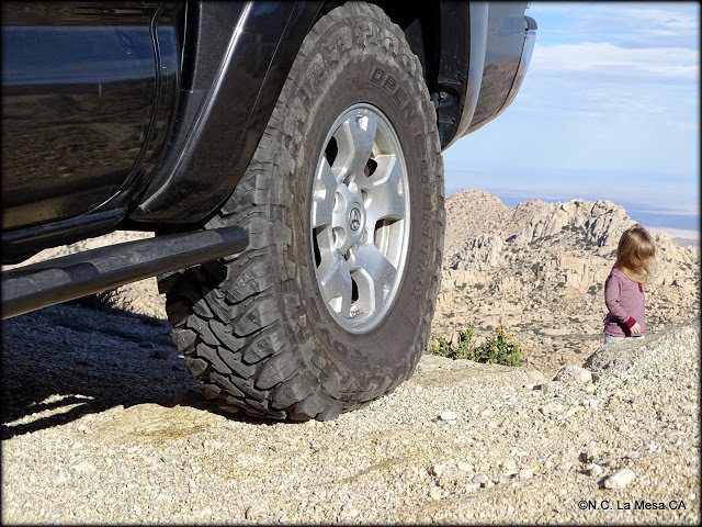

    For beach driving 12 is good. If I was going at speed for long periods of time though I may do higher PSI like 19
    Here is a small collection of my photos of my current tires at various pressures.
    Toyo Mud Terrain 255/85/R16 Load E
    12 PSI
    15 PSI
    @ 15 PSI and 40° angle!

    19 PSI
    19 PSI
    19 PSI
    19 PSI
