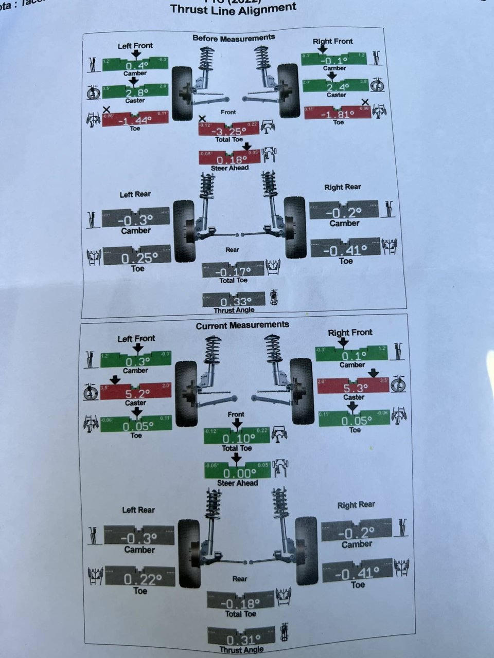

    Does your alignment sheet have SAI and/or included angle?

    this is all they gave me

    That’s too much caster for the factory wheel offset. You’re rubbing on the back side of the lca at full lock correct?

    Since your on factory wheels. Have them set caster at the 2.5-3* and I’m betting they don’t rub.

    the person doing the alignment went the wrong way with your caster
    you want + caster
    not - caster

    They did. They just went to far on postive. On the sheet thats 5.2 and 5.3 positive caster. Way to much for a factory offset wheel.

    damn im losing my vision, i swear there was a - in front of those numbers

    updating this:
    alignment is not the issue. alignment is perfefct.
    issue is teh " +" offset on the stock sport wheel. solved by replacing the stock wheel with -12 wheel offset with 285/70/17 tires.
