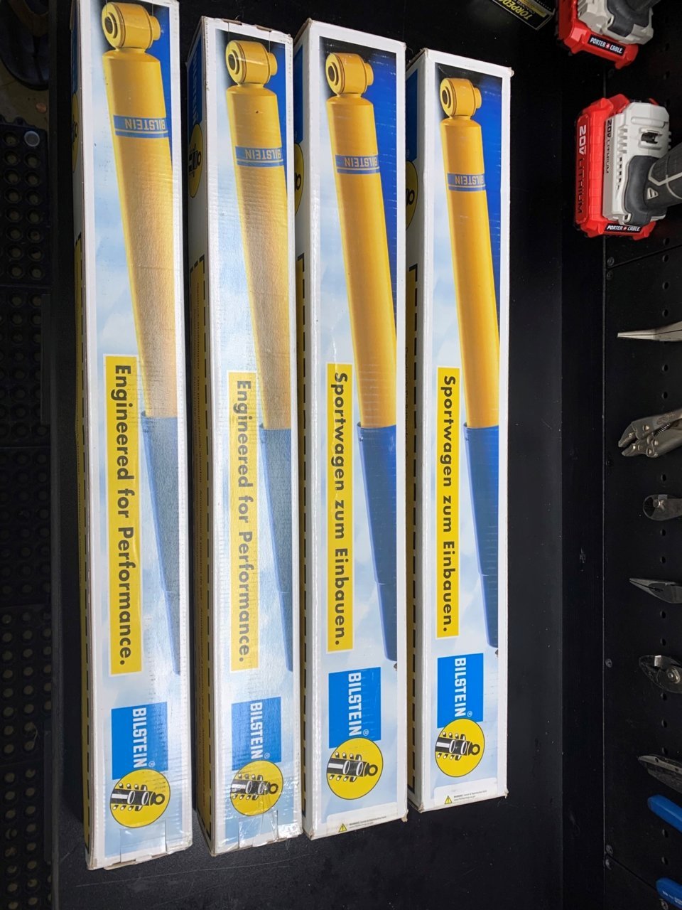

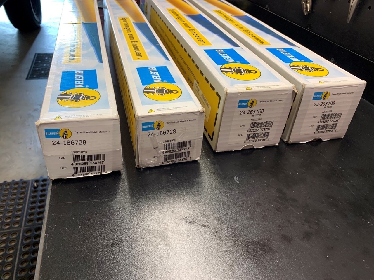

    I traded my 2016 Limited in on a 2020 TRD Pro and have a full set of 5100's still in the box that I purchased for the Limited and never used. If you still are looking for some 5100's I have some.

    What you looking to get for them?

    Already reached out to him via PM - got back to me in a few hours. FYI he sold them shortly after his post...no need to wait until 12/2022 haha
