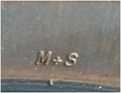

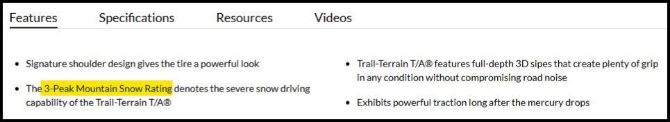

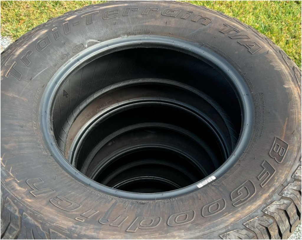

    I got my Toyo Open Country AT3 installed today. As I was looking at prices for them online, I noticed that the BFG Trail Terrain that Canadian Tire sells are 3 Peak Mountain Snowflake rated BFGoodrich Trail-Terrain T/A Tire for All Terrain Truck & SUV | Canadian Tire
    When I was taking pictures of the tires to list them for sale, I can't find the 3PMSF logo on them, just M+S
    So, not all Trail Terrain tires created equal by the looks of it.

    Thats right they are Toyota specific OEM versions. They are also about 5 lbs lighter than real Trail Terrains. Ford has an OEM verison of wildpeaks on the maverick that have less tread that the retail versions soo.

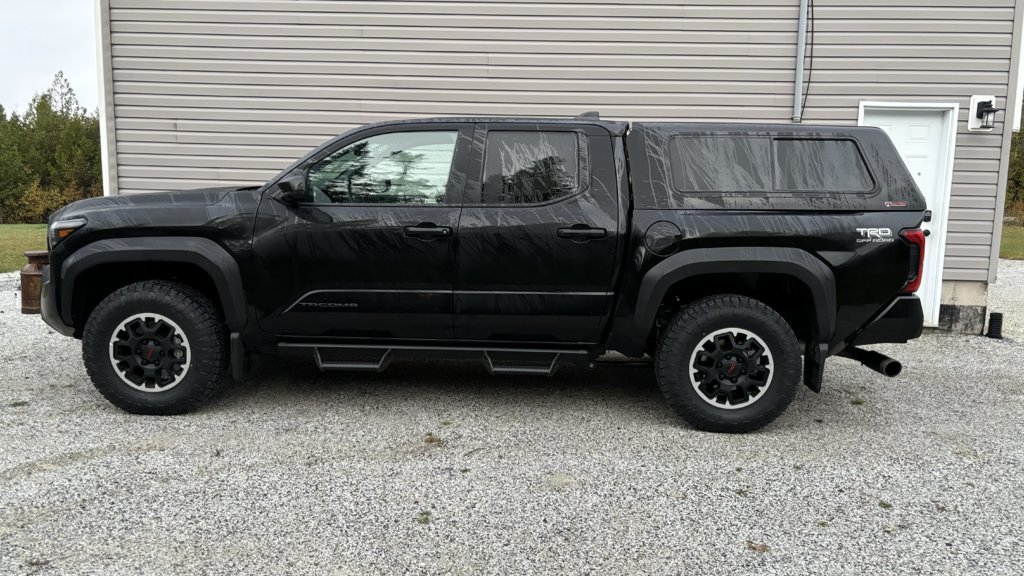

    well lets see them open country's!

    Trail terrain and all terrain tires are different. The AT ko2s have the 3 peak the trail terrain do not

    Went with LT255/75R17 6C. I wanted the 80s for the size, but didn’t want the harsh drive of the 10E.
    The 75s are harsher than stock, but not by much. Less body roll too.

    I know they are different, just pointing out that’s it’s common to have some models vehicle specific.
    Edit to add, the Trail Terrain at Canadian Tire have the 3 peak.
