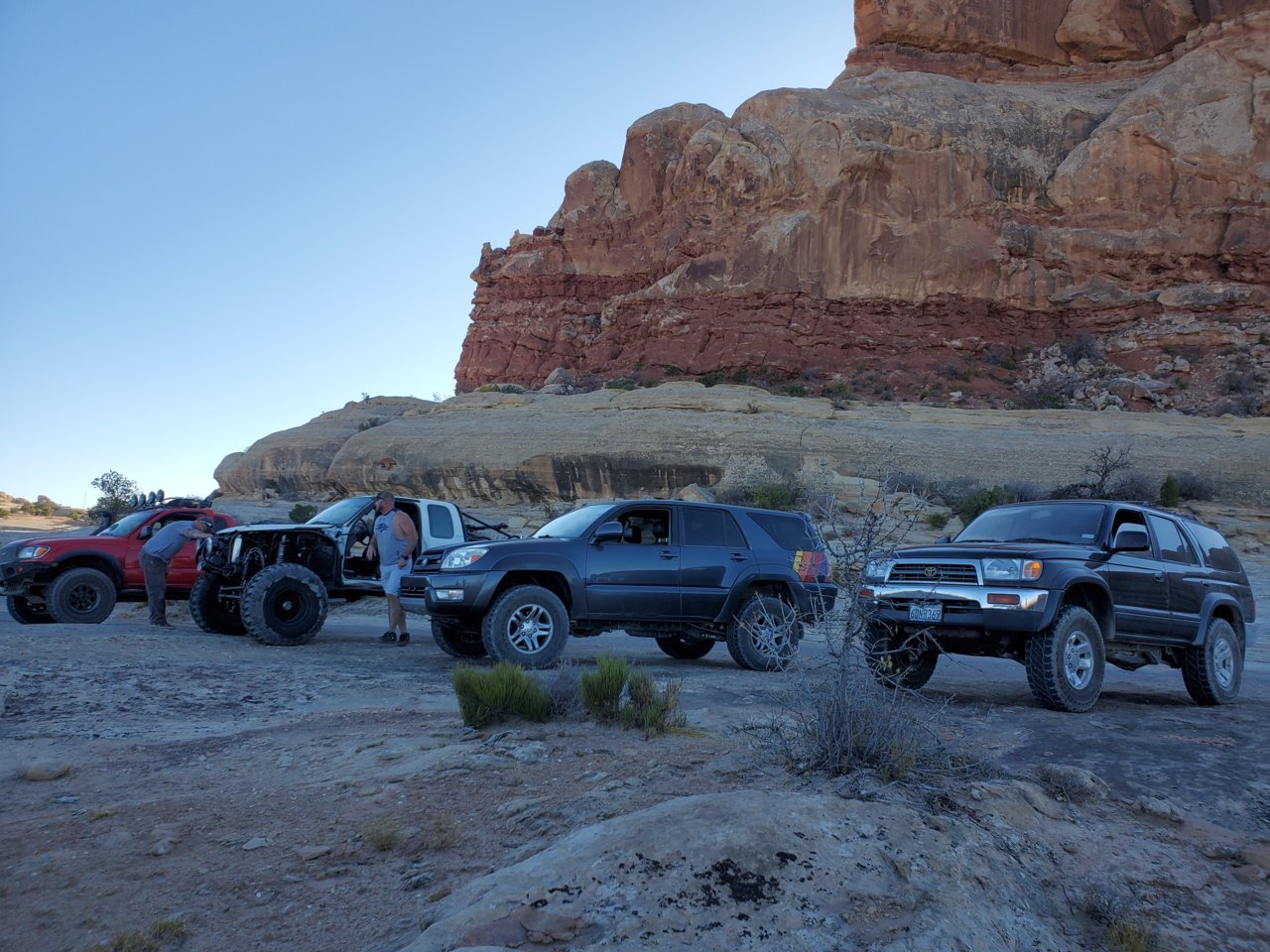

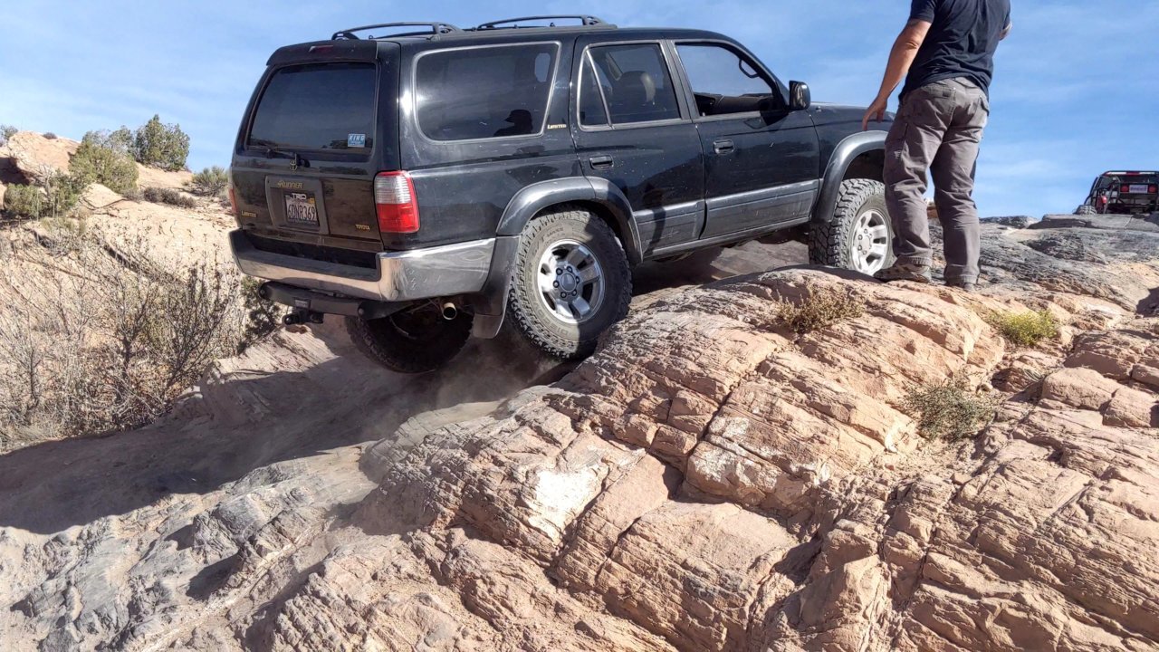

    Plenty have bypasses as mentioned.
    It's better to look at the many trails available, and create an itinerary for your trip out there.
    This way you know what to expect because you've already chosen said trails beforehand, and know whether said trail offers a bypass or not.
    You don't want to head out there uninformed; that'd be really dumb.
    This book was useful before me and my friends went on a weekend long trip to wheel out there - Guide to Moab, UT Backroads & 4-Wheel-Drive Trails 3rd Edition: Charles Wells, Shelly Mayer: 9781934838259: Amazon.com: Books
    Both 4Runners were nearly stock; one of them was mine (3G).
