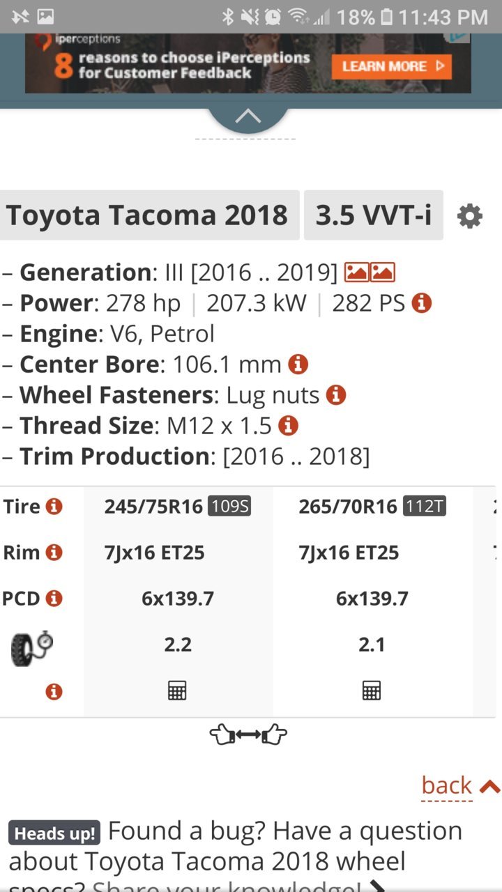

    I tried searching, but I can't find anything... Does anyone know the specs of the stock 2017 TRD OR Wheels?
    Thanks.

    Anyone know what the backspacing is on them?

    You know the wheel width and offset. Basic math. Divide rim width by 2, add the offset (+25mm in this case)

    Is it safe to say that the 2017 TRD OR wheel has basically the same dimensions as the 2017 stock steel wheel? From what I can tell, they are both 16x7, +25MM (although I've seen different values for the steel wheel), 5" backspacing.

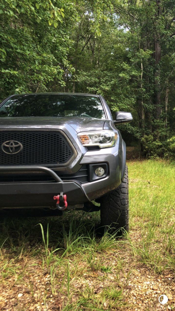

    This is 0 offset. I don’t have mud flaps, but I don’t think they would hit.
