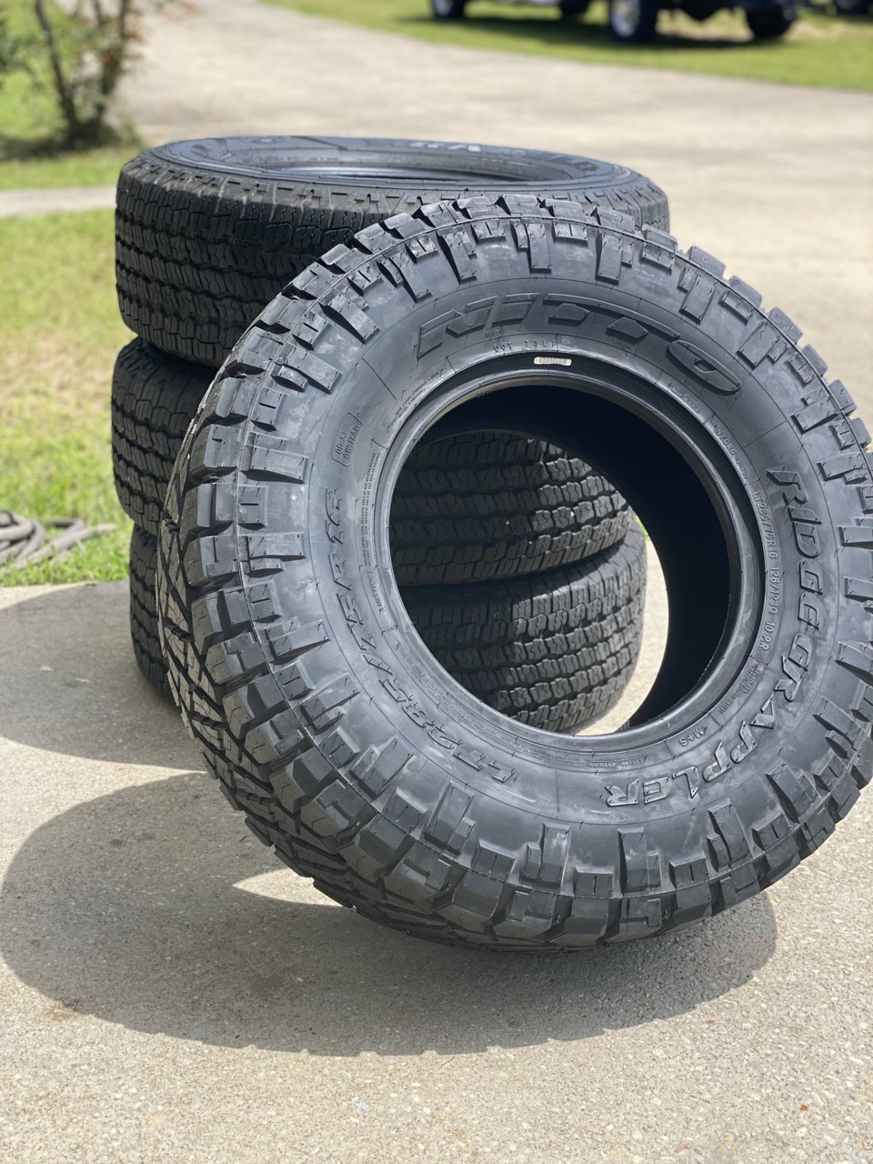

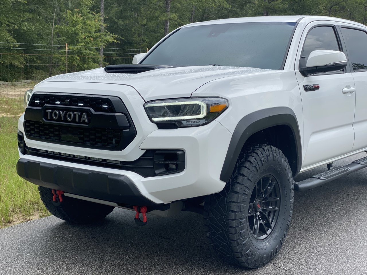

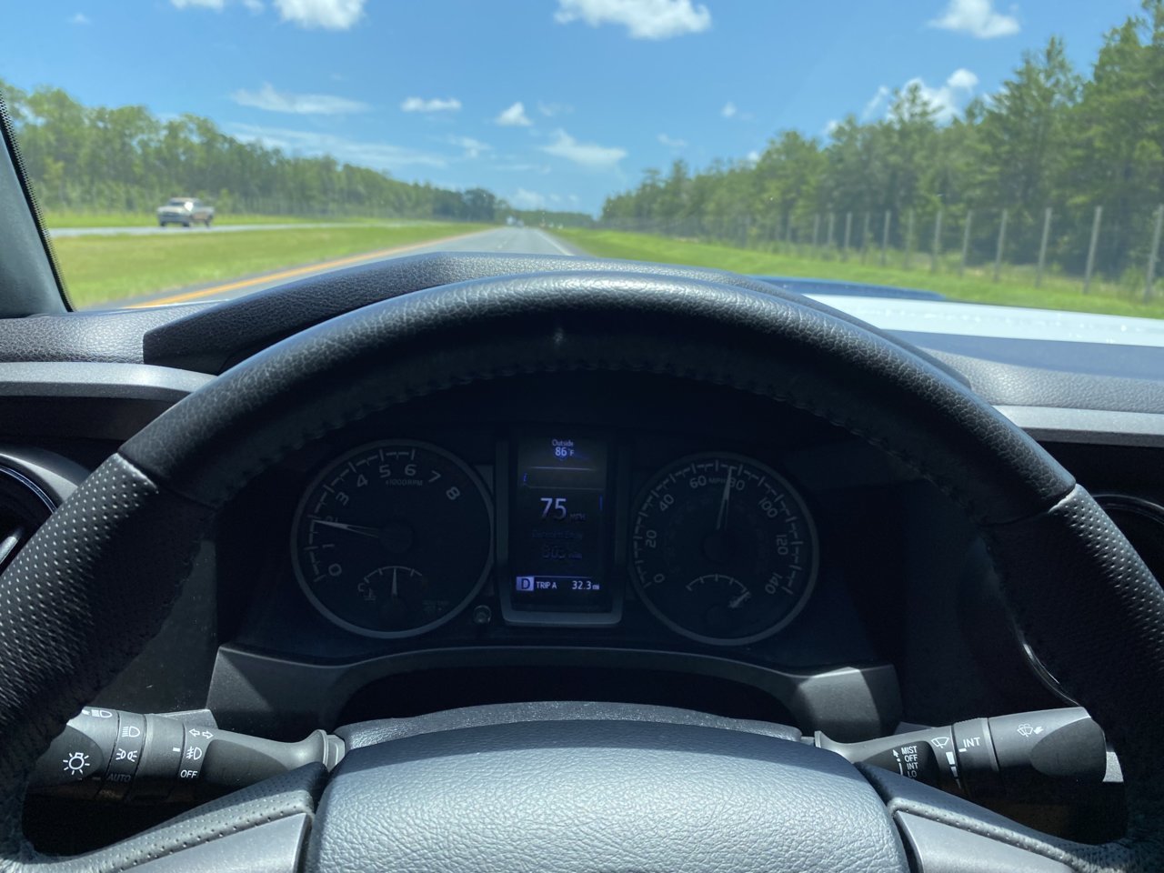

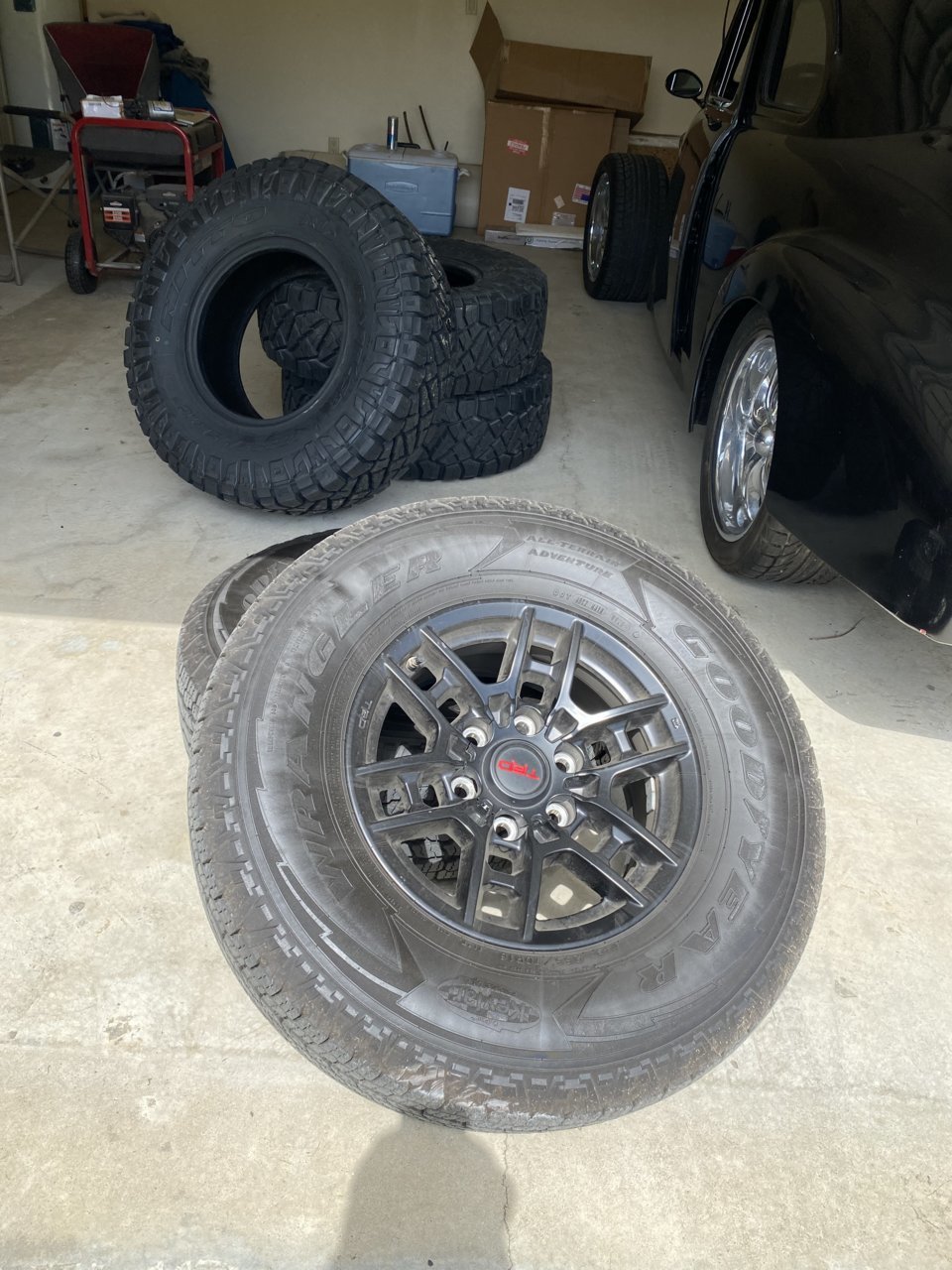

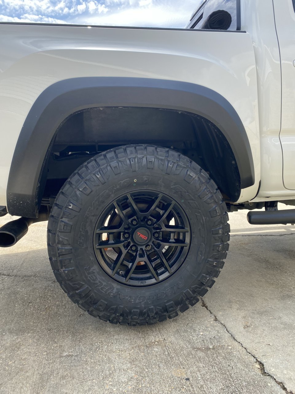

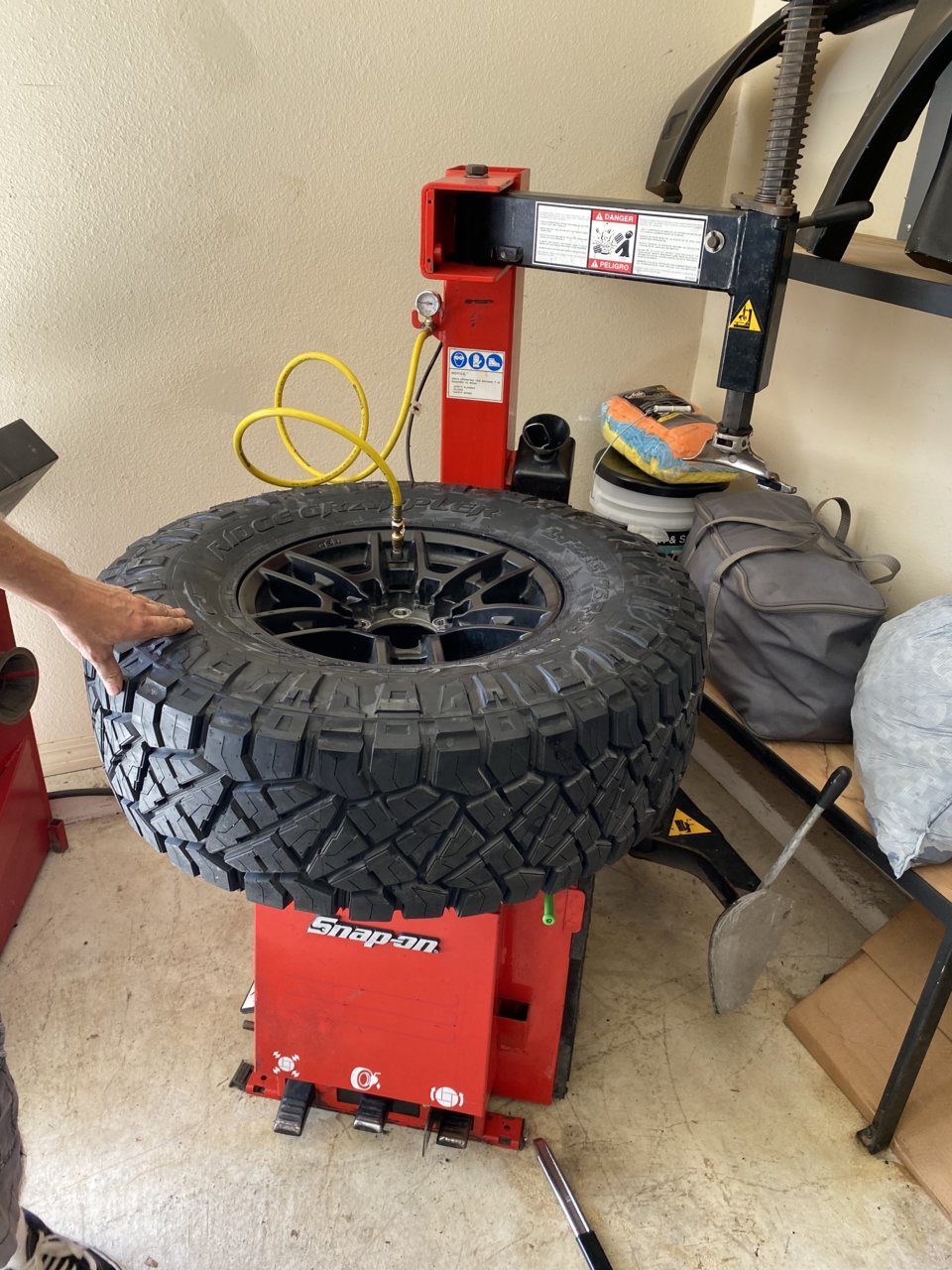

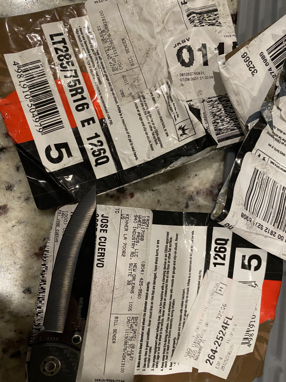

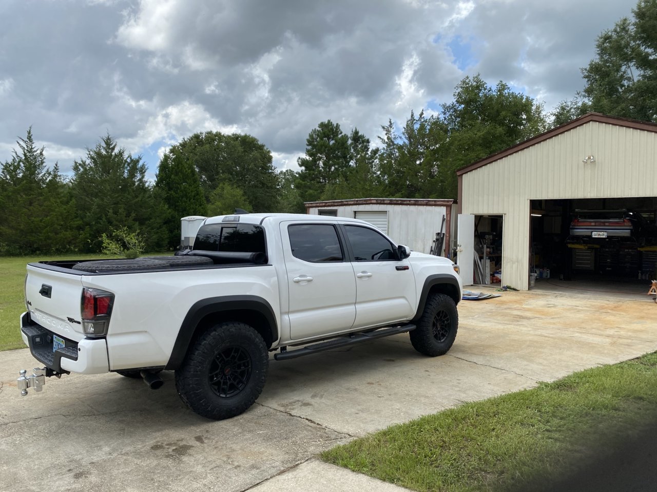

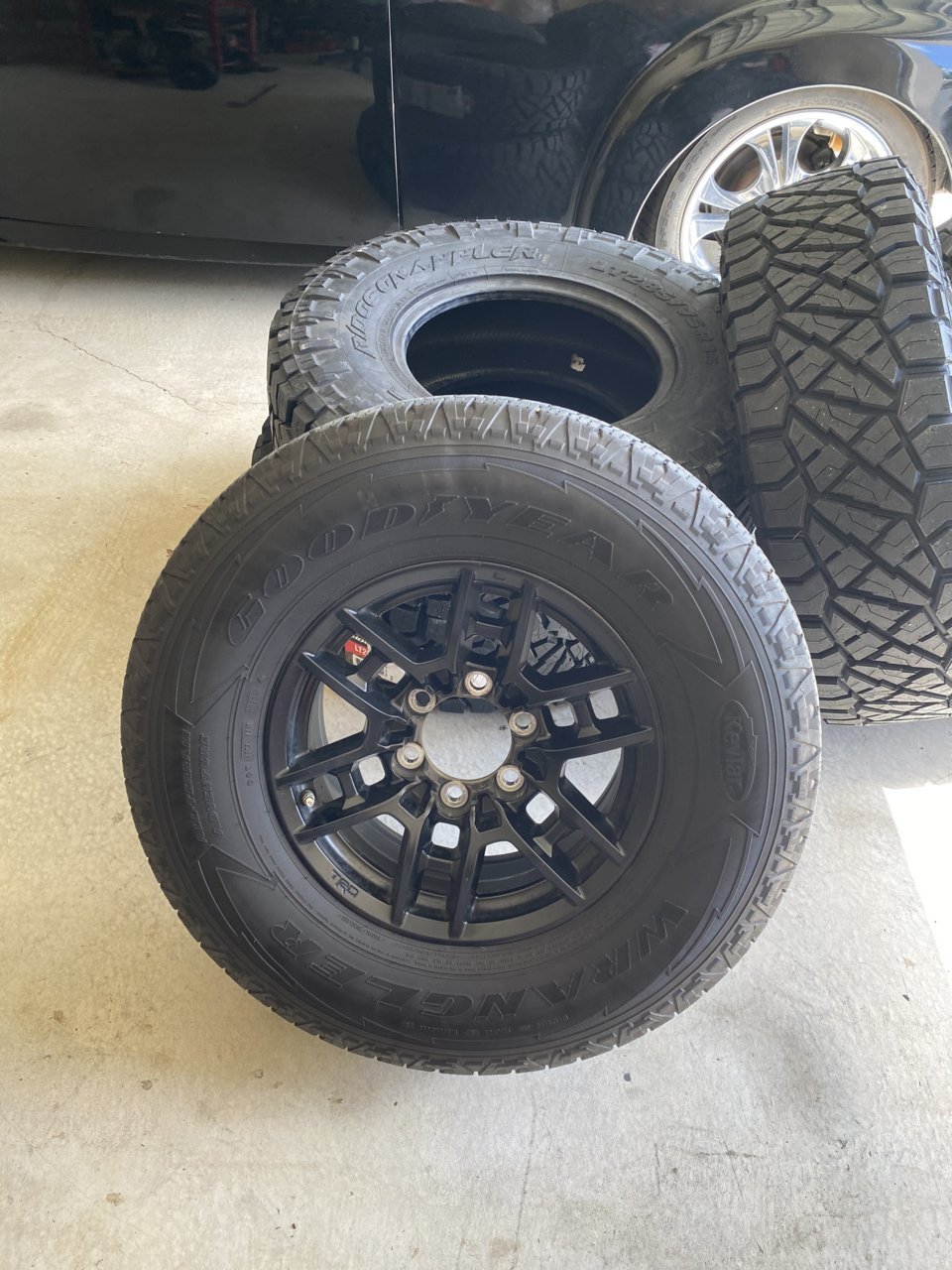

    E92B3A3A-2BF1-4A57-A284-8A7911FA78D1.jpg BB61890A-F2DC-4ABA-ADCD-8C6FF68C4176.jpg 338A7224-4FB2-4FB7-A08C-2A656045C382.jpg D008D319-EDDB-45E5-B293-7A5C737B6C60.jpg 2CAD8667-E603-44C1-ADA2-D3432B010D4C.jpg 13E3FDC3-A32A-47B4-A84C-2FF0F1D68D26.jpg 7F32CD98-9458-432B-B85D-D90F50241159.jpg 00D31B60-7711-4FF3-B98F-742405BAA64C.jpg 547ACB53-A84C-4325-8A78-C8B2D113C4EF.jpg CF4A01D8-0285-425A-ADBF-D2DC2DE47925.jpg Just installed 285/75/16 Nitto Ridge Grapplers on my stock 2020 TRD Pro with ZERO issues. Aired to 35 psi, about 4.5ish mph off, 75 on the dash and 80 on GPS. Smooth, very quiet and civil on the road. I’ve driven truck with Trail Grapplers and this is night and day difference. Drives straight, no wandering and drove it on the wet road with proper traction. No rubbing UCA or fenders anywhere although I have only been on flat surfaces and in and out of driveways. Able to mount and balance at a friends house where he has all the machines, 2 tires took 1 ounce each, .75 ounce and one took a couple of ounces. You’d never know you were on these more aggressive tires. They look amazing and I can’t wait to take them off road and really put them to use. Of course my friend thought it would be funny to put my caller ID name on the shipping labels, he always does that to me - lol. Can’t complain cause I get a great deal on all Nitto tires. Will get more pictures after a wash and detail but I am one happy camper now

    Super happy with the fitment, look, non-existent road noise and ease of installation. I was nervous for the longest time about the probability of rubbing but now I am stress free. I only wish I pulled the trigger sooner, but as far as the loss of initial get-up and go, I have not felt anything noticeable or annoying. Again I am not doing drag launches at every stop light and stop sign but the initial acceleration feels good still, I mean still underpowered but not any worse.

    Truck looks amazing! Nicely done. Side note; dope NSX on the lift too.
