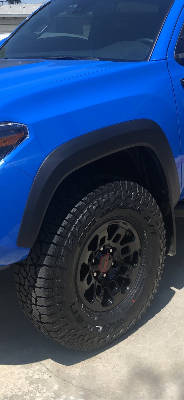

    how you liking the wildpeaks? Pics please! They are on top of my list right now due to the good reviews and the $100s less then KO2s

    The ride is good, not loud and they look good. I wish they had a little more aggressive sidewalls, but it would probably make them louder.

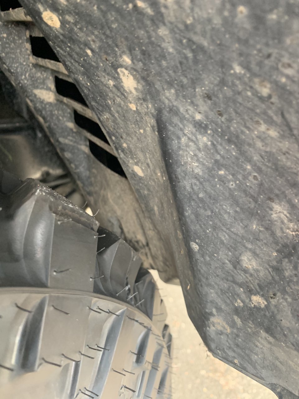

    I wouldn’t say they rub like crazy. They don’t rub at all driving around town. The Trail Grappler is a really blocky tire so that doesn’t do it any favors. I will likely be doing a lift in the future because one of my favorite things to do in the truck is “high speed” running of dirt roads and that would certainly cause more severe rubbing.
    To me, the way they look (and perform) is worth the slight headache.

    Yeah the Nitto’s are quite blocky in their design. It is a mud terrain tire.

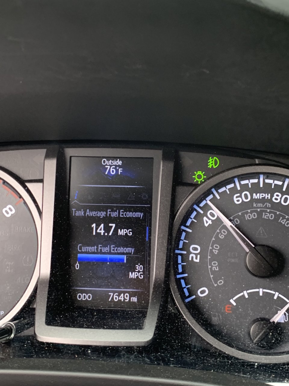

    Im very happy with the drivability of the truck with these tires. The noise is hardly noticeable, But you are not joking about the fuel consumption. Wasn’t exactly a green vehicle before (16-17)mpg with the manual. Now i’m getting 14.5 if i’m lucky

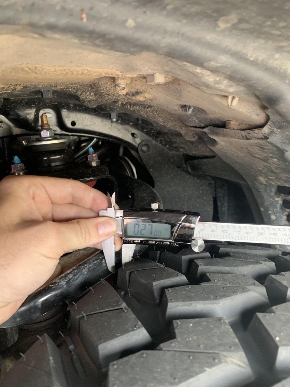

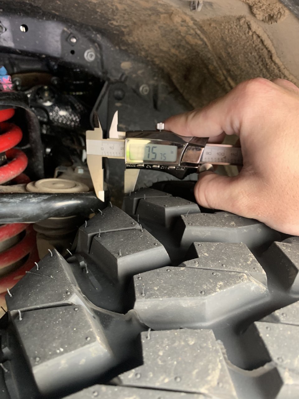

    Here are some more pictures of the Nitto Trail Grapplers. This is my first “off-road” vehicle so i’m not an expert on how close things should be but common sense tells me that my UCA will be a problem on rough stuff. The pictures with the vernier calipers are at full lock.

    Any more updates? I’m getting serious about upgrading tires, so have been looking at mine closing and don’t see how I could fit 285/75 or even 255/85s without cutting the rear side of the body..maybe w/ an adjustable UCA, but that’s more $$ I don’t want to spend right now...

    Honestly, I rub every time in reverse when i have passengers. Its rubbing on the fender well. It’s not so bad that i need to do something about it right away. I have no issues in the rear at all. I haven’t rubbed on the UCA but I haven’t done any serious off-roading yet.

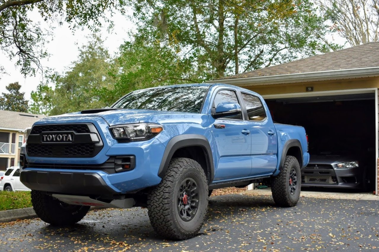

    Anyone have any issues running 285/75r16 on the TRD PRO wheels? I know most of the tires that size spec at minimum a 7.5 rim and the TRD PROs are 7

    Depends on the tire brand and your alignment, but with my KO2's I rub very slightly on the UCA when reversing at full lock, which doesn't occur enough for me to care. The looks are worth it to me:
