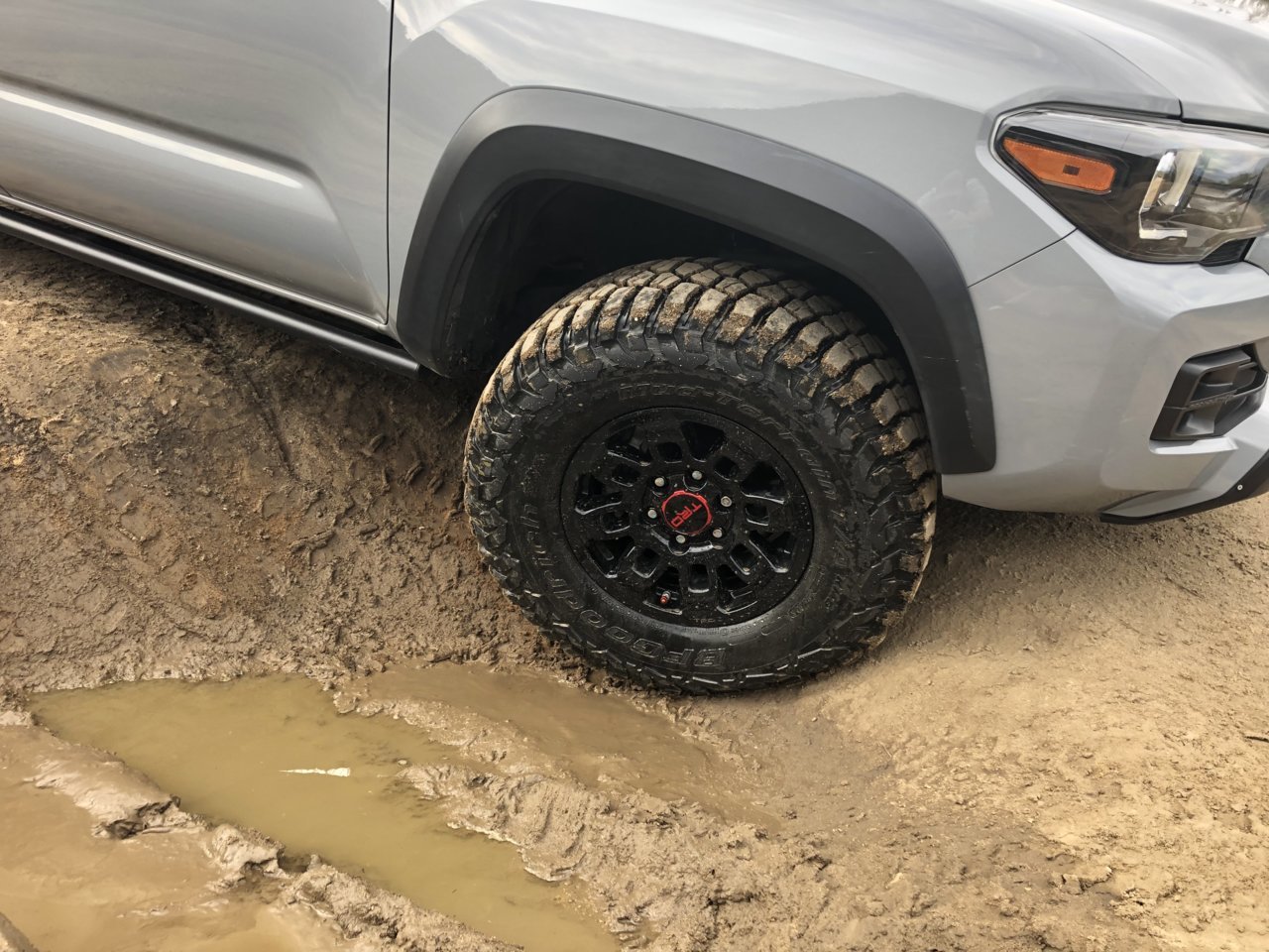

    285/75/16 KM3’s. Cali Raised rock sliders Revtek 427AP lift kit Victory 4x4 Strike bumpers Warn VR8S winch
    9A2B10E1-D992-49CA-82DD-4609DFF2E87E.jpg 285/75/16 KM3s stock pro wheels and suspension no rub.

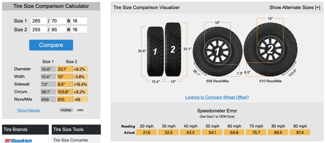

    Has anyone run or thought about running 255/85R16 on the TRD wheels on a stock TRDPRO? They'd actually be a little bit more narrow than 265/70, 10" vs 10.4", but it'd definitely clear the UCAs. And you'd get a 33.1" diameter. I've my Tacoma for almost a whole week now so I feel it's past time I started messing up a perfectly good stock truck. I do not, however, want deal with any rubbing or modifications, did way too much of that getting 35"s to fit under my 3rd gen 4runner.

    Theres a skinny tire thread around here somewhere

    N8Dizzle
    N8Dizzle Well-Known Member
    Apr 12, 2011
    #54777
    101
    Nate
    Sumner
    2020 AG TRD PRO MT
    Cooper S/T Maxx 255/85/16

    Awesome! Thanks for sharing!

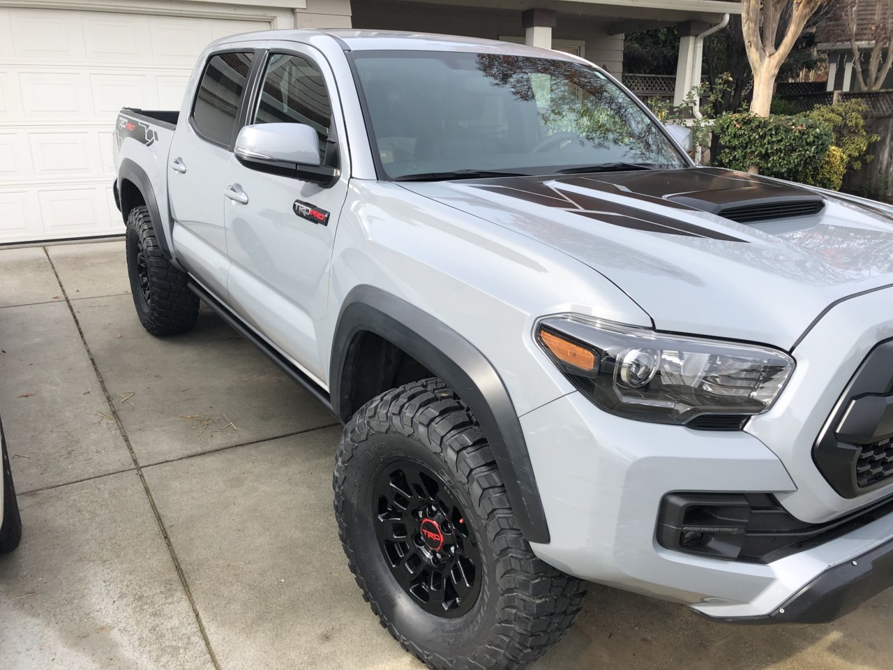

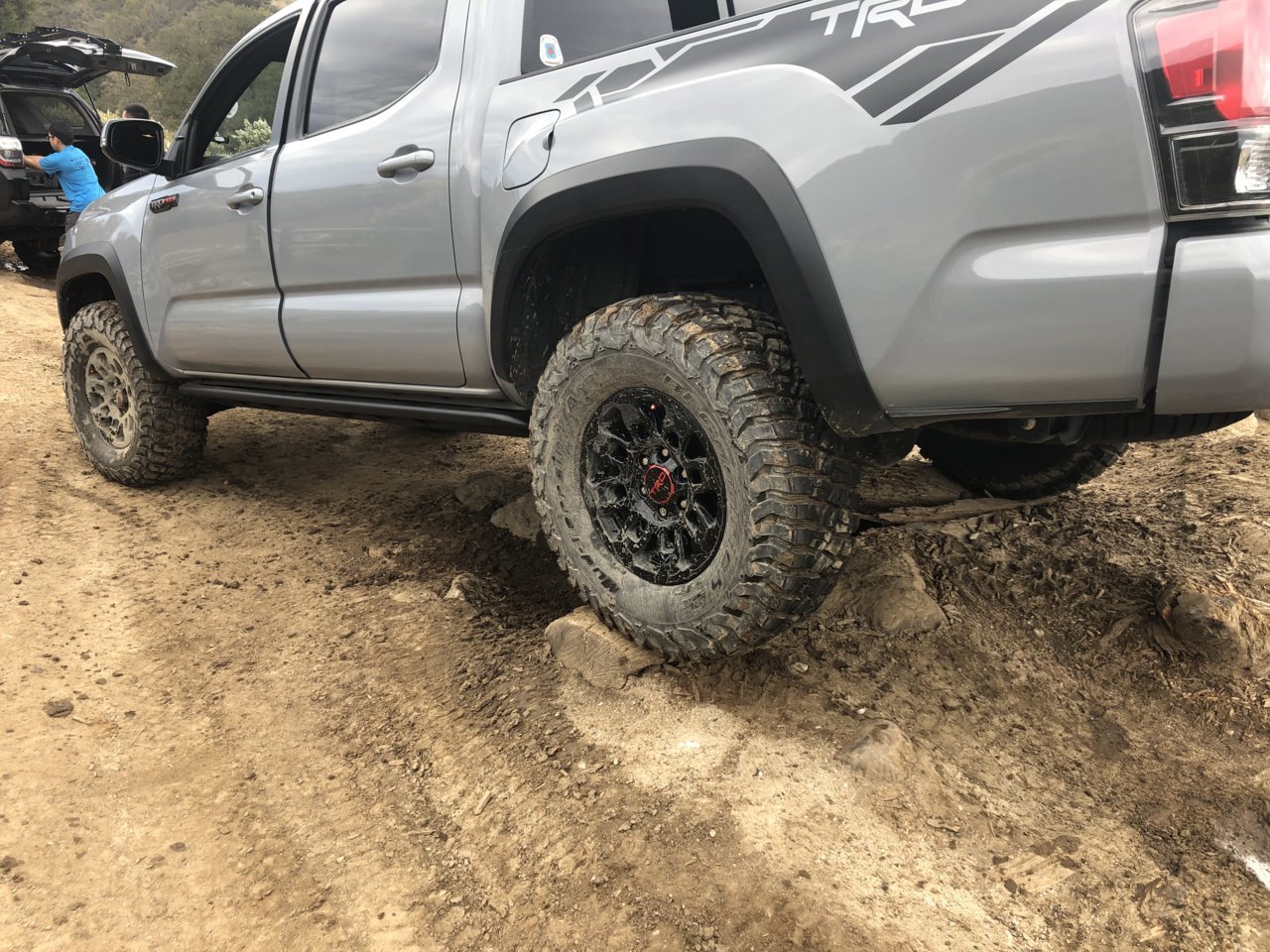

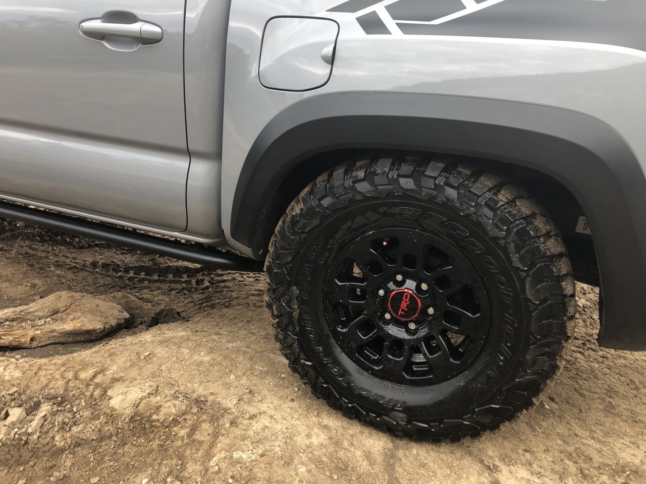

    2017 Tacoma TRD PRO
    F2EE6114-91C7-4C5E-B0E5-D9A527A27CF5.jpg 777EA4E6-BB62-43EF-9559-C34DF23A68F8.jpg F8546EA0-70DA-48E6-8722-1D3BF5C4AE2F.jpg
    These are old, truck has changed some no rub. Happy trails

    Who makes your low profile slider? Nice looking truck!

    they are NFAB they are for sale if you want, they bolt to the rocker panel, I now have Cali raised that bolt to the frame same profile with kick out.

    do you get any rubbing full lock reversing?

    Once with 5 adults in the truck. I wheel all the time no rub.
