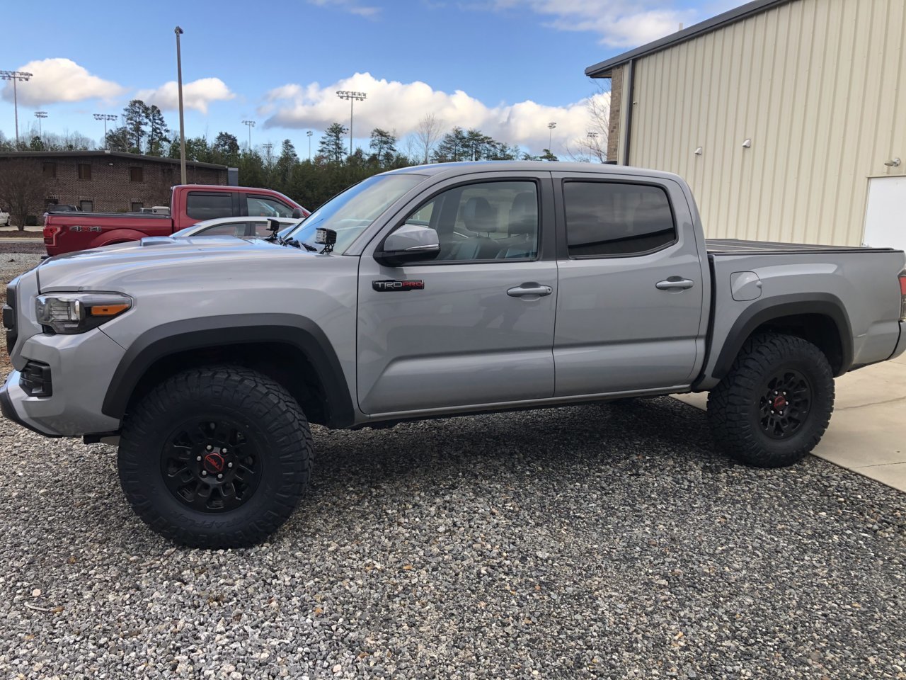

    IMG_0107[520].jpg After reading this thread i pulled the trigger and went with 285/75/16 Nitto Ridge grapplers. I am happy to say I have not had any rubbing issues at all.

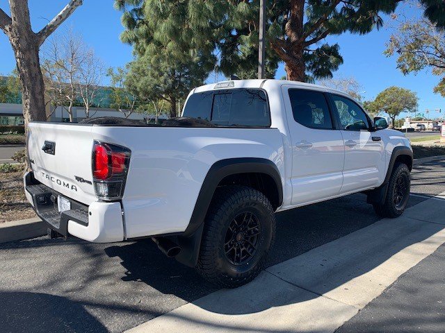

    just installed Falken Wildpeak A/T 285/75/16 on my stock 2020 TRD Pro and rims with OEM mud flaps and NO rubbing as of yet since i've only done city driving. Will update once i do some wheeling. I do now have a set of Goodyear Wrangler 265/70/16 for sale with only 527 miles on them. I also can't really tell the difference of ride quality until I get a few more miles on them.
