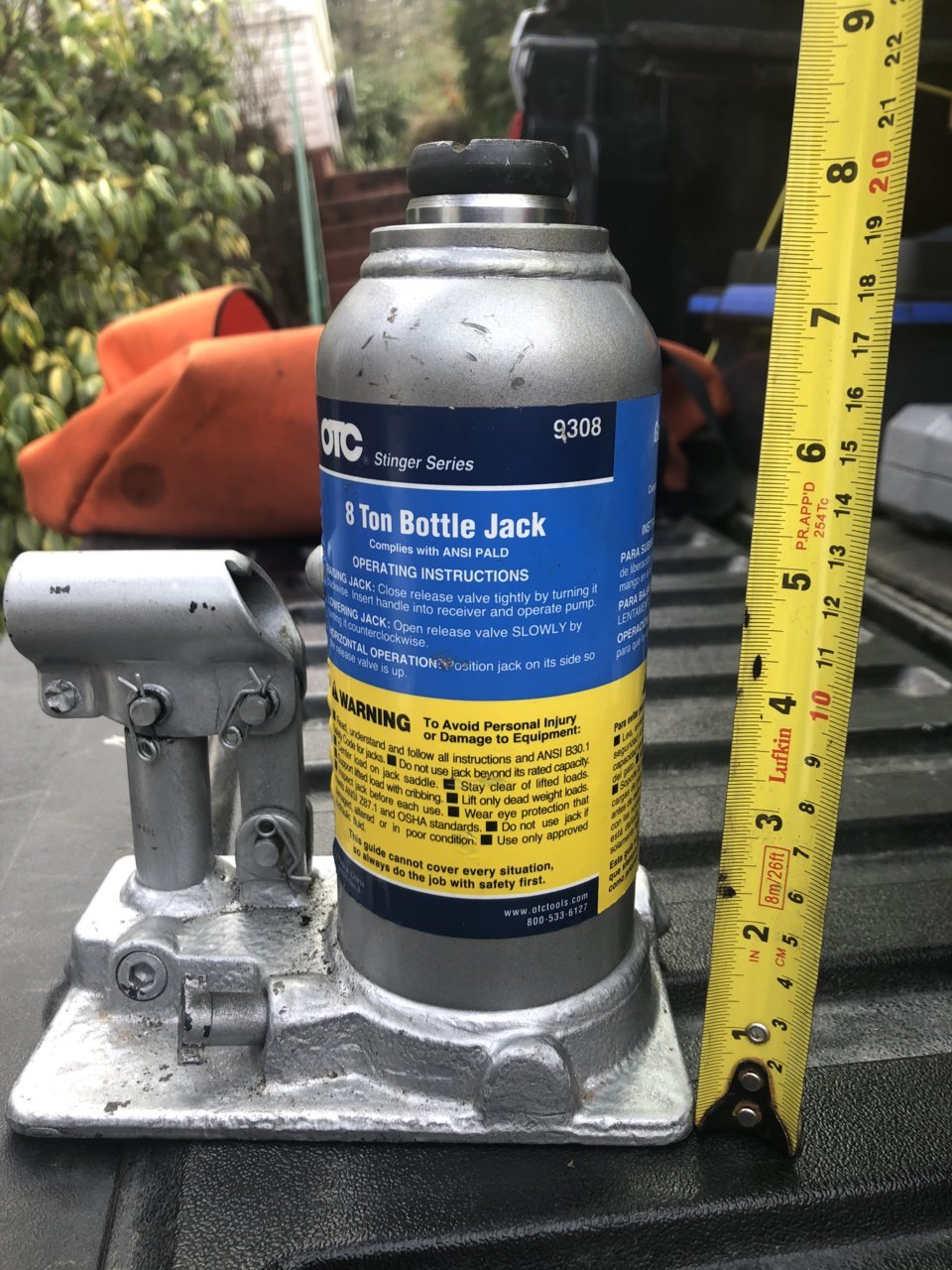

    Will that jack go under the axle if the tire was flat? Minimum height 7-13/16 inches it should I'm guessing.

    I will check in a few minutes and let you know

    Seems like if you were literally on the rim, it would be about about an inch too tall, on hard, level ground. IDK how muck a tire on the rim would push the situation upward.
    @Stocklocker to double check the measurements.

    If I ever have a flat it will be on either asphalt or concrete. I think the stock jack would fit my needs. But since I bought a torque wrench I would not mind rotating my own tires so another jack would be handy. Like to have a pair of these, https://www.amazon.com/dp/B00GJJZ5YC

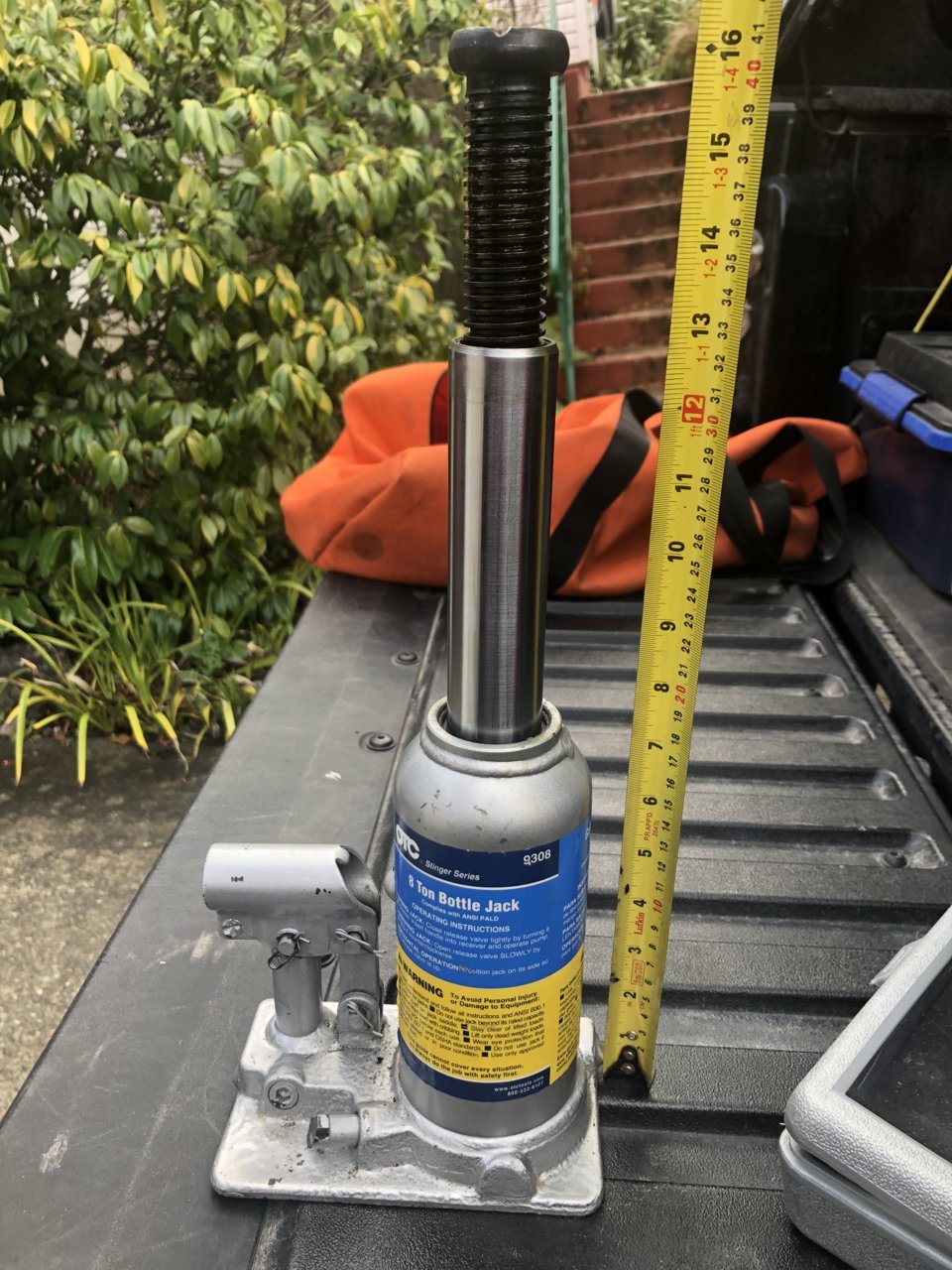

    So I checked and yes. If the tire was torn right off the 16” rim you could still get the jack under on dry pavement. 17” rims would give you another 1/2” of clearance on a completely shorn tire. It’s max extension is 16”, with the threaded extension, so for tire changes on pavement etc you do not need a wood block. On rough terrain it might help to have a block

    Then I would think a guy could get this jack/stand under the axle with a flat then. Judging by the pictures @Stocklocker posted with the steel tape, (13-1/2" from the ground to the bottom of the axle.) Lowest it will go is 8-5/8 inch. Ground is wet right now or I would slip out there and measure from the ground up to the wheel the you could minus a inch or 2 off that total. I'm thinking this jack will go under the axle with a flat though.

    I just remeasured, carefully, and my axle is exactly 12 1/2" off the ground, on 17 inch wheels running 265/65 Nittos.

    The hydraulic portion has a flat top, no cup for the axle so not very secure.
