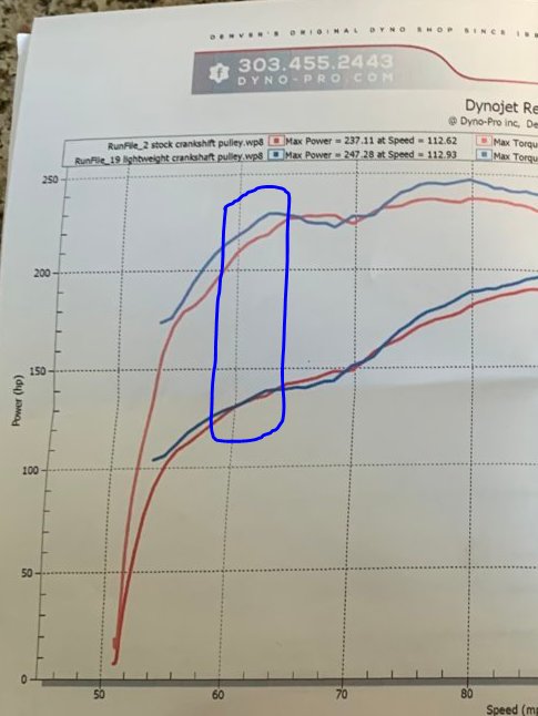

    Something is up riiiight here:
    Why is there a cross in torque but not HP at the same RPMs
    Edit: nvm, the axis is mph. Must be a transmission thing, but still weird
