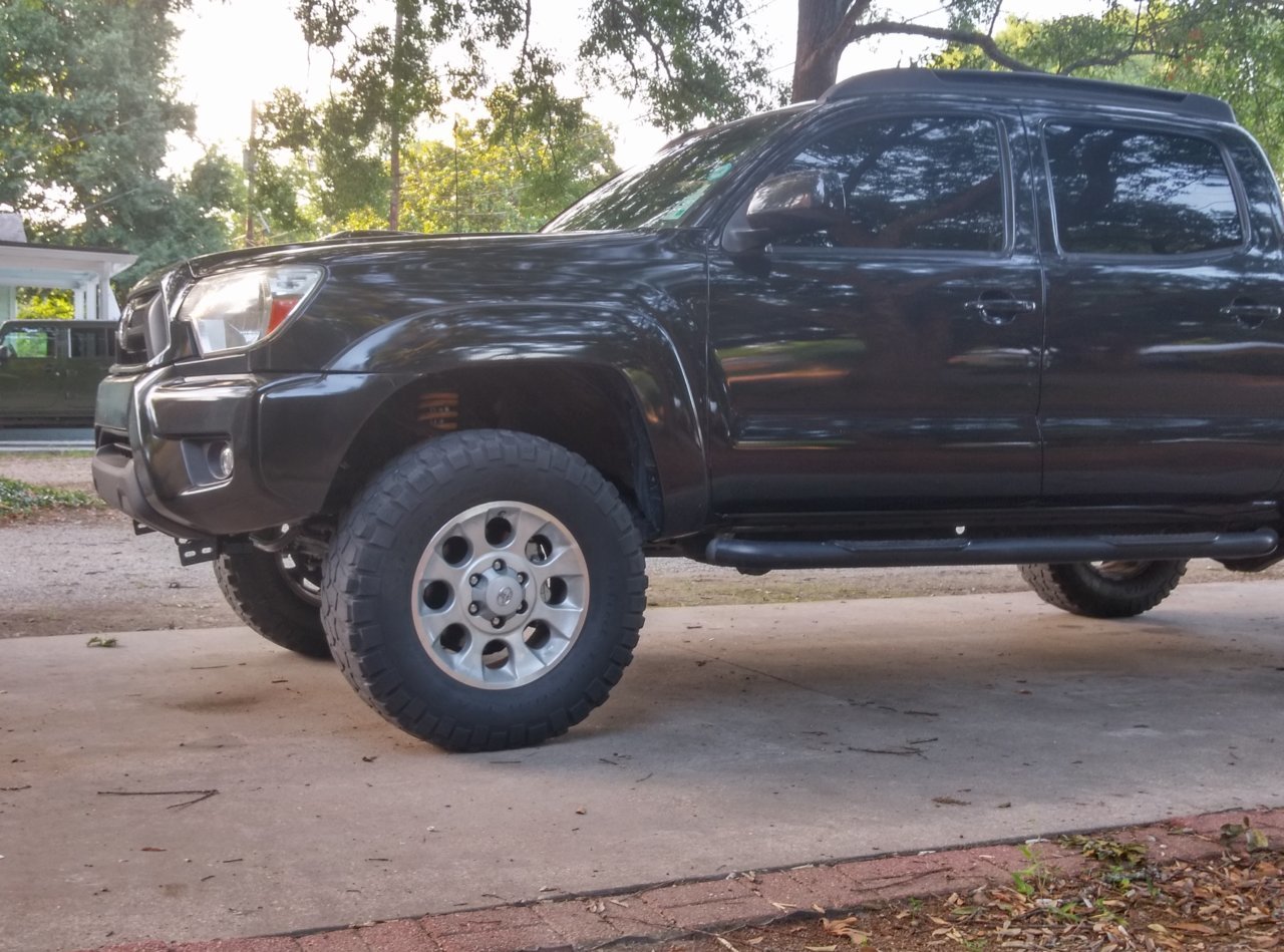

    With a TRUE 3" lift, 285/70/17 will fit with wheel spacers, they won't rub on UCA's. Mud flaps will have to go! I Ran 285/70/17 with Toyota Trail Team OEM wheels that have an additional 15mm offset with no problems rubbing on UCA.

    I had to dig this pic up, Lol! but real world, 3" TOYO50C 800lb springs, Iron Man ext. travel struts, Toyota Trail Team Ed. 15mm wheels, 285/70/17 BFG KM2's.

    No chop here. Yes, had to trim liner and lose flaps, but no mount chop.

    I had the same thought pattern, that's why I went with the FJ Trail Team wheels, as close to OEM as I could find that would work. I just gave those KM2'S in the pic to a friend, still have the wheels, if your around Louisiana you can try them out if you like them I'll make a deal for them, if not, no biggy.
