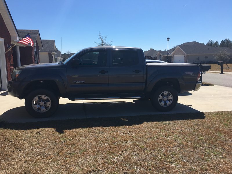

    3 inch lift. 285/70
    This is the rc 3 inch with coil spacers. On stock wheels 265/70/16

    Zredwards, is it just me or is your truck sitting a bit nose high?
  10. Mar 19, 2017 at 11:47 AM
    Zredwards
    Zredwards Well-Known Member
    Mar 12, 2017
    #213059
    70
    Zach
    Ludowici GA
    2011 Toyota Tacoma Trd
    3 inch lift. 285/70
    Like higher in the front?

    Yes. That is something that I worry about when I get my lift considering it's the same brand. Although I am going to get the kit with the lifted struts instead of the spacers.
  12. Mar 19, 2017 at 1:27 PM
    Zredwards
    3 inch lift. 285/70
    Yeah understand I prefer a higher front anyways since I'm bout to wrap that around 33's but it also could just be my driveway

    Paris, TN
    15 TRD Sport 4x4
    I gotcha. My truck looks all wonky depending on how and where I'm parked even with the stock suspension.
